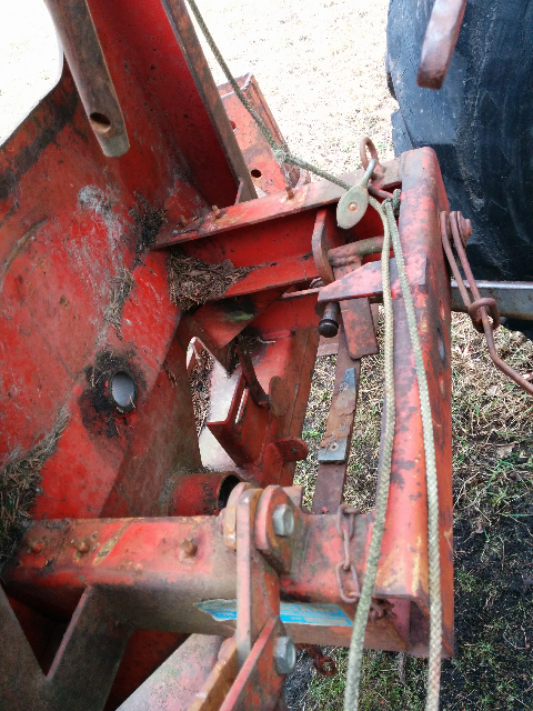

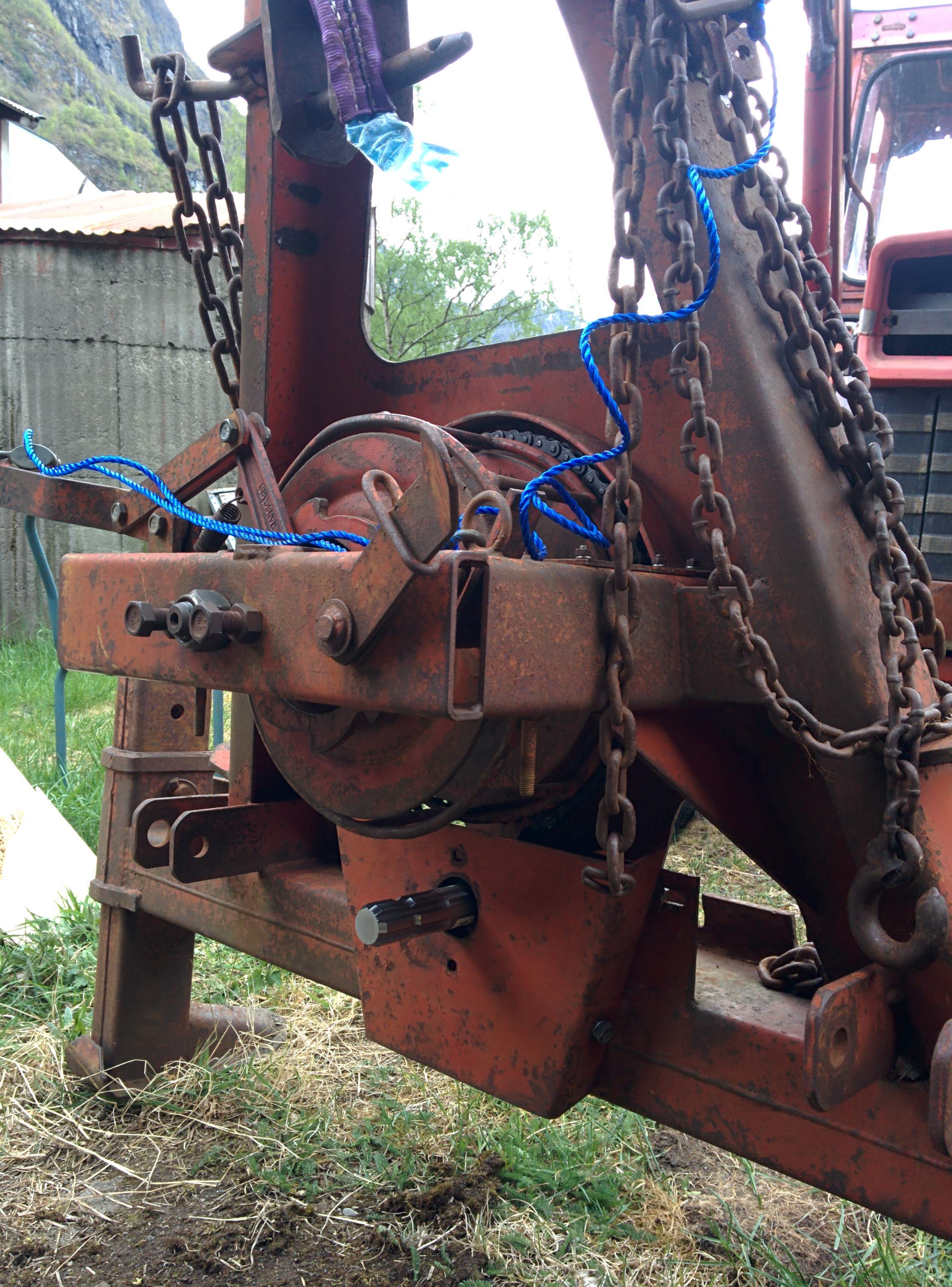

Yes, it has been left in the woods for 10 to 15 years after the axle broke off.
I am very happy over the fact that nothing is stuck og rusted solid.
Not a single bolt has broken and no heating or violence to take it apart.
   / Logging winch repair/restore project
#12
The winch is a Fransgard V3000 1982, 3000kg pulling capacity.

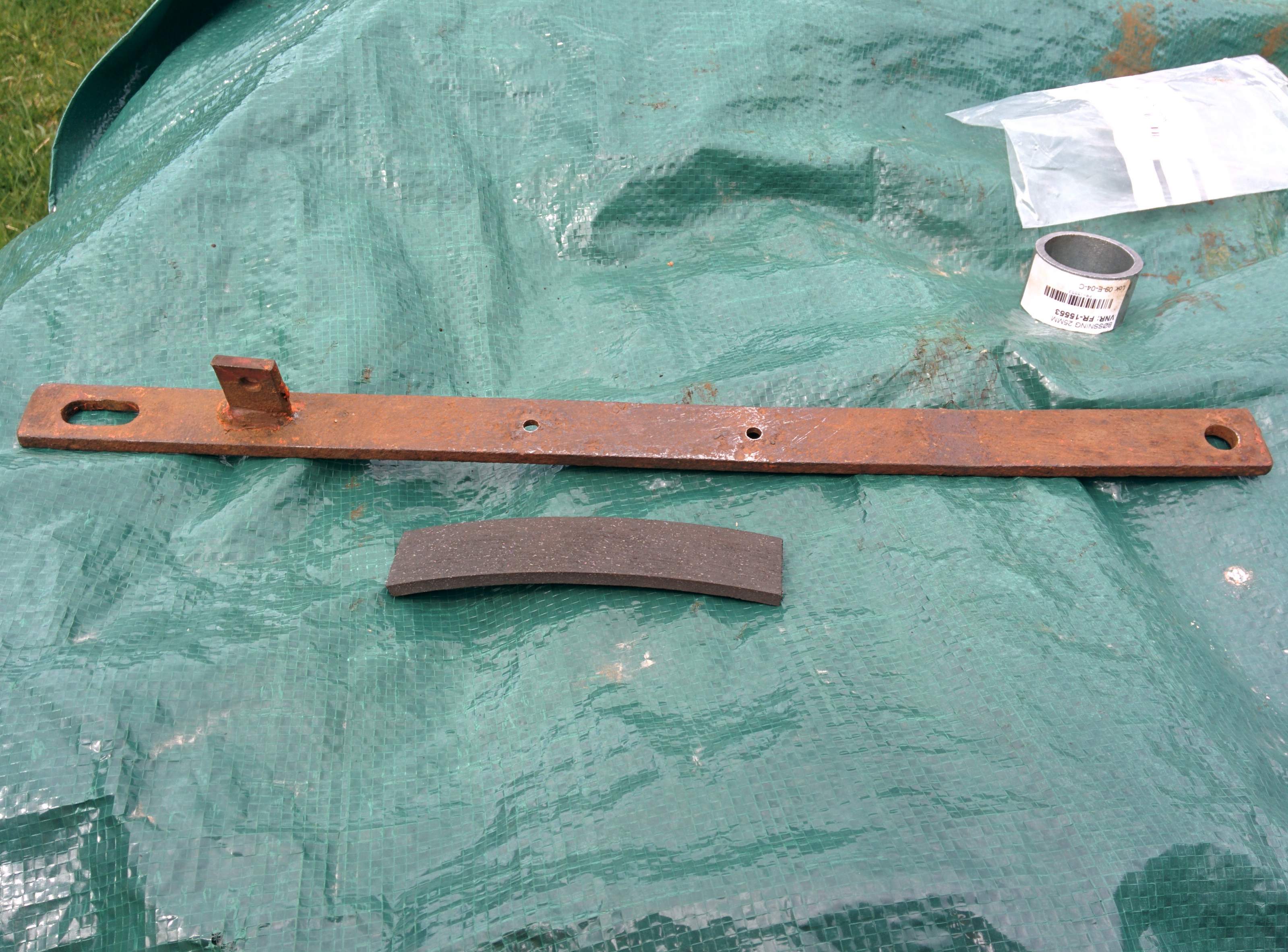

#13
Worn brake

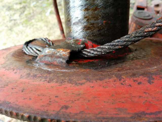

#14

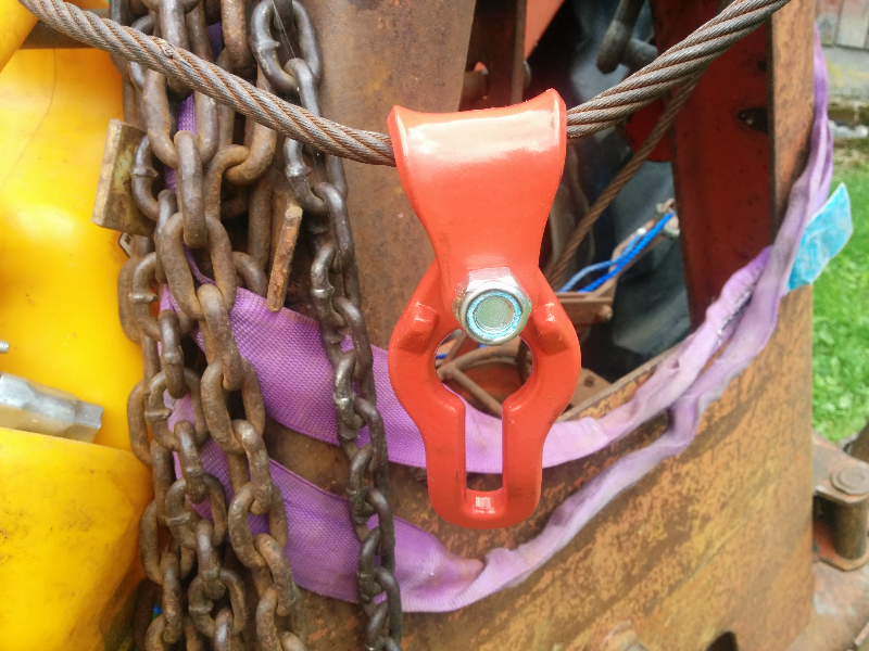

Wire lock on the drum

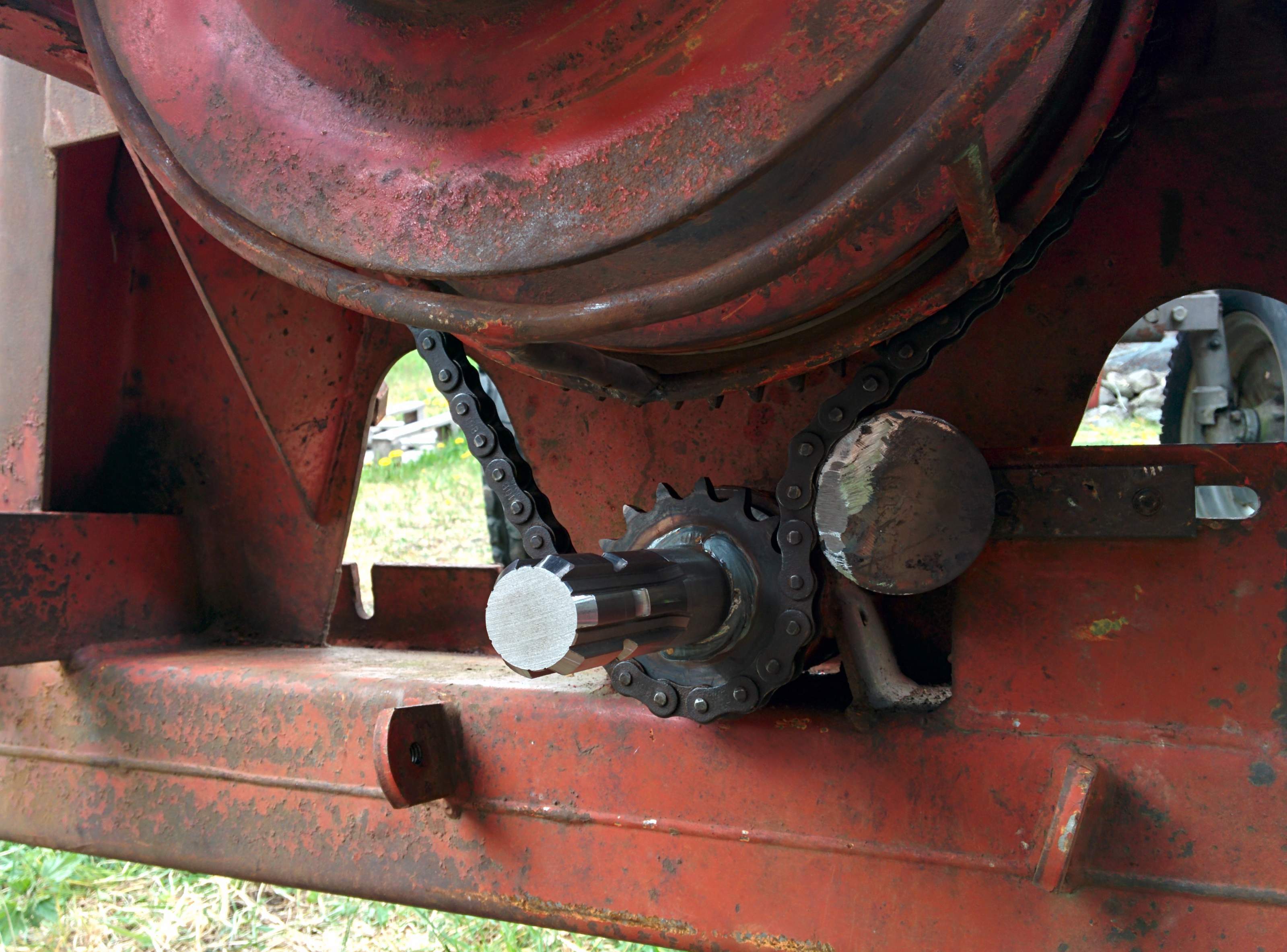

#15
Repairing the chain tensioner on my Sandvik/Norse 3081

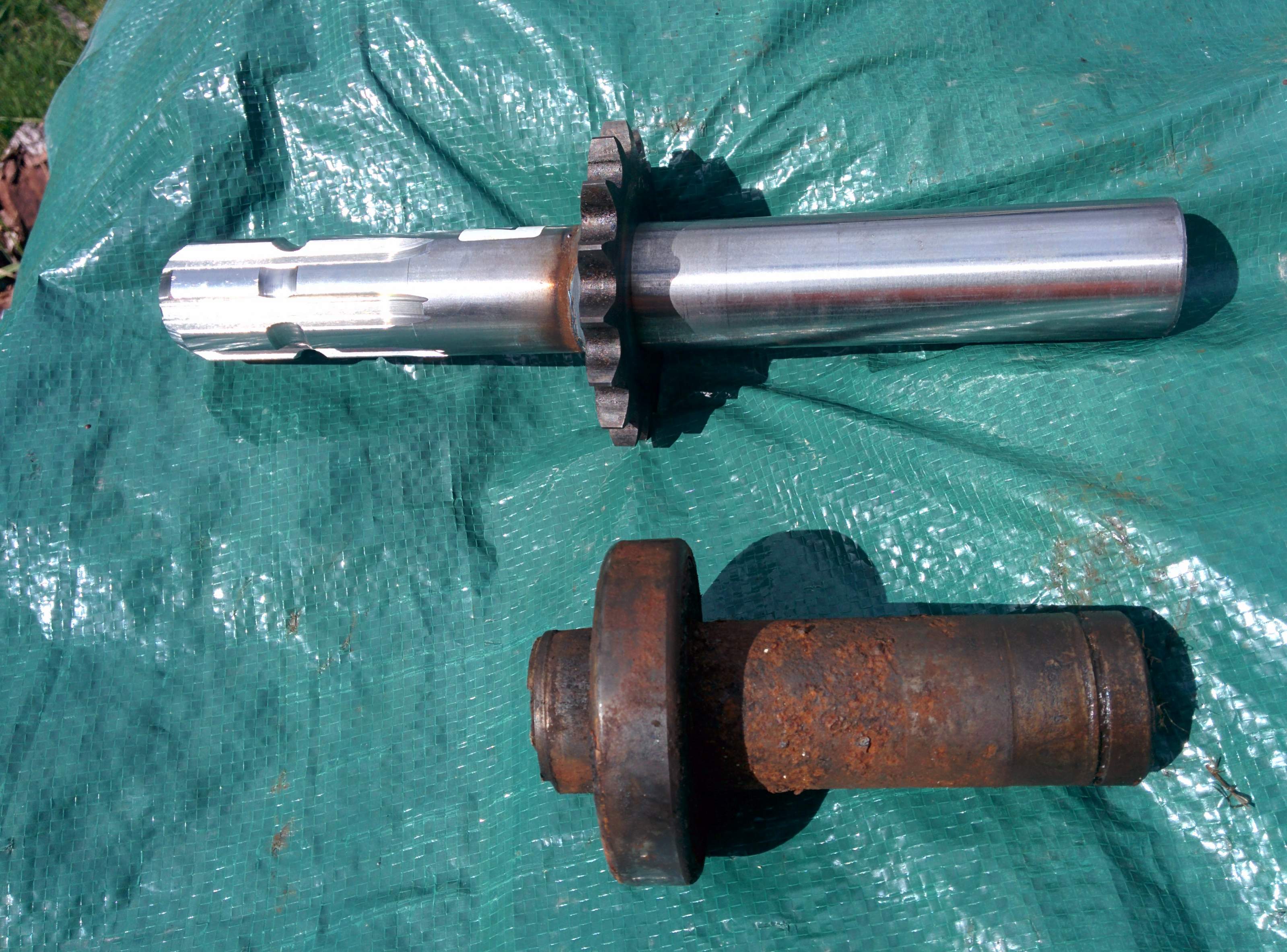

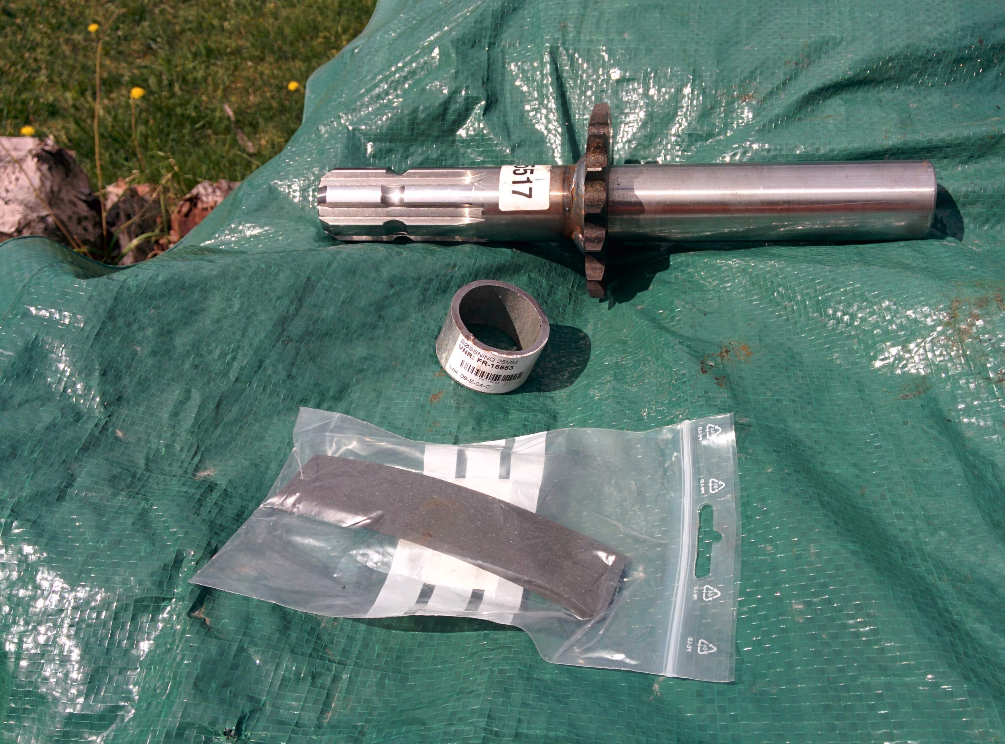

#16
Starting to reassemble with new bearings

#17
Some new parts

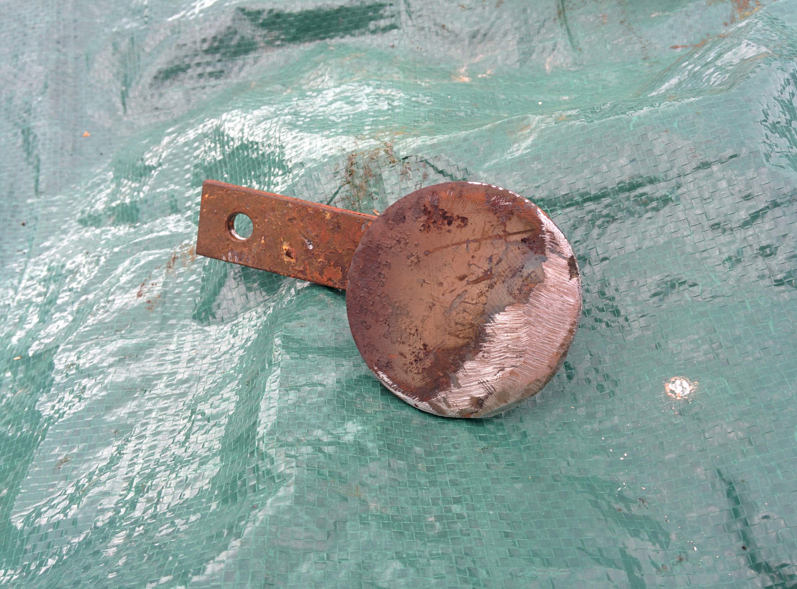

Some more pics
Chain tensioner was worn, welded it an grind it into shape
Replace the brake pad
