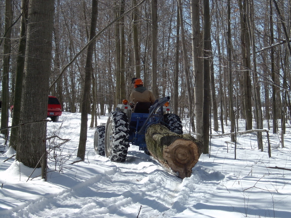

Super Member
Dec 15, 2002
6,311
Wakefield, RI
Mahindra 3016
Greetings... I am about to pull the trigger on a new tractor. Was going to get the ags as mostly this tractor is used for logging however I have about maybe 5 years left of gettable wood after 34 years of logging the area. After that I will be buying (oh the horror) stems and using the tractor for snow and wood landing work only such as piling logs, bringing them to the splitter, moving splits up to the shed, etc,etc. I have looked at just about all the discussions of ags vs industrials but what most of these discussions are missing are details that make all the difference in the world. How else can anyone explain why some have no problem plowing snow for instance and others are slip siding all over the place with industrials. So it is best that when these questions arise, that specifics are stated to perhaps match those that are already working a certain tire in a certain way with certain tractor weights. Here are my "details". I'll be getting a Mahindra 3016 that if I go with industrials will be upsized to 43x16x20. These will be filled adding about 800 lbs to the tractor which will then weigh in at a bit over 4000# with fel. My question is this. Does anyone using ballasted industrials have problems logging in the woods or do these tires need to be chained to be effective? My terrain is relatively flat with minor grade deviations and is dense forest with ground obstructions. Mostly dry and mostly oaks. I skid when the ground gets hard and/or snow covered. I have skidded with as much as a foot of snow on the ground but mostly in 2"-6". As far as ground clearance, there is about an inch difference with the advantage going to the 11.2x24 ags.
Now just to get this straight. I am not looking to discuss the overall aspects of each type tire as that has been done. I am looking for specifics that might match how I plan to use these tires coupled with tractor weight so if anyone has a similar use situation as I've described, I'd like to hear how your combination is fairing. Thank you.

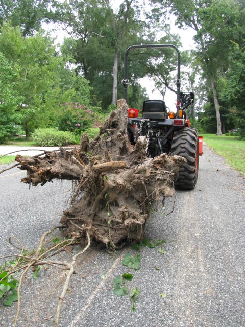

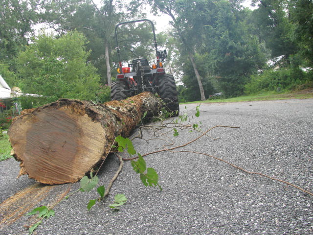

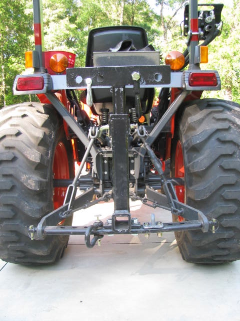

I drag dead logs regularly with my Kubota B3300SU (33-hp / 1,800 pounds) with R-4's. Tires are NOT loaded. Pictures are on asphalt, on the way to my burn pile, but the logs came out of the woods!
Where I live in Florida there are no hills nor grades to worry about.
"Hanging Tree" from which front of logs are suspended is from OMNI Manufacturing.

jeff9366 said:
I pull dead logs regularly with my Kubota B3300SU (33-hp / 1,800 pounds) with R-4's. Picture is on asphalt but the logs came out of the woods!
"Hanging Tree" from which loads are suspended is from OMNI Manufacturing.
Can you provide more pics of your skidding attachment?

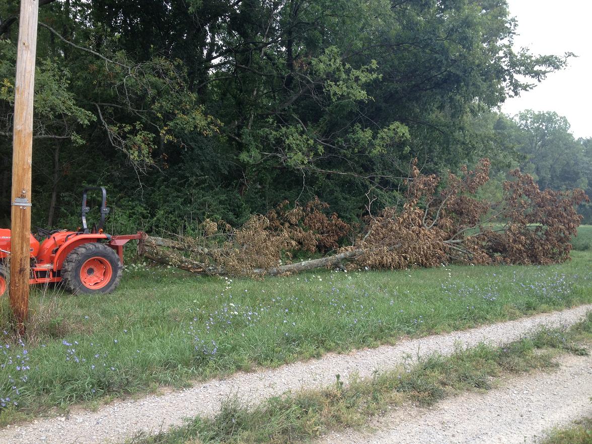

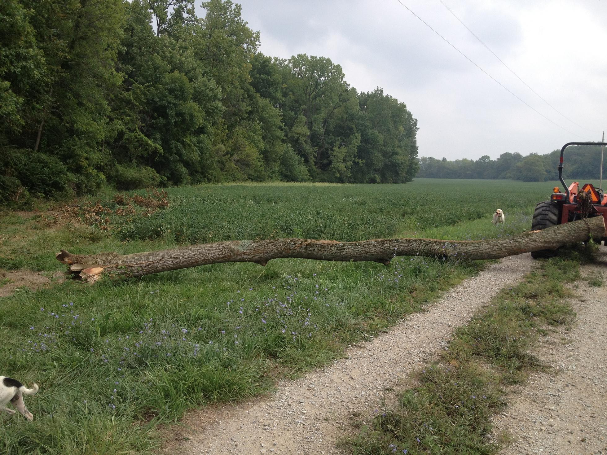

Here's a couple of pics of mine in action.
This is yet another variable. Your tree hitch is cantilevered out to a fair degree allowing a good amount of additional "ballast" for your tractor. Its helping to provide traction as a result. This is good as it is clearing up some scenarios for me. The industrials will certainly lend stability while in the woods and as I have turned my present tractor upside down twice, this can be a little relevant for me. Secondly, if I need more traction, I'll get chains but this way I'll also be able to drive on the grass more than I can now. I'll test the bare R4's in the snow this year and see how they do. I know they will not compare to the ags in this regard but we'll see exactly how much of a problem they are in snow. With a set up such as yours, I think they'll be less of a problem.
That is exactly right. Raising the hitch higher adds quite a bit of weight to the rear wheels. Just have to be mindful of ground conditions and the stress put on the top link.
I can pull a 3-4k log on flat ground in 6th gear. Or at idle in low gear if need be in tight trails....did I mention I love, love, love gear drive?
