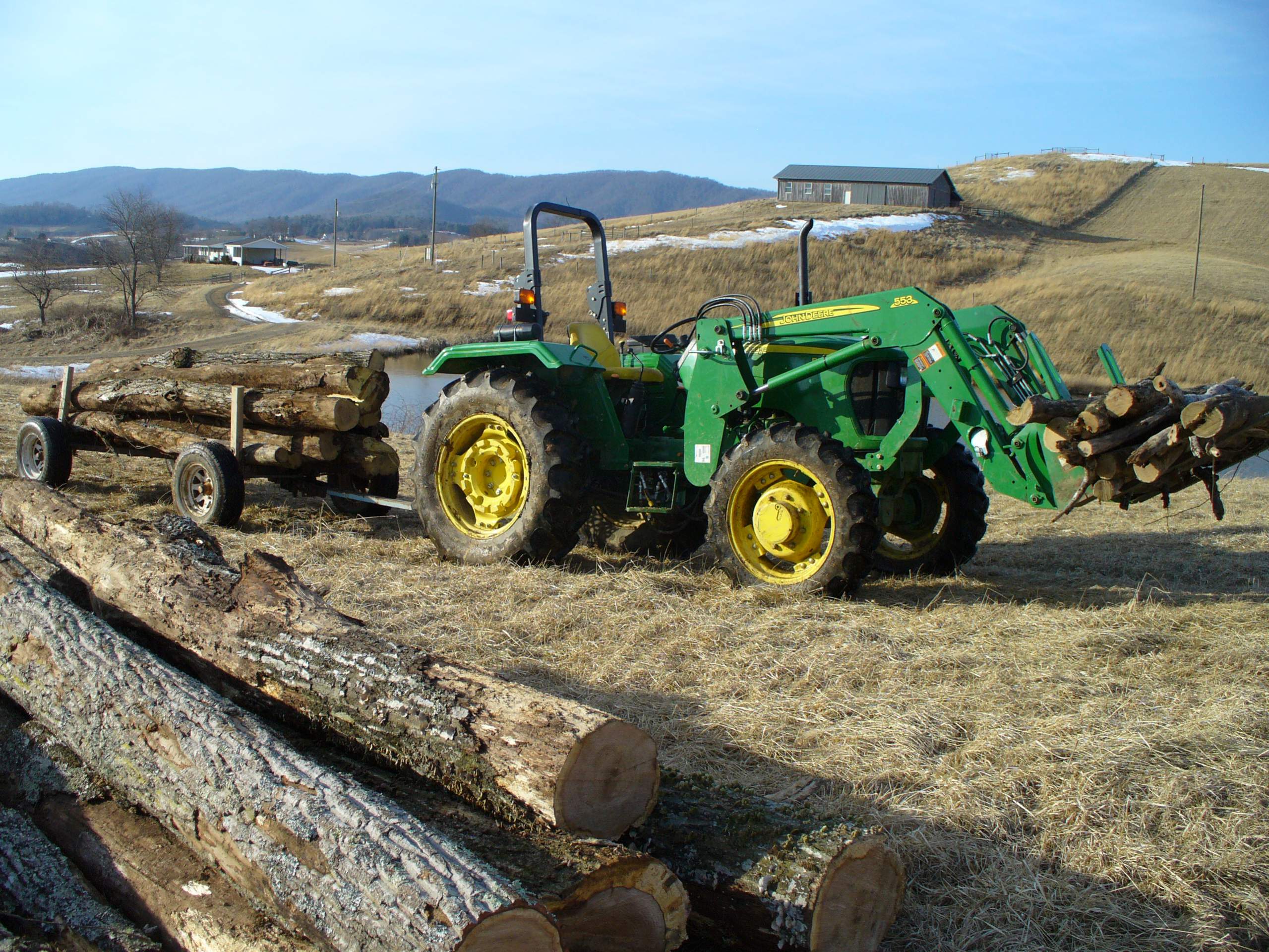

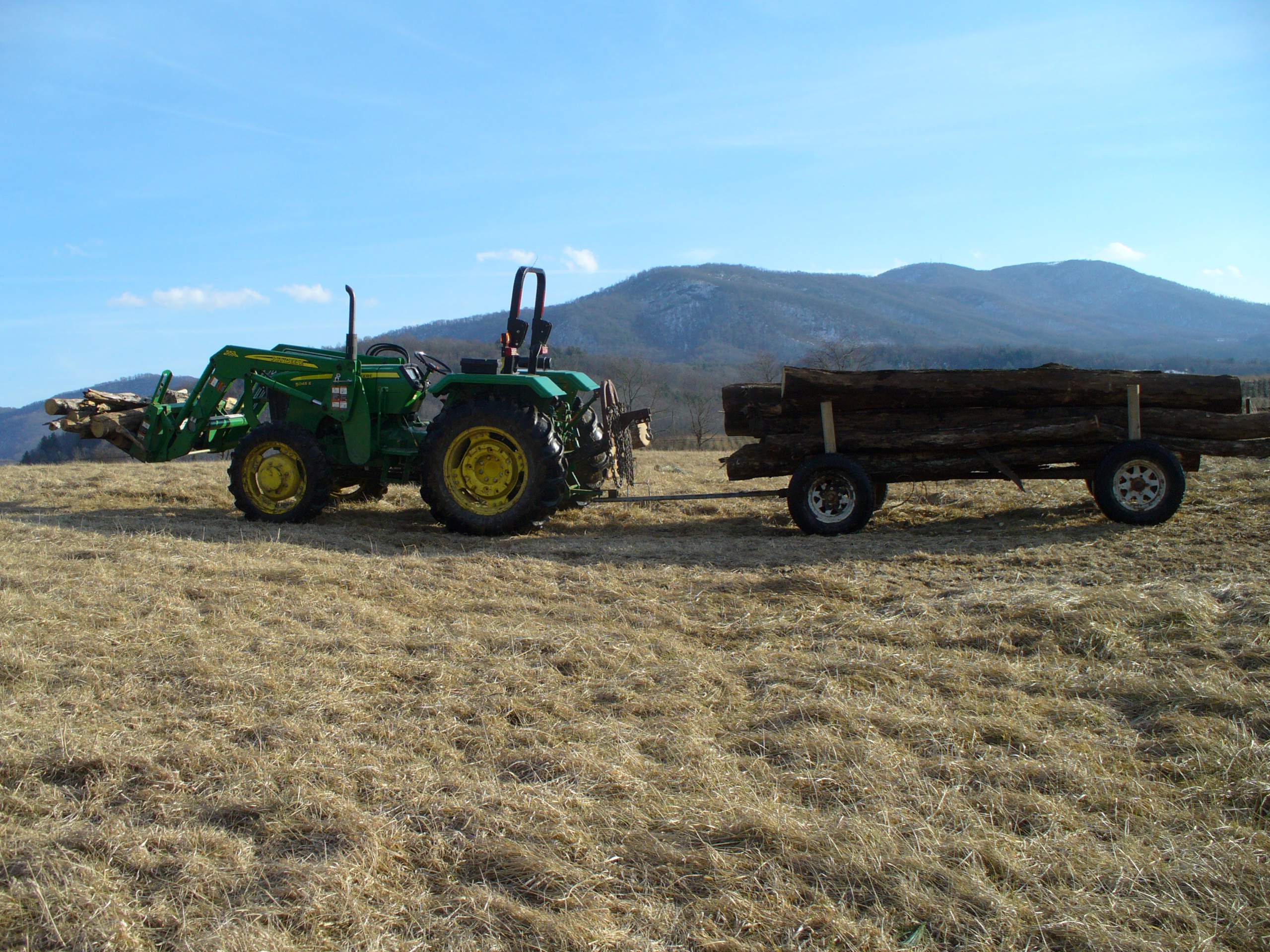

Thought I'd bring this thread back up since it seems to be of interest to a lot of folks. I've finally come up with a good way to get wood to the landing without making a mess of the trails and dirtying the wood. I had an old derelict portable chicken coop that someone had built on a wagon running gear. I tore the chicken coop off, got it down to the bare running gear and refurbished it into a log wagon. It's not pretty, but I have a total of $15.68 invested in it and it seems to do the job quite well. Later I'll make some little log standards out of metal, but so far the wooden ones are holding fine.
We were averaging about one wagon load like that per hour which I thought was pretty good. I believe one of those loads cut and split would equal a pickup load. This setup works well as we can use the tractor for skidding, loading, hauling and unloading, as well as carry small stuff out on the forks. I have to be careful though, that load of locust was pretty heavy and it was trying to push me down some of the muddy hills.
From here we have to get all this wood (hopefully about 15 wagon loads) back to our other farm which is 60mi away. We'll either haul the logs back or cut/split and haul the wood back, haven't decided yet. Either way we'll use one of our 2-ton dump trucks for the hauling.
I'm sure there are plenty of new ideas out there this year so pics and input is always welcome.

I do the same with an 8' hay wagon that I use with stakes for logs or full sides for cut wood. Anything bigger would be too much on the steep hills with muddy trails.

For $15.68 that isnt a bad setup. :thumbsup:

Basically Matt what you have here is a makeshift "forwarder". You can pile 7 or 8 stems (if it would hold that weight) and off you go. Your tractor would never be able to skid that much so it is a much more efficient method of bringing wood to the landing. The guys I worked for between the father, his brother and two sons, had a 110 years of experience between them at one point and they always brought stems to a landing first no matter what was going to be done with the wood. How they got there depended on the terrain, woods density and distance of turn. Almost always it was with skidders. Grit on logs was worried about as much as a pimple as a hand hatchet cleared the chain path. Plenty of times we could and should have used a forwarder but in no way could this operation afford a "new fangled machine". We did attempt to use a telephone pole dolly once but that was a disaster in these woods. Open and "the woods" mostly didn't correlate here in New England.
