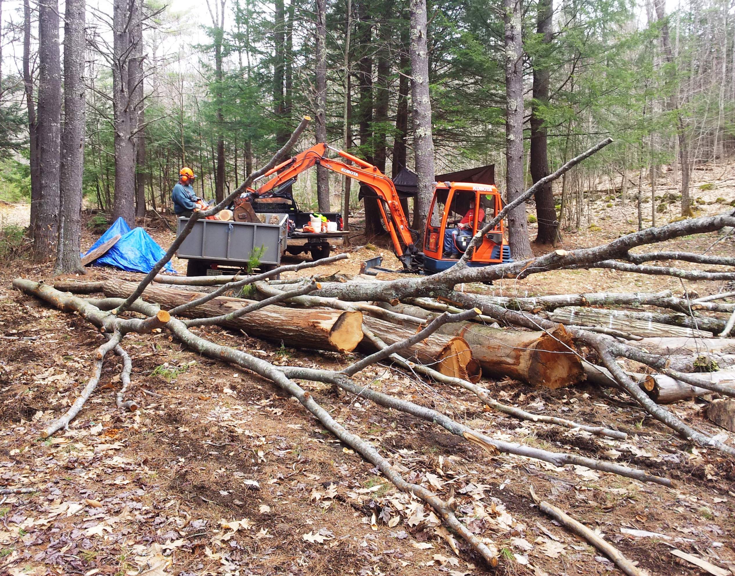

On my 30 acre woodlot we fell the trees keeping firewood size limbs intact. Logs are cut to length judging the weight so as not to overload the Kubota L2500 with Tajfun winch. Logs are skidded to a landing that is accessible by pickup truck and 10 dump trailer. Logs are marked to desired length, usually 16 inches, with a Mingo marker. Then logs are then held over the dump trailer with a Kubota KX121-2 excavator with thumb. The guy standing in the trailer cuts the logs to firewood length where they drop into the trailer, stopping after each log to move some of the pieces to stack better.
Once the trailer is full it is taken to the firewood storage area at one of the homes. The dump trailer is lifted enough so the rounds can easily be pulled, aided by a hookaroon, onto a Timberwolf TW-2 log splitter. Split wood is placed on stacks for drying.
Not a method for everyone but it works for 3 fat geezers to heat their houses without minimal handling.

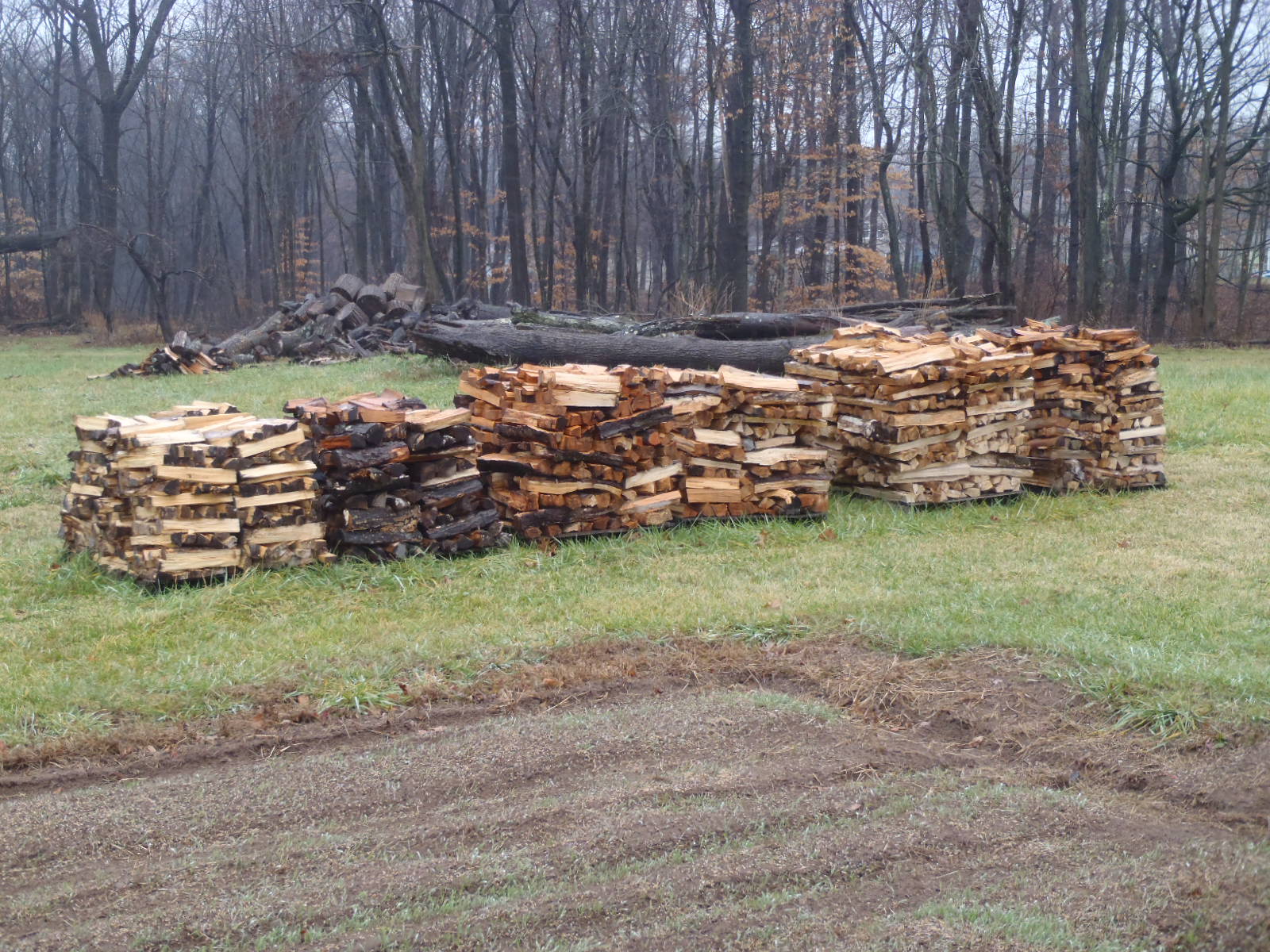

The pallet system works for me. If you stack it carefully you don't need crates. I haul logs to "central receiving" area where they cure on cross logs for a year. They get cut up, split & stacked on pallets at the same location & moved a short distance to sit in the sun for a few more months until it's time to bring a pallet or two over to the house to load the stove.
Having 3 point forks is key for me as I can lift a lot of weight and the TNT allows me to get the forks into the pallets easily and to shift the load as required by the route I take.

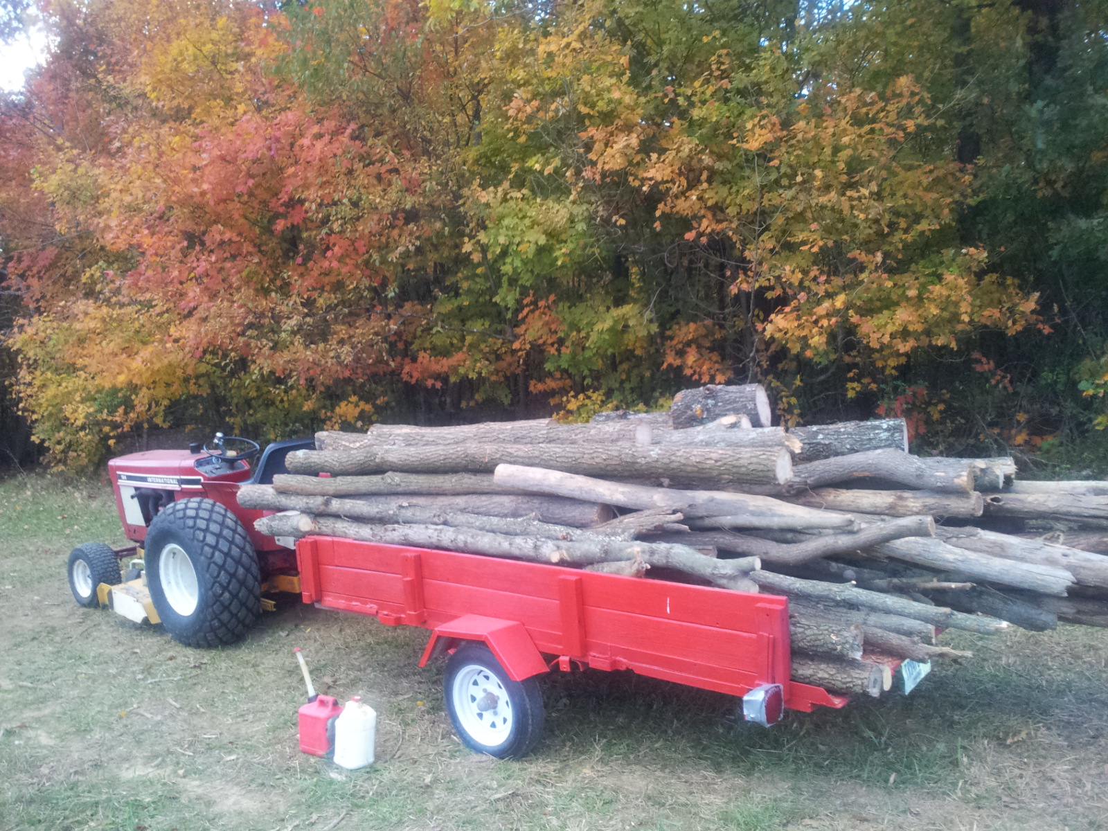

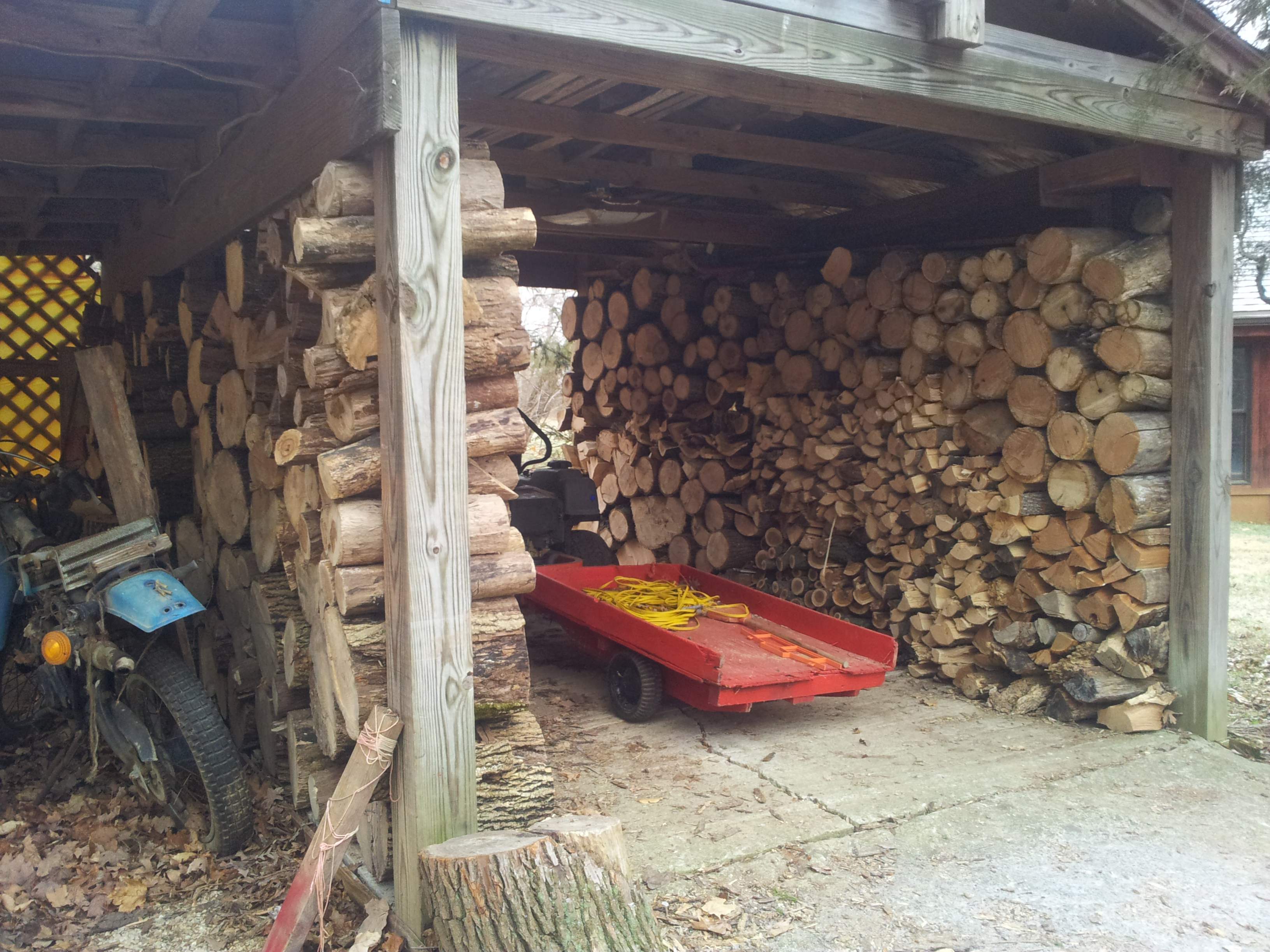

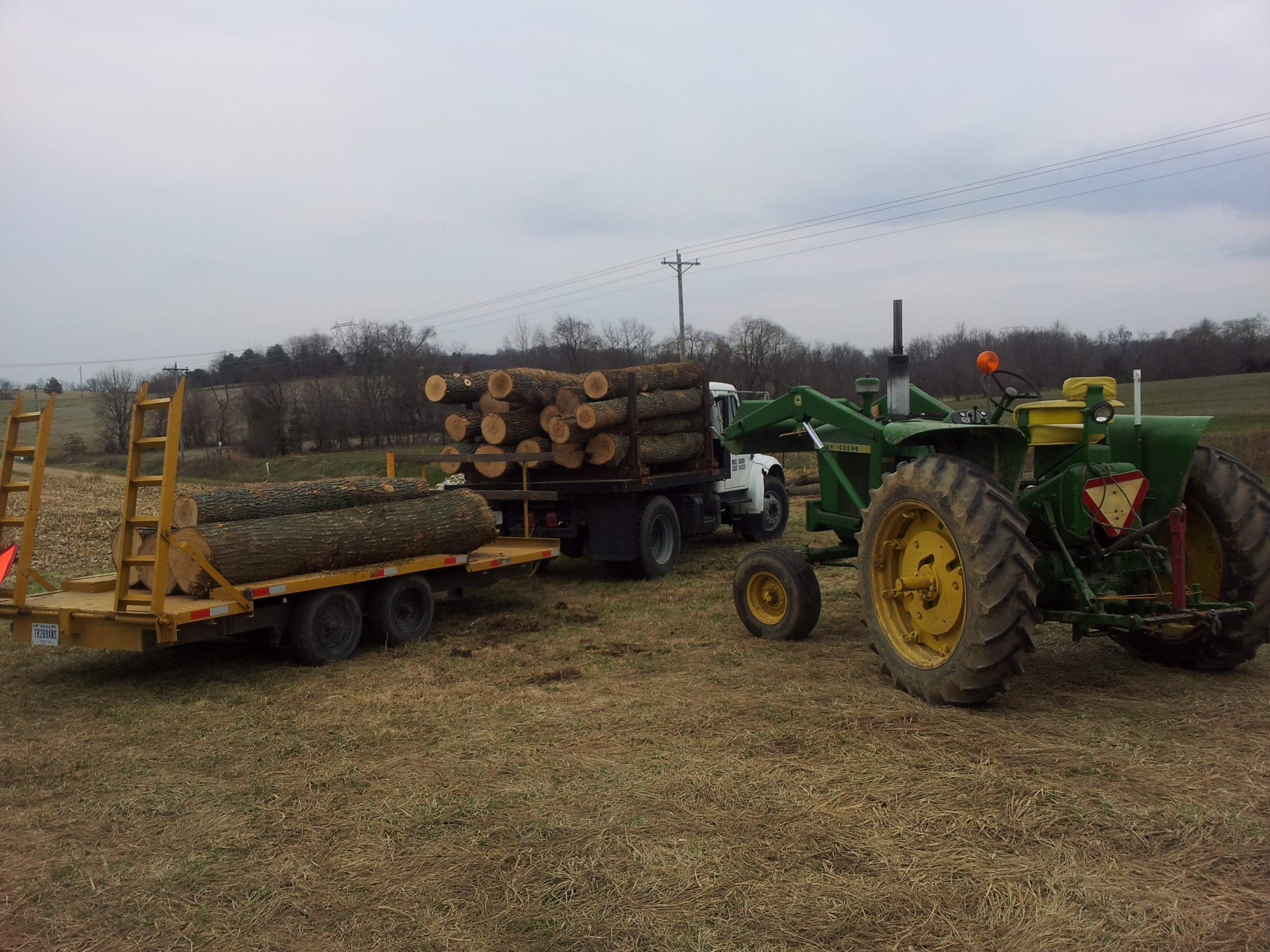

Well, I mainly cut firewood just to keep my little 5 acre lot clear and have a couple ricks to burn in our fireplace each winter. I usually sell any excess. The emerald ash borer has devastated our ash trees, so I have had plenty of extras these last couple of years. It's exercise and an excuse to play in the woods with my tractors for me. I use my trusty-dusty Wheelhorse and homemade box trailer to get in and out of the walking trails. For larger trees, I go in with the cub loboy and the 8' trailer or the old ton dump truck. I also have a carryall with a big metal box I can get a half rick in - whatever I want to play with that day. I like sawing at the site because I don't have a big pile of knots, ends, and sawdust in the barn lot that way. We did cut some logs on our farm this fall and I used the 3010 Deere and loader to lift logs on our 14' flatbed trailer and unload them in the barn lot. We had to get them while the ground was frozen, as it has been quite wet this year. That is more handling, but I had firewood I could get to and sell when everyone was running out this winter. - LuggHandles -
