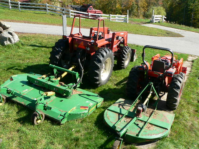

Chilly I have to say thank you. This is off subject but I have a trail mower I pull behind the ATV. Every once in a while I pull a tire off when the out rigger wheel hangs up on something and I give it a little gas :laughing:. I saw those pipes welded on your arch and wondered what they were for - DUH. But now I know. I am going to put some deflectors like that on my mower. THANKS

GG,
Google "swisher" and look at their trailer mower. They have flat steel that extends out in front of the tires and when you hit something the mower will slide sideways rather than hang up on the wheel. It would be easy for you to add.

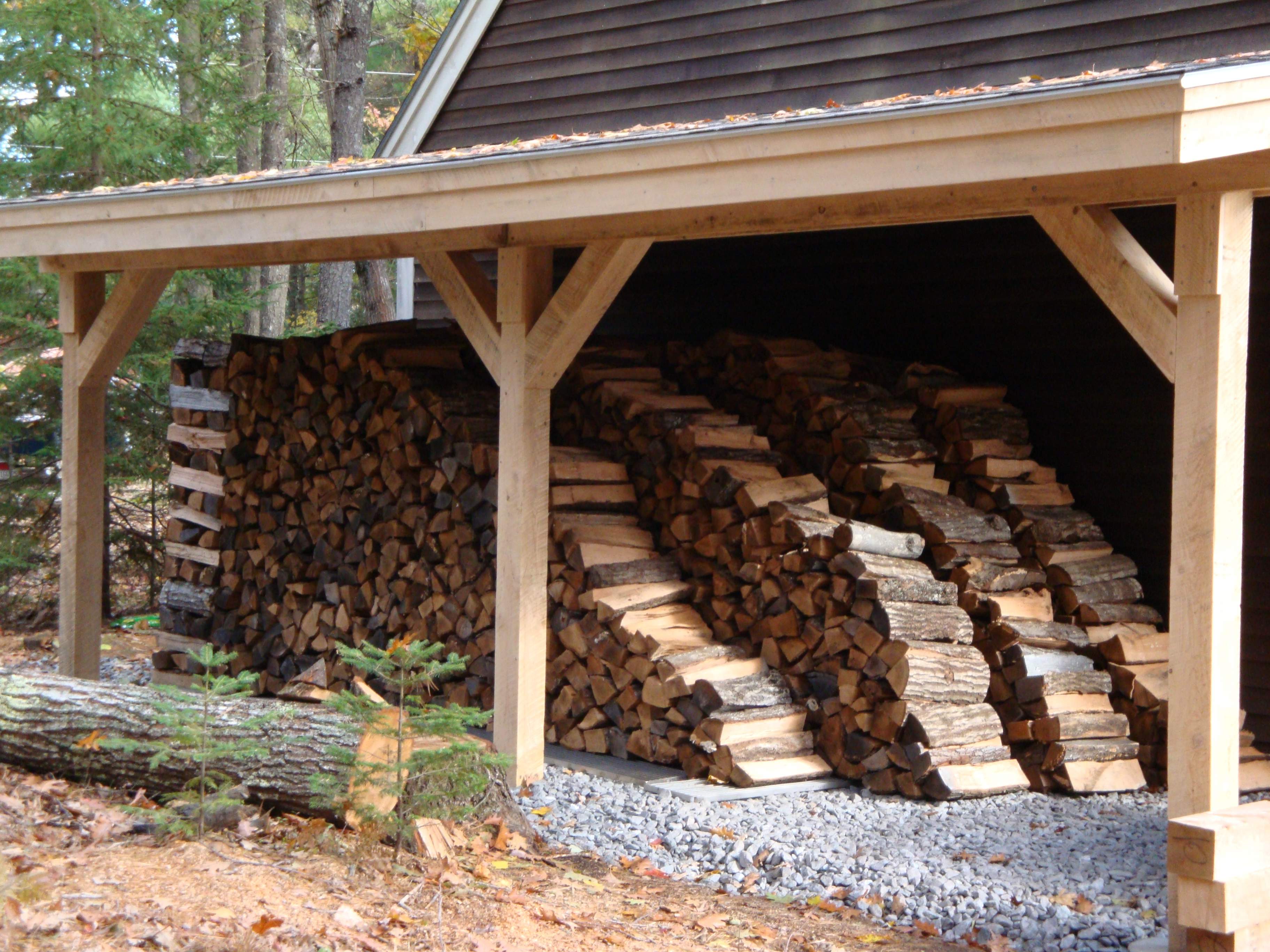

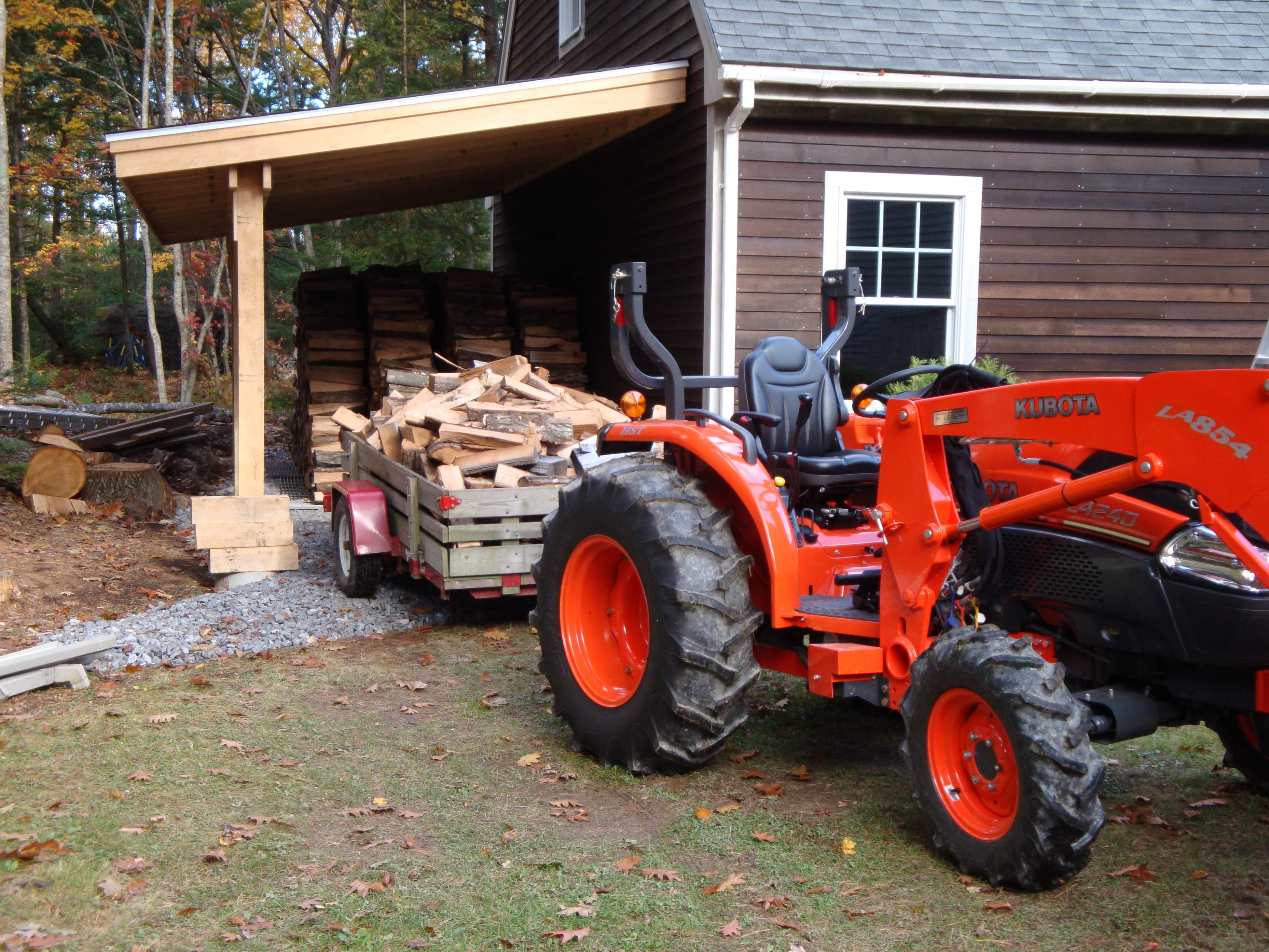

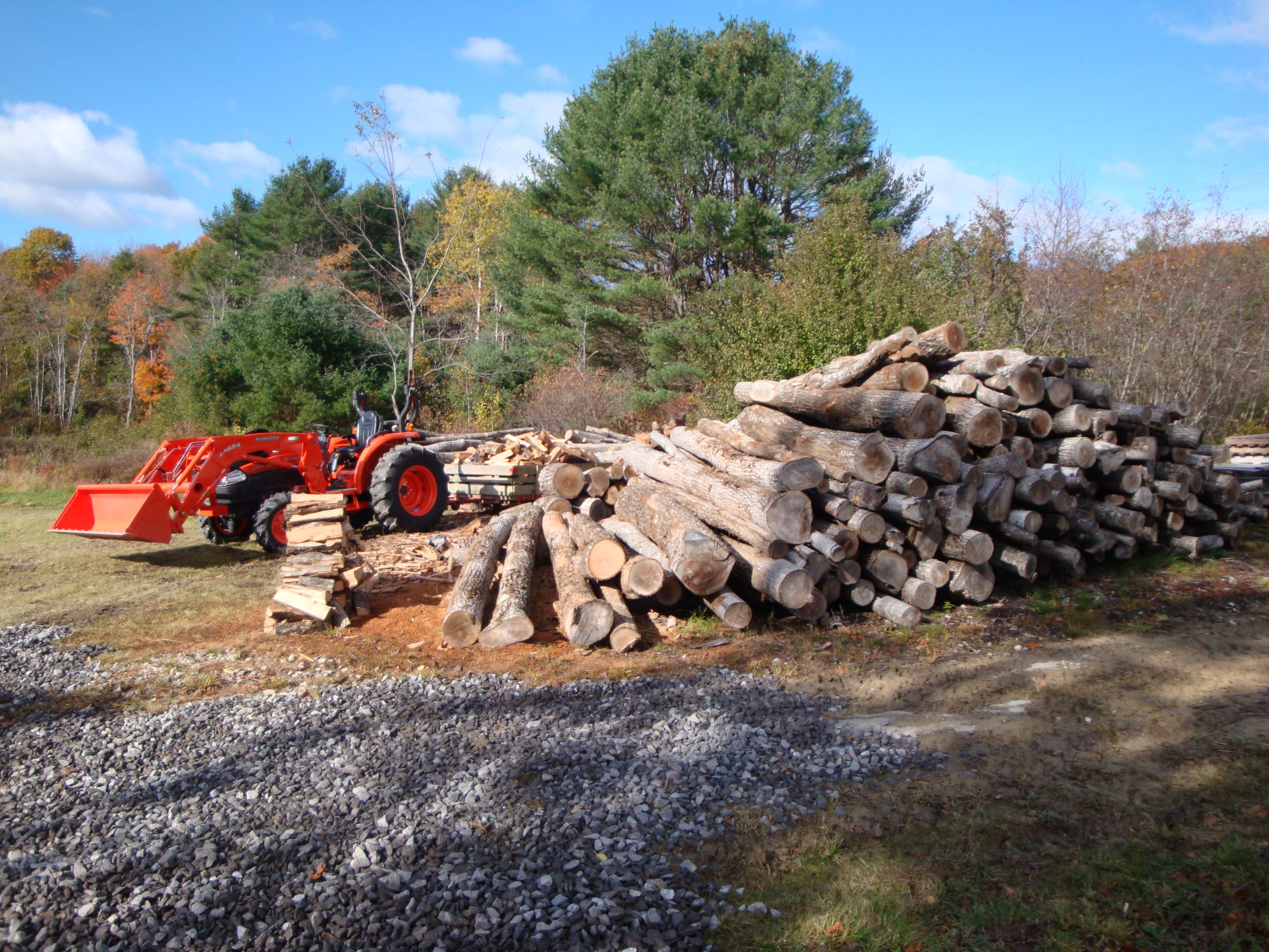

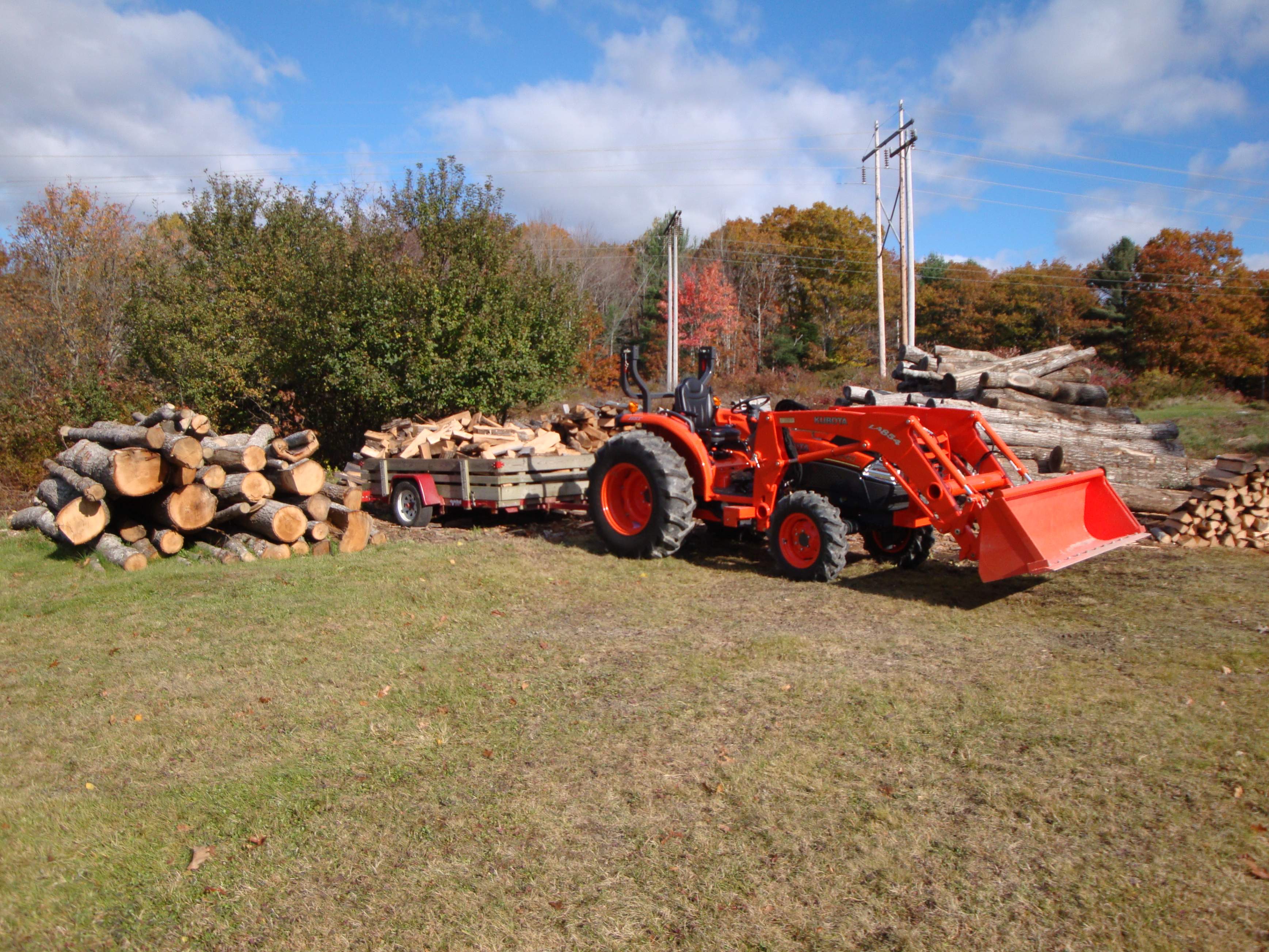

I cut 10-12 cord per year and have most of it delivered to my wood yard, usually tree length. This is my first year with a tractor so I'm anxious to supplement my supply by skidding some out once things freeze up.
My method is to cut a trailer load at a time off the pile. As it comes off the splitter, I throw it in the trailer and haul it off to be stacked. I got tired of using tarps and all that goes along with them so I built a woodshed this fall. I knew last winter I was building it so I just threw the wood in a pile and had to handle it one extra time. Others much wiser than me feel you shouldn't stack it right away for proper drying so I'll try that this winter.
