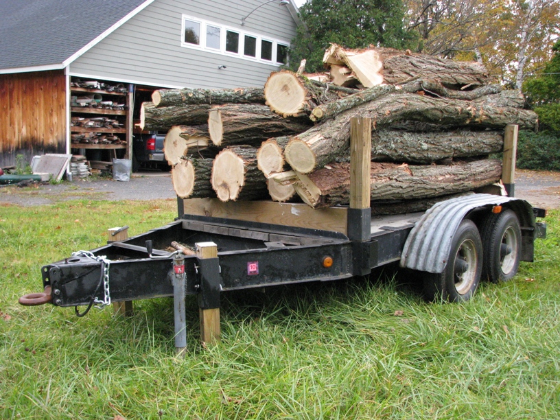

My woodlot is 3/4 mile uphill from house on a road I don't want to scuff up from skidding. I have been changing methods also for decades.
Newest version I like. I have an old beater skidding winch (I'm getting to be in that condition myself). Cut trees in 10' lengths (stove takes 20"). Load logs with grapple onto modified bobcat trailer, stack or windrow brush with grapple. Bring trailer to shed area, unload with grapple, stack on each other for bucking. Buck and roll chunks to splitter, which has a lift. Split and toss into pile. Invite offspring to stack new chunks and load last year's pile into shed.
The trailer is the improvement here, along with the grapple. I used to haul the splitter into the woods and bring stove lengths down, but there's too much handling. Vertical: If your woodlot permits, your new trailer might be the thing that makes a working system for you. You can pull a lot with an NAA, just make sure the tongue is loaded heavy.

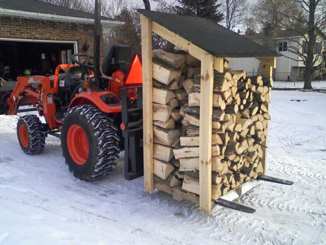

I built and use these, they work well for me, I just need to build several more!
I really like your idea. How long will these last? I need a good source for pallets.
Jim
I am looking forward to trying my new trailer, I haven't decided if I will load it on stove length or log length. It's just a standard 5x10 angle iron utility trailer, but I built it extra heavy duty and designed it with more tongue weight than average. I'm also building it with a tail gate instead of a ramp for more versatility. Fully loaded it will haul 3500lbs and put about 800lbs of tongue weight on the hitch (which are the limits of my B3200, hence the design). The NAA will definitely pull more, so I might pull it with that and load it with the B3200.
