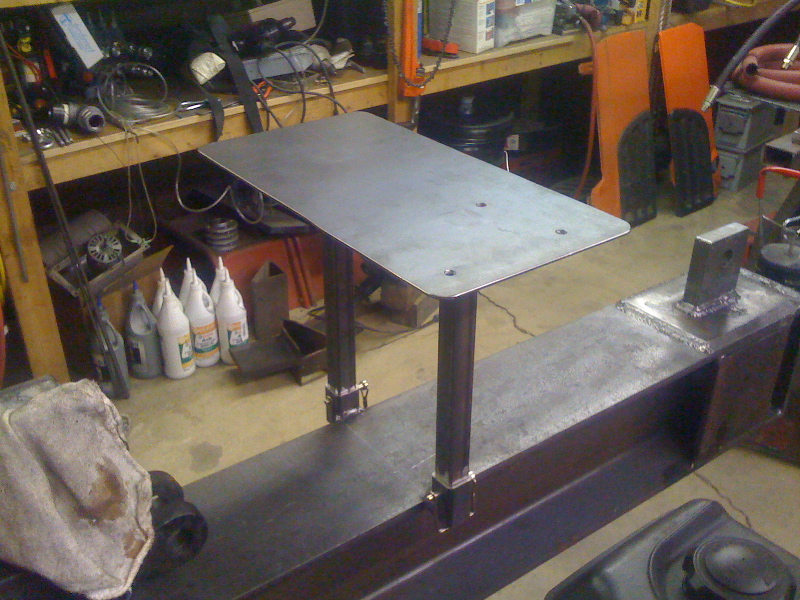

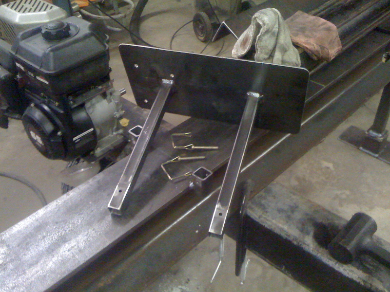

Trying to collect up various pins and stuff that have gotten misplaced at this point, install the table grate, and then may pull it out of the shop and test it out ... although I still need to weld up the 4-way wedge ... might do that first.

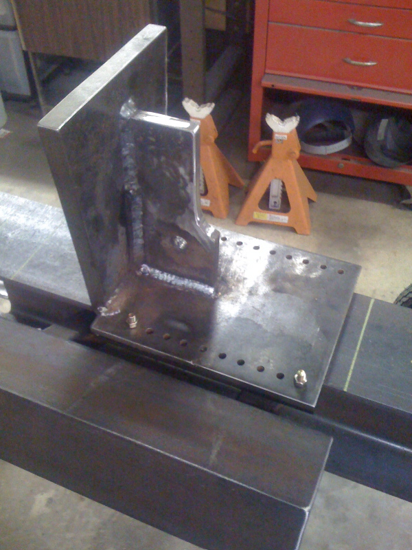

Fixed a minor interference issue with one of the capture plates that bolts onto the bottom of the push block ...was hitting the tubes the fixed cradle is attached to, that is opposite the log lift. Wasn't a real big deal ... but it was causing the push block to tilt slightly on one side every time it ran past the cradle.
Started working on the 4-way ... the steel plate pieces I have for it are less than ideal ... a couple of pieces that were made up from separate pieces themselves (4 ---> 2) ... they are a little warped. Will try to tack them up and see if they will still slip-on both ways before I weld the wedges on. If not I'll spring for virgin steel.
Still missing a couple of pins that I can't seem to find ... :(

Well, things didn't go quite as I had hoped ... best laid plans and all that ... :rolleyes:
Got the 4-way wedge essentially done ... turned out ok, but not perfect. It does slip over the fixed wedge on the beam both ways with no problem (flippable) ... but it's loose enough that it cocks a bit and will jam on ... so you can't just pull it off. So far, tapping it with a plastic HF deadblow hammer un-wedges it so it can be removed/flipped.
Biggest surprise was that even with the 3" cylinder, the log lift would not pick up a large round (30" mebbe ?) It was fairly heavy ... at least several hundred pounds I'd guess. Think it may have been some ash that appeared to be dead already when they delivered it.
The cylinder did have enough power however to snap the welds on one of the pieces of 1" solid square bar stock that I used to build the brackets on the log lift for the attachment of rod end of the cylinder, after repeated attempts to lift the round. Probably need some gusseting.
I think part of the problem is the initial angle of the cylinder lacking enough mechanical advantage to get started.
