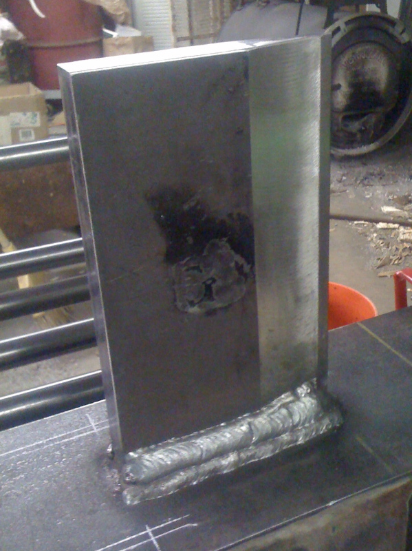

Added a thinner knife edge on the 4-way wedge yesterday to see if that helps getting it to piece the rounds a little better.
Used a piece of 5/16" plate about 1 1/2" wide ... which leaves an opening of just under 23 1/2" inches between the 4-way and the push block:
