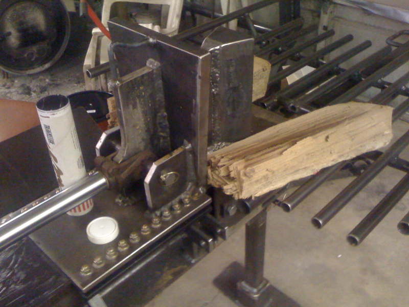

Trimmed the sides of the table grate. Since the span is getting pretty wide, I decided to beef it up a little by sticking in 3/4" solid round inside the pipes:
If I had used Schedule 80 pipe rather than Schedule 40, I wouldn't be as concerned ... but my supplier was out of Schedule 80 at the time I ordered the steel originally.
/ Logsplitter 2.0
#403
Still have a little bit more welding to do to get the pipes all tied in but it's getting there ... should have all the welding done on the table grate in the next hour or so:
Will need to swing by U.B.'s tomorrow and put the torch on the new pipes and bend them down.
The additional space on the table should make doing resplits a lot easier.

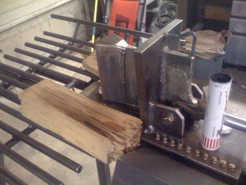

Got the pipes on the table grate all welded in last night after dinner.
Pic from the front that kinda shows how wide it ended up being (with a little illusion of the camera lens as well :rolleyes:):
