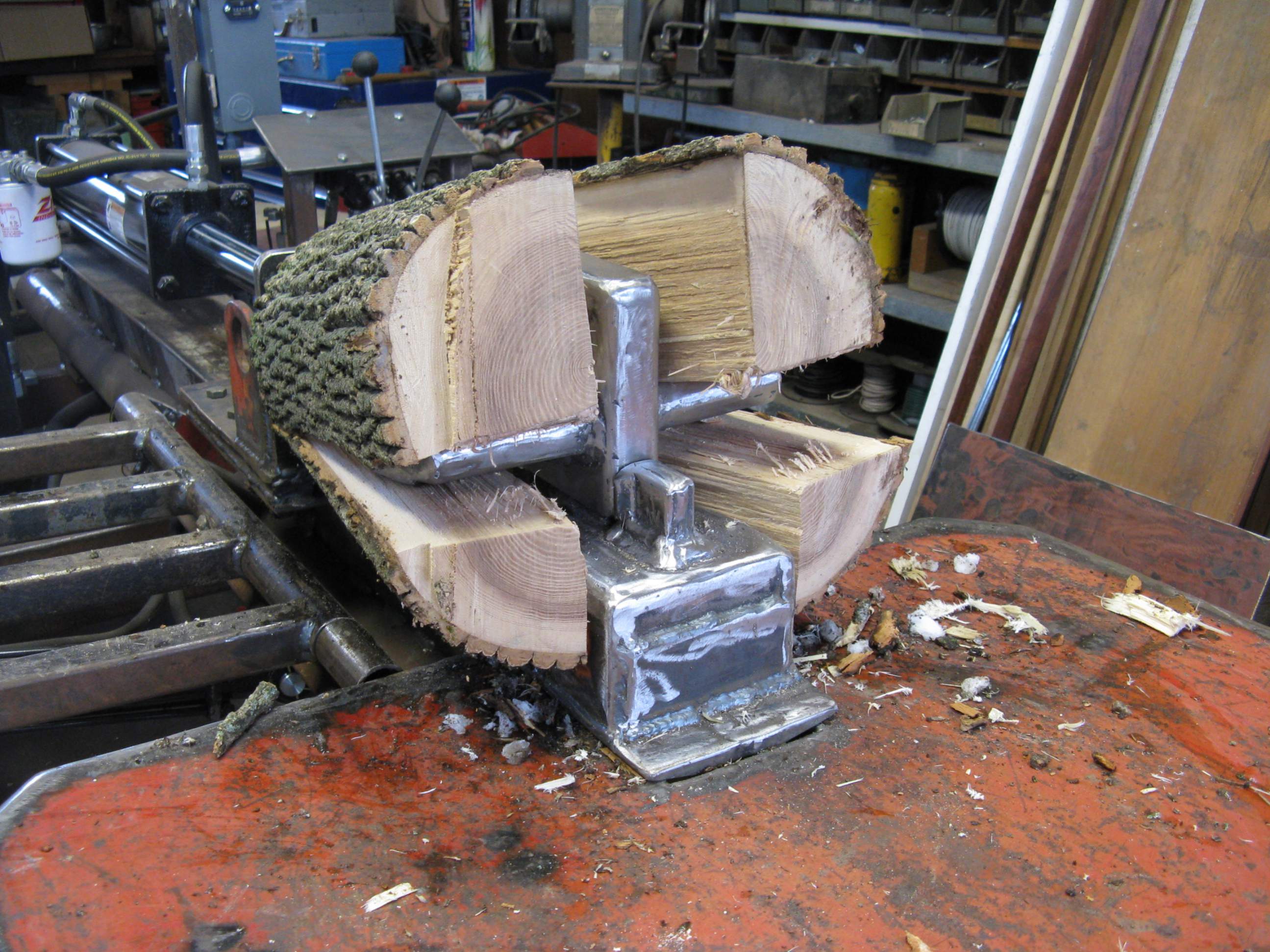

I've had splitters with the wedge on the end of the beam and the wedge on the end of the ram. I much prefer the wedge on the ram as I don't like chasing the wood of the end of the splitter. Having a table on the end is just one more thing to have to stow and transport.
The bet of all worlds is a vertical splitter where you can sit down and split stuff. This requires the wedge on the ram, of course.

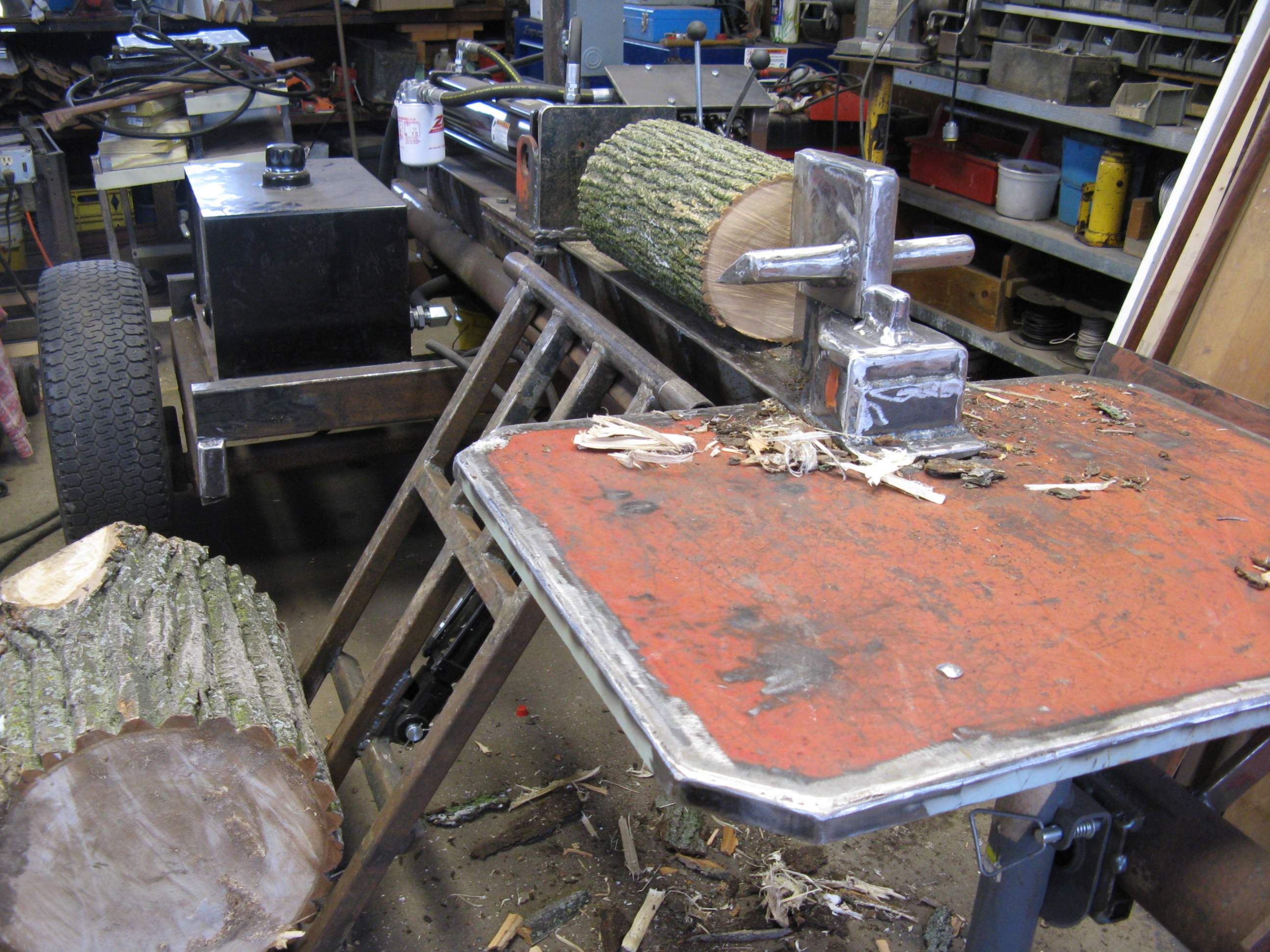

Any particular reason you went with solid sheet metal on your table ... rather than just doing a table grate like Timberwolf does ?
Just the material I alreadt had on hand. I didnt have a bunch of lengths of pipe. But had that 11ga sheet left over from skinning my plow and building the wings and didnt see any other use for it.

Here's a pic of the rack that attaches to the rail. It works well in horizontal position but doesn't get in the way vertically.
You can see my blue pillow on the 5 gal bucket seat.

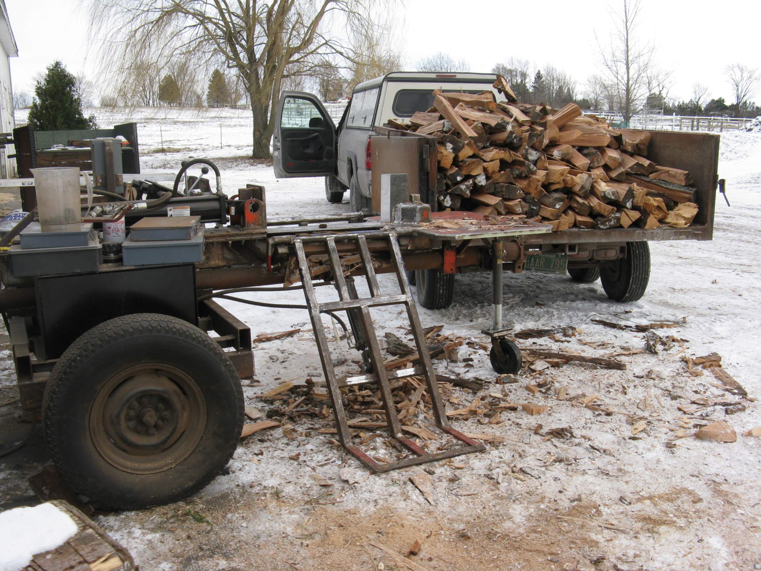

But also dont want too little tongue weight as to flip the splitter when a large round is placed on it.
I leave it connected to the tractor, whichever one I'm using at the time. I usually don't even put down the front leg.
Notice the rounds close on one side and the pallets on the other. From the pile to the splitter to the pallet with only occasionally getting up to move the rounds closer.
I had the leg down here as I was just about to move the tractor to push a bunch of rounds closer from the main pile.

One of the problems I ran into when towing with the table attached was that there was not enough clearance between the splitter and the tractor wheel. Had to make an extension to the tongue

I built my splitter at 35'' for a good working height for me. A large caster is bolted to the fold up jack so I can push it in and out of the shop.
/ Logsplitter 2.0 #37
That is the perfect height, No bending over at all. I want that log lift.

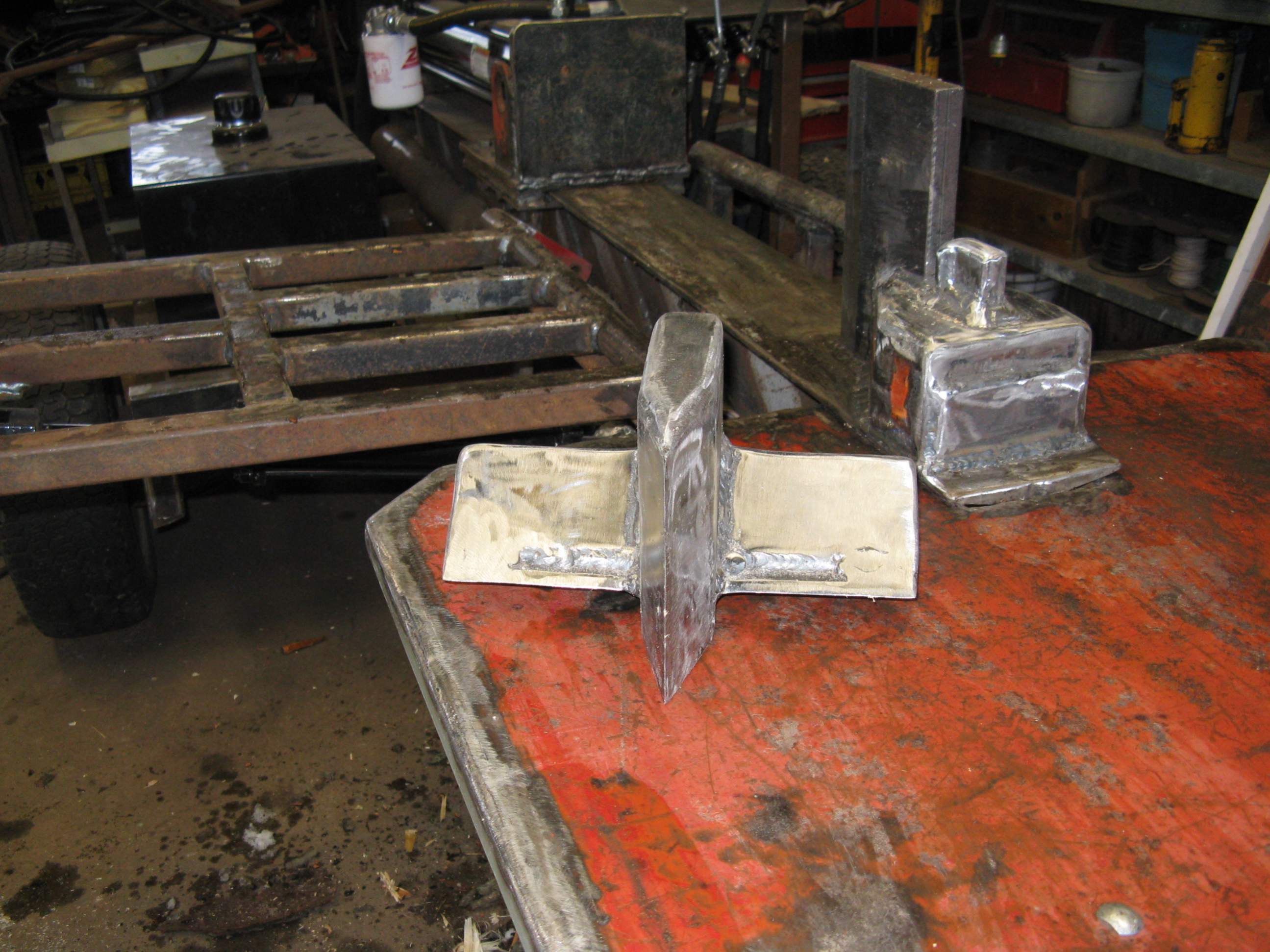

Well, after getting stiffed by our regular UPS driver twice on Friday and Monday, I finally have my Surplus Center order. I ended up have to drive over to the terminal (14 miles) and raise holy he11 and then they called him and arranged for me to meet him at a local business to get the package.
All because the guy wouldn't drive about 150' - 200' on my driveway (flat, level) ... 'cause it had maybe an inch or two of snow on it. He didn't even have to bring it all they way down to the house - just to the shop - where my van was parked.
So I now have the stub axles, the hubs, a riser for the filler/vent, the 2" NPT pipe flange for the suction strainer, a 300 psi gauge for the filter on the return line, and some fittings.
Ran into a little situation the night before last: had some creosote/debris fall down into the 90 elbow that connects the chimney to the double-barrel wood stove in the shop, almost plugging it ... which prevented me from really getting a fire going. So I spent some of yesterday cleaning out the stove/chimney.
Ultimately ends up being a good thing as it needed it (overdue) and allowed me to discover that the 90 elbow really needed to be replaced, as it was almost rusted out ... up inside the pipe that it connected to.
Also spent some time on finishing the new backstop for the pallet forks so I can get them put back together and get them out of the shop - as they're just one more thing that's taking up space in an already cramped area.
Hopefully make some good progress on the splitter today.
I did manage to get a little done on the splitter yesterday - cleaned up the log rest which was partially painted/primered ... and rusted wherever it wasn't. Also did similar for the push block.
Will probably have to make a trip to the LWS for another bottle of 75/25 ... probably hit Harbor Freight for that receiver tube while I'm at it.
