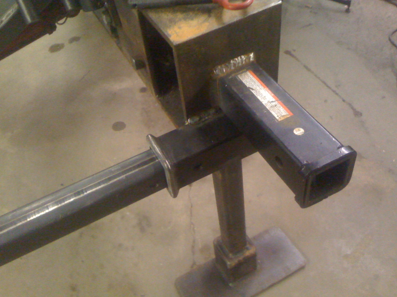

Spent a good part of yesterday cleaning up the shop ... but I did manage to pick up another 18" hitch receiver from HF for the log lift outrigger/stabilizer when I snuck out in the afternoon ...
Cut that in half and welded some 3/8" solid round onto one end to reinforce it, drilled a 5/8" hole for a hitch pin, and then welded the receiver onto the end of the beam:
