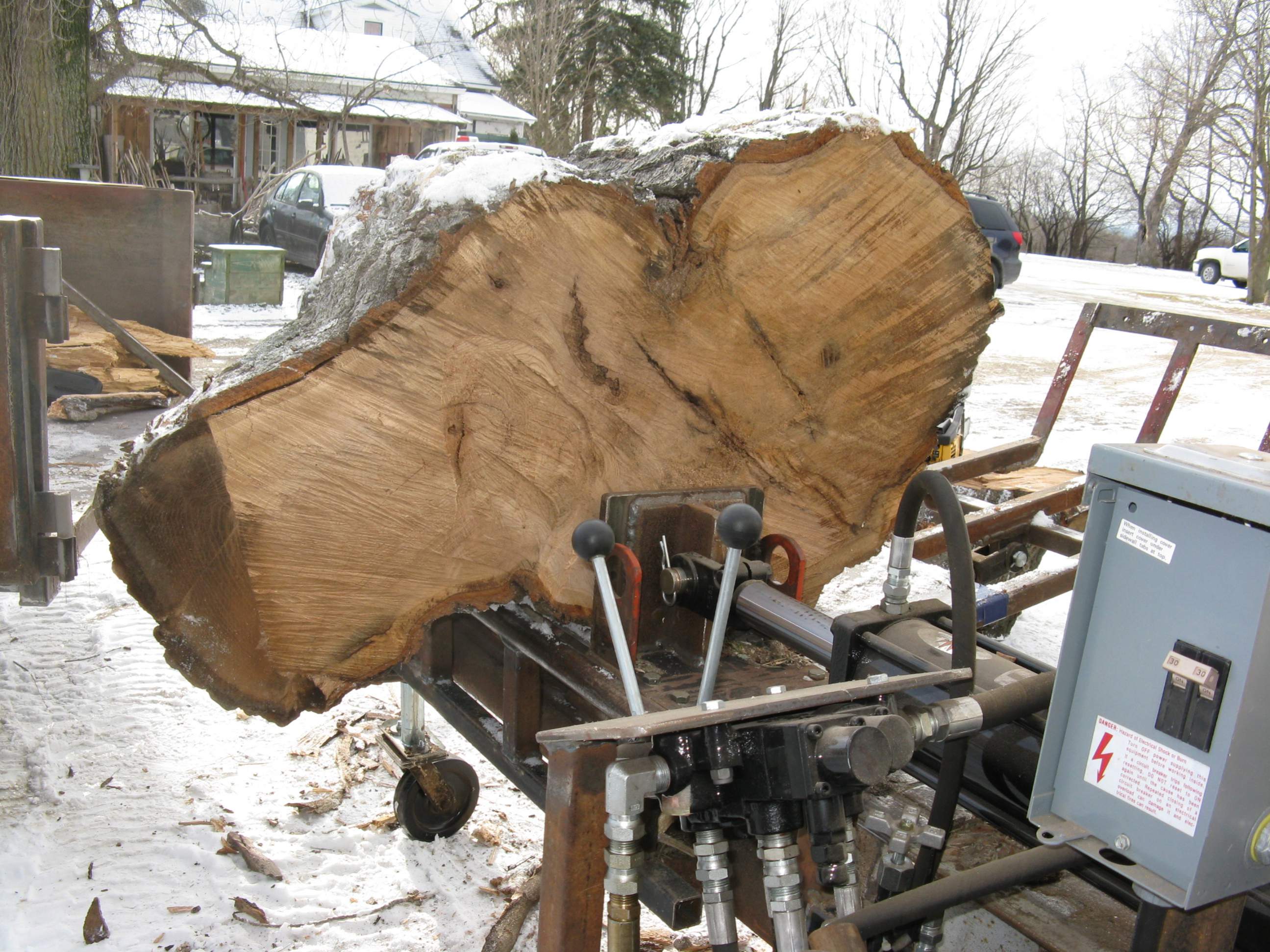

I have split a bunch of 34" or so dead red elm, assorted oak and cherry. Even with a 10" wedge on my splitter, You only get a partial split just on the bottom. Then the monster wood wants to fall on the ground and in most cases it does what ever it wants to. Then wrestle it back on the lift and pop a different side. Eventually you can get it. After 50 cords of that big stuff, I now try to stick with 24" if possible. I was reading the early part of this build and I must have gotten lucky building my lift. I added a spool valve via power beyond to run the lift cyll. Then I just picked my pivot area and built the lift. Then when the cyll. was installed I just pulled the ram out and drew a line where it would hook to the lift at slightly higher than level. Worked so well I had to laugh. Lifts anything I can roll.
/ Logsplitter 2.0 #284
On the large stuff either I tilt my splitter up so I don't have to lift it or I use my loader. I place it on the opposite side of the splitter from me so I can just roll the rounds out of the bucket onto the splitter. Once they split half wants to roll towards me which is easy to handle while the other rolls back into the bucket.

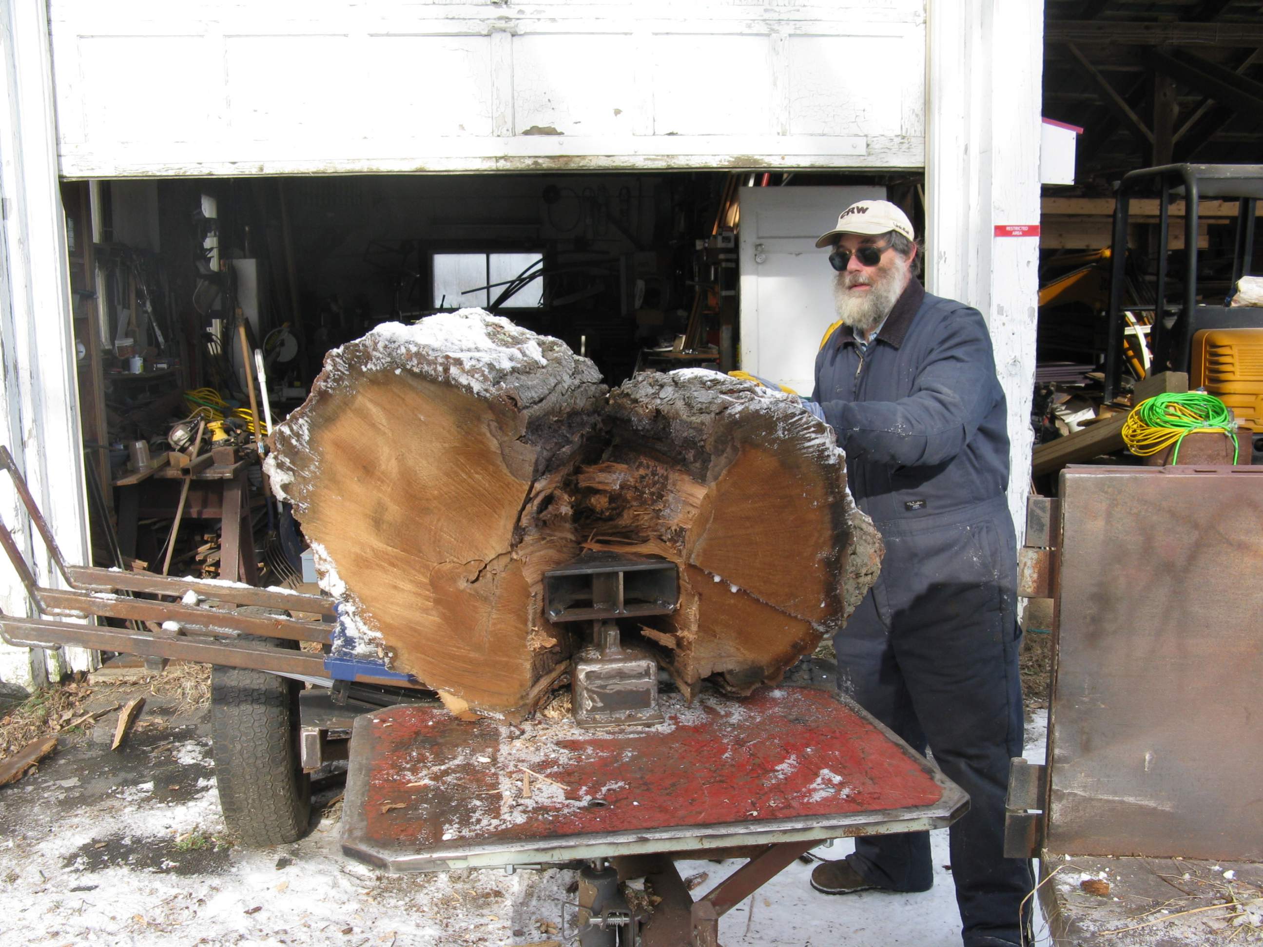

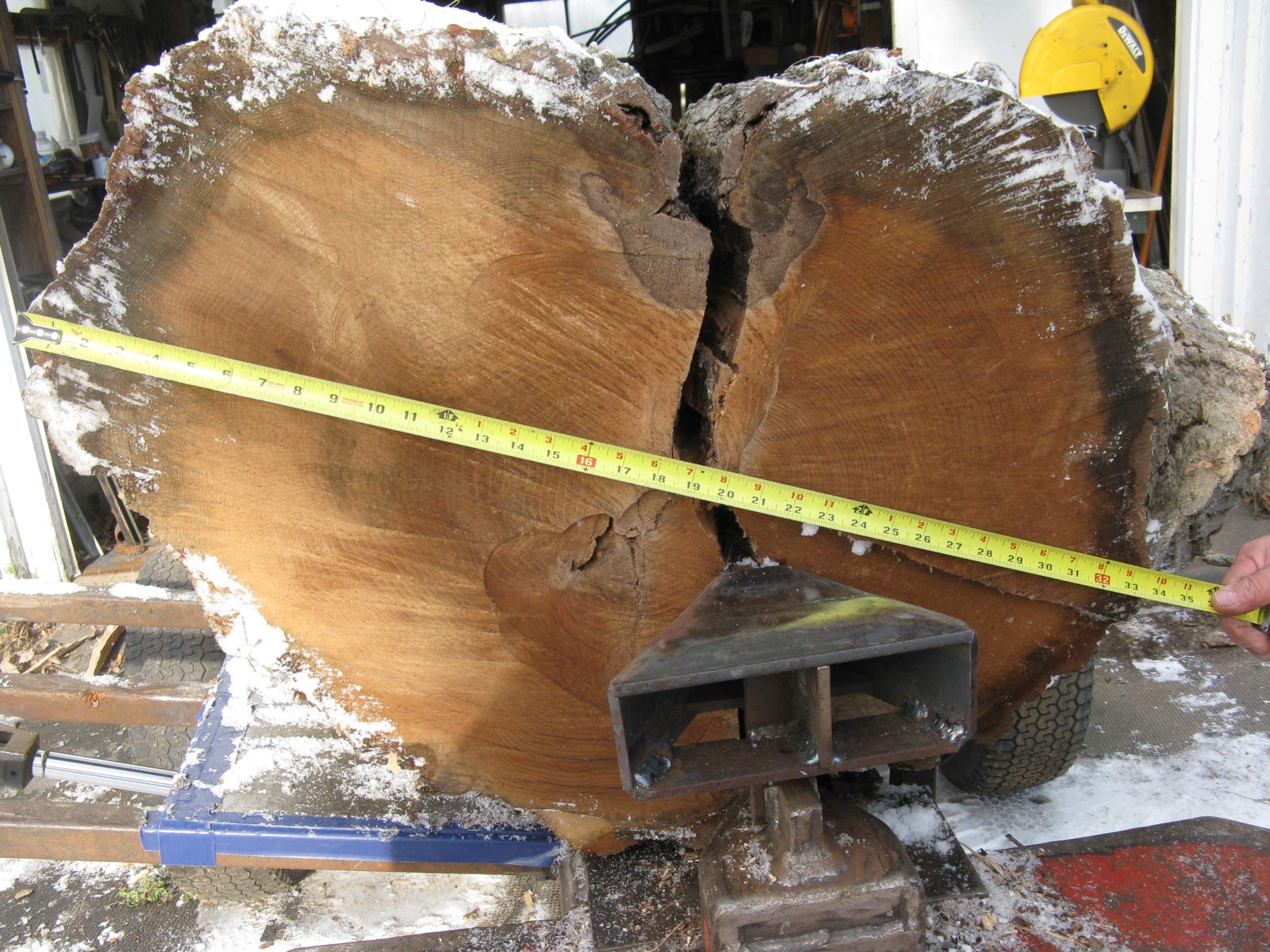

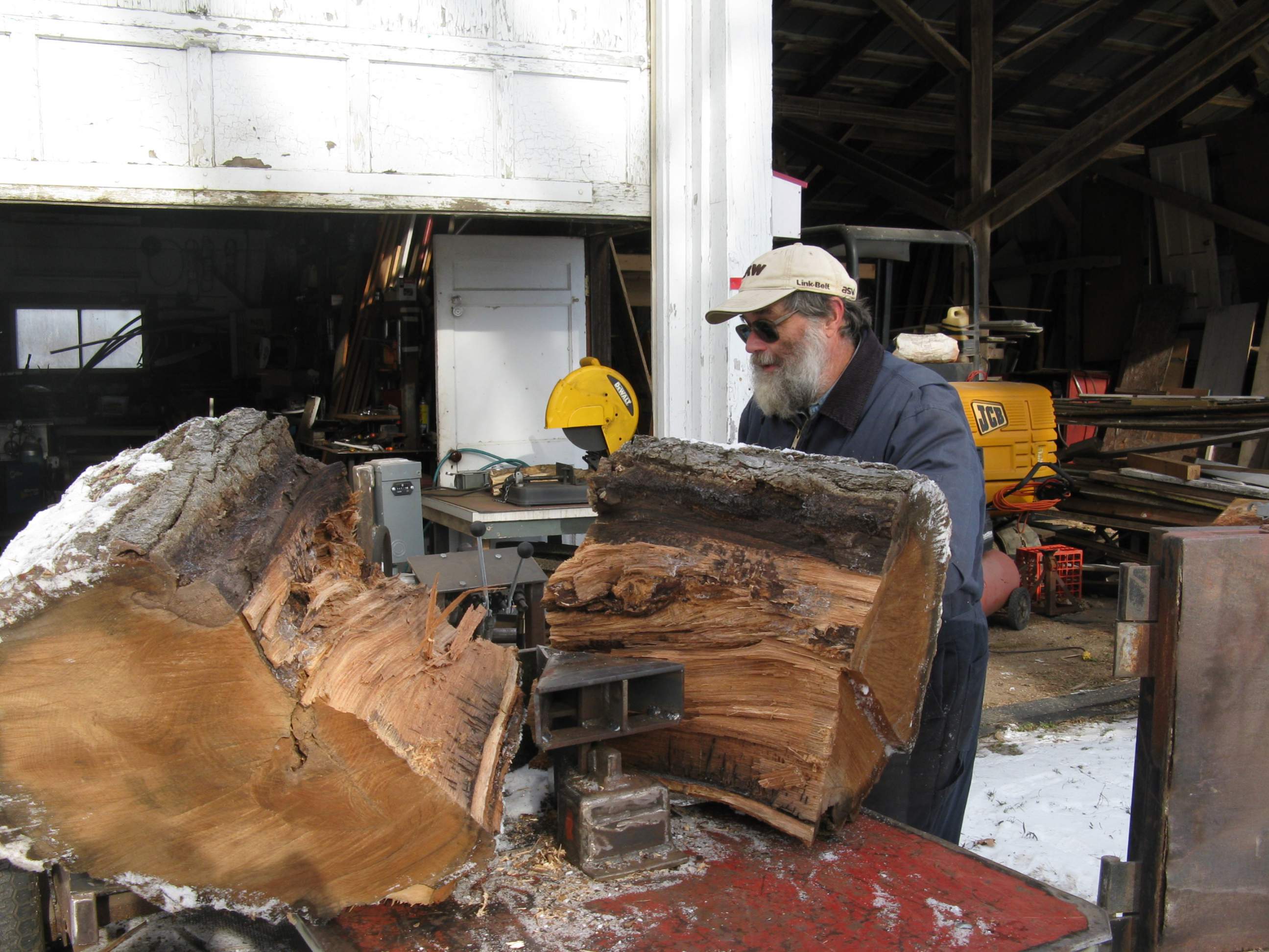

For my large rounds I use a slip on wide wedge. It is 9.5 inches wide at the back.
It worked well splitting this red oak round.
It was wider at the push block end.
It does a good job pushing the two chunks of wood apart.
Split.
/ Logsplitter 2.0 #286
That wedge would require some serious tonnage to push through white elm rounds. Red oak is one of the easiest splittings woods there is.
