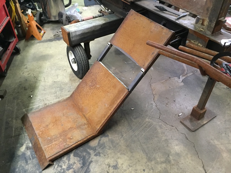

Got the log lift table more or less finished up yesterday ... it ain't real pretty, due to patching in a section in the middle but it should be functional.
Ended up fish plating the arms where I patched in the pieces of square tube with some strips from the shipping crate from the tool gypsy's wood chipper. They aren't real thick (bigger than 1/8", smaller than 3/16") but will hopefully add some strength if I end up working with larger rounds.

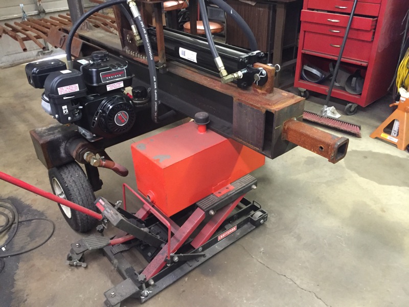

Possible hydraulic capacity upgrade:
If memory serves, the current "tank" has a capacity of around 7 1/2 to 7 3/4 gallons ... which is a little less than ideal for a 13 GPM pump. As practical matter, the actual capacity is even less than that ... because if it's filled too high, the hydraulic fluid leaks out of the filler.
The 10 gallon tank in the picture above would more than double the capacity, and would provide a long path to the pump ... which would be good for getting air bubbles out of the fluid I'd think. Also lots of surface area for cooling.
Would be pretty easy to plumb in ... more work in fabbing up the mount for it.

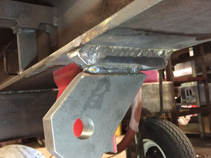

Got the splitter side welded on, do the lift table side after dinner mebbe ...
Root:
/ Logsplitter 2.0
#387
Got the lift table attachment point welded on late this afternoon.
The table doesn't raise as high as I'd like ... not quite enough angle down towards the beam when raised for rounds to roll down on their own.
Fortunately, the cylinder is not fully retracted when it hits the ground (I pried it out a little before I marked the rod end attachment point) and the rod end is threaded and the clevis is run in as far as it will go ... so I can run it out a little further and gain some more angle.
No interference between the table and push block, with the table raised all the way. Will need to recheck that once I adjust the clevis.
Did find out there was interference issue with the vertical knife edge and the push block ... my nice, sharp edge is now a little smushed ... :laughing:
Will need to grind that back a little. Didn't seem to effect it's operation any.
Since it was getting dark and I didn't have the grapple on the tractor, I didn't try any really large rounds. I did split about 20 good size rounds tho ... some sycamore (14" diameter mebbe ?), a few poplar, and a bunch of red oak (10" to 13" ?) ...
Good news is, is that the log lift has absolutely no problem picking up 3 or 4 oak rounds at a time ... these were pretty heavy ... probably had at least 300 - 350 lbs or so on there at least. And the lift isn't too fast ... but I may have the unloader valve on the pump set pretty low.
The 4-way worked great on the oak and poplar ... on the sycamore ... fuggetaboutit ...
Was able to split the sycamore with the fixed vertical wedge though ... but it was workin' ...
Plan to put the grapple on tomorrow and give it a good workout ... mebbe tweak the unloader and the reliefs.
Will grab some pics then.

Got thinking about adjusting the clevis ... not sure that this:
... The table doesn't raise as high as I'd like ... not quite enough angle down towards the beam when raised for rounds to roll down on their own.
Fortunately, the cylinder is not fully retracted when it hits the ground (I pried it out a little before I marked the rod end attachment point) and the rod end is threaded and the clevis is run in as far as it will go ... so I can run it out a little further and gain some more angle. ...
... will actually work ... as both the cylinder and the table travel in a fixed arc ... :confused2:
We'll see ...
/ Logsplitter 2.0 #389
Regardless of the arc of both the cyl and the log lift, it will change the start and stop points of the table travel. Threading out the clevis will cause the table to sit a bit higher off the ground at the bottom and stop a bit higher at the top of the lift. The little bit of retraction you have left in the cyl from your current mounting might let it drop to the ground rather than trying to lift the splitter which is what I presume it would do now if you let it retract all the way.
Can't beat the price of the experiment though :thumbsup:
/ Logsplitter 2.0
#390
That's exactly correct ... if I fully retracted it (before I made the adjustment), it contacted the ground a little and raised that side of the splitter up slightly.
I threaded it out about 1/4" inch and picked up some more angle at the end of the cylinder stoke and I probably still have 3/4 of the threads on the rod engaged in the clevis. When fully retracted the log lift is not quite on the ground ... but if I step on it, it is.
Could still use another couple of degrees tho' ...
That's for sure ... :D
