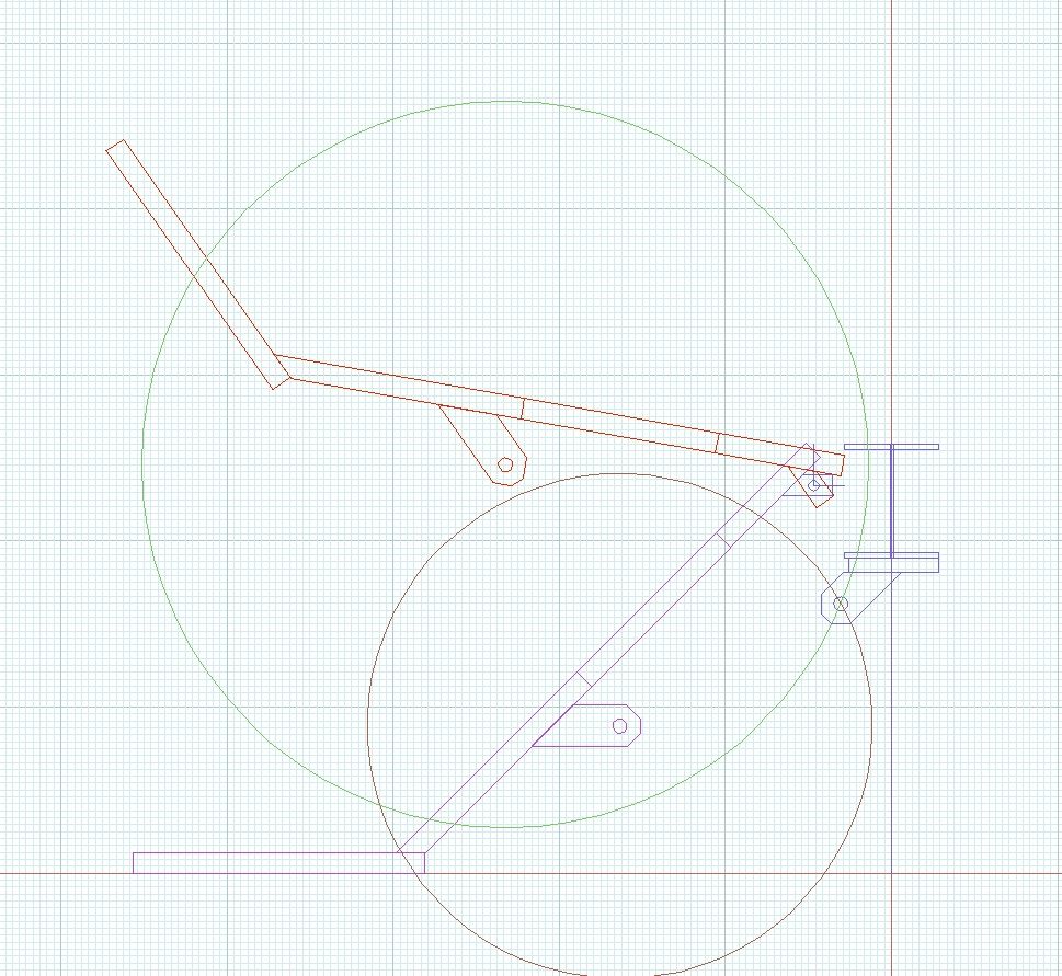

Thought I had the pin locations for the log lift sorted out ... but it turns out not.
So rather than taking one step forward only to have to take two steps back, I got all the dimensions and modeled the parts in my CAD program yesterday and spent a few hours trying to figure it out.
This thing is giving me fits ... could be it's a "you-can't-get-there-from-here" sorta deal ...
I think it's a combination of factors:
1. location chosen for the log lift hinge (arbitrary decision, and not easy to change at this point)
2. stroke length of cylinder being used (arbitrary decision, and not easy to change at this point)
3. log lift being three sections with two angles, rather than two sections with one angle (arbitrary decision, and not easy to change at this point)
The second (top) angle is creating a clearance problem with the cylinder, which prevents getting a decent initial starting angle.
Gonna spend some more time on it here in a bit and see if I can't come up with a solution.

I'm going to redo it as AJ suggested - cut the lift where the vertical section meets the section that is at 45 degrees ... and roll the vertical section back so it's laying at 45 degrees.
I'll have to extend the (new) 45 degree section a little ... to get it to meet the hinges. Hafta see what I have available in the way of steel to accomplish that.
Picture below shows the new design, both lowered and raised ... circles show the retracted and extended lengths of the cylinder, has about 55 degrees of swing in it's current incarnation:
The drawing is scale, major grid = 1', minor grid =1/2"
/ Logsplitter 2.0
#379
LD,
Here's the new dimensions ... if you wouldn't mind running the numbers :D:
AB = 8.75"
BC = 18.25"
AC = 22.312"
AD = 46.812"
I make the initial angle to be 22.1427 degrees ... which should yield 6661 lbs of force @ 2500 psi.
Taking into consideration the leverage, or lack thereof, I get 47.66% (22.312 / 46.812) ... which means I should be to lift around 3130 lbs ...
That sound about right ?

Just checked the odds and ends up in the shop ... should have enough 1 1/2 square tube to extend the lift out on a 45 degree angle and meet the hinge pins.
The piece of 1 x 3 bar stock that I cut and drilled for the base end attachment will work perfect with the current placement ... should still have 1/8" of retraction left after the lift hits the ground.
In comparison to the last drawing I posted, I'll be shortening the ends of the 1 1/2" tubes (that are on a 45 degree angle) at the top ... so that the log lift can be left in the "up" position as the push block travels down the beam. Should have plenty of clearance ... although there will be about a 3" gap between the lift and the beam.
Couple of new dimensions, after a little tweaking:
AB = 9"
BC = 18.125"
Initial angle: 22.8495 degrees ... ?
Cylinder force @ initial angle: 6862 lbs ... ?
Lift, taking leverage into account: 3270 lbs ... ?
