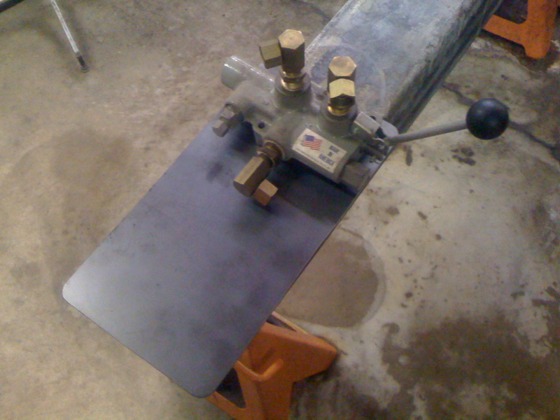

Shot of the table with the valve mounted and some of the hoses fitted:
Really like how it's turning out height-wise ... the top of the beam is about waist/fingertip high for me, and the valve seems like it will be very easy to reach.
I'll be ordering the valve for the log lift and some additional fittings here shortly, after I finish this post.

Why the removable table for the valves? You must be seeing something that I'm not as it won't be able to go very far with the valve attached and plumbed.
/ Logsplitter 2.0
#172
Because I could ... :laughing:
In all seriousness, I just thought it might make getting at the cylinder at some point easier, for one thing.
In order to finish the splitter I am going to have to flip the beam at least one more time ... unless I wanna do overhead welding while on my back on the wedge and the bar that ties it to the top and bottom flanges of the beam.
Being able to remove the table in that instance would be handy.

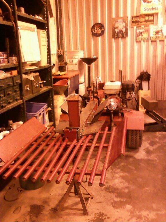

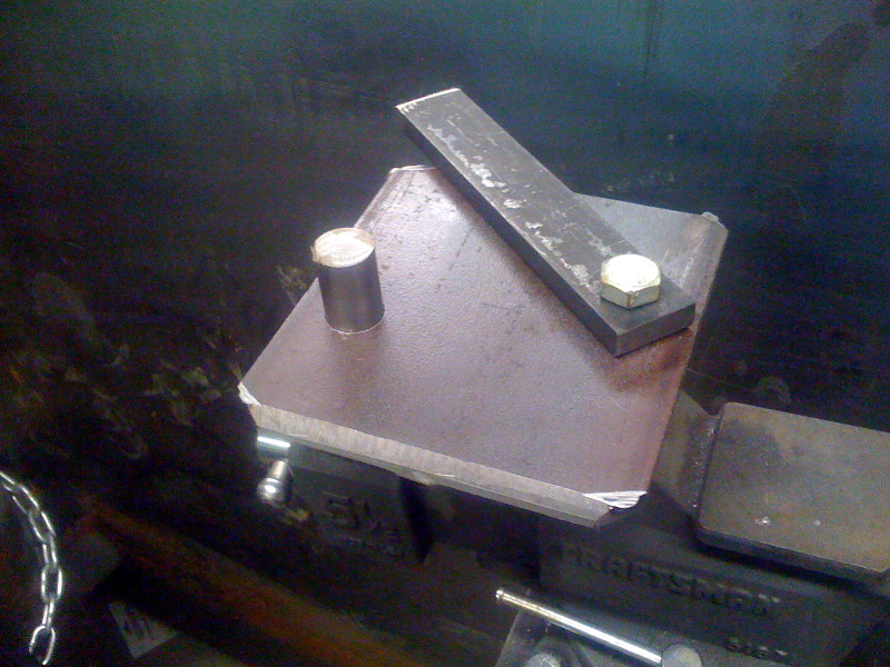

Last night I welded up the top portion of the table grate.
It's mostly 3/4" Schedule 40 pipe, except for the angled pieces that the two side rails sit on ... I made those by taking some 3/4" hot roll solid round and heating them up with the o/a torch and bending them in the vise:
Still have some bends to make on the pipe ... but I won't do that until I have the bottom mount for the table grate done and the entire thing mounted in place.
