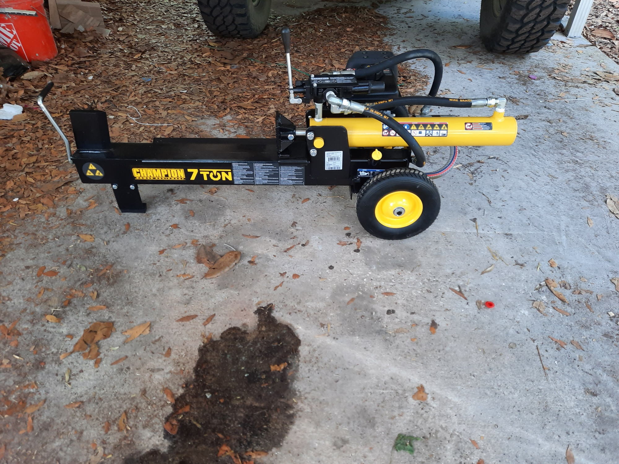

I use a stand alone. It seems they don’t cost anymore than a 3 point setup. Mine was pretty inexpensive and it is horizontal only, I wish it went vertical also. It’s easier to get large rounds in it f it’s vertical. I either lift large rounds up to it with my tractor or cut them in half first. I think mine was about $700 about 15 years ago and prices haven’t gone up much.
