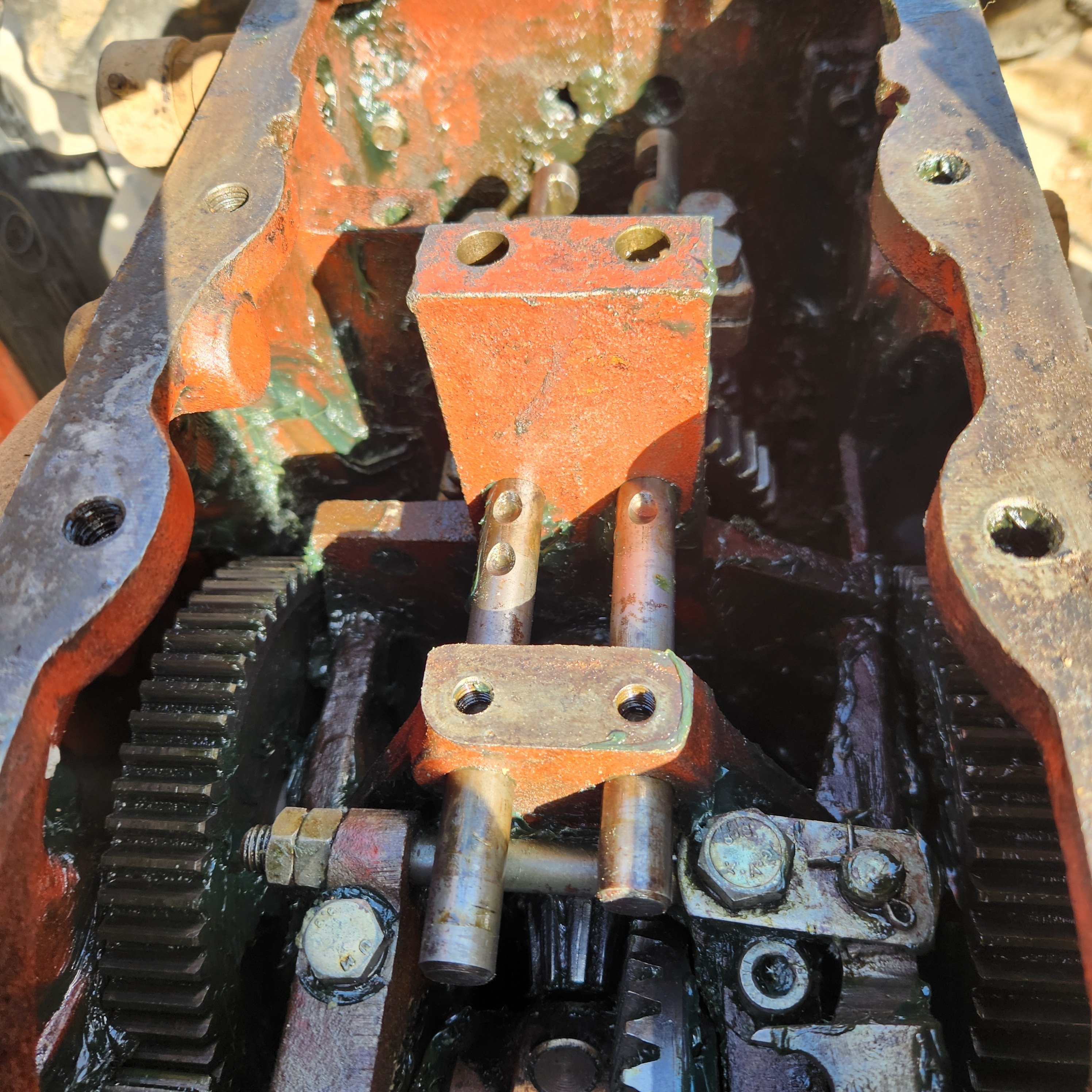

Most of the mentioned parts i dont know what us it but i will open the top cover and i will share photos for all parts soon here to get any advice .thx for your support for now 😊
   / Lombardini small 4wd tractor spinning wheel
#12

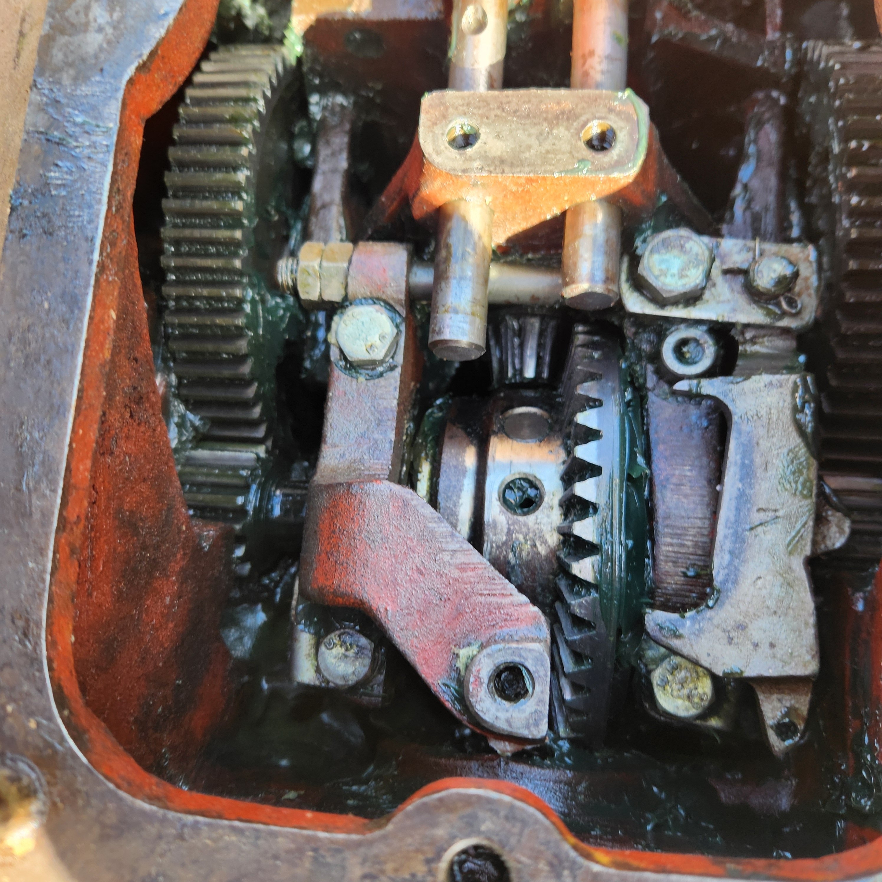

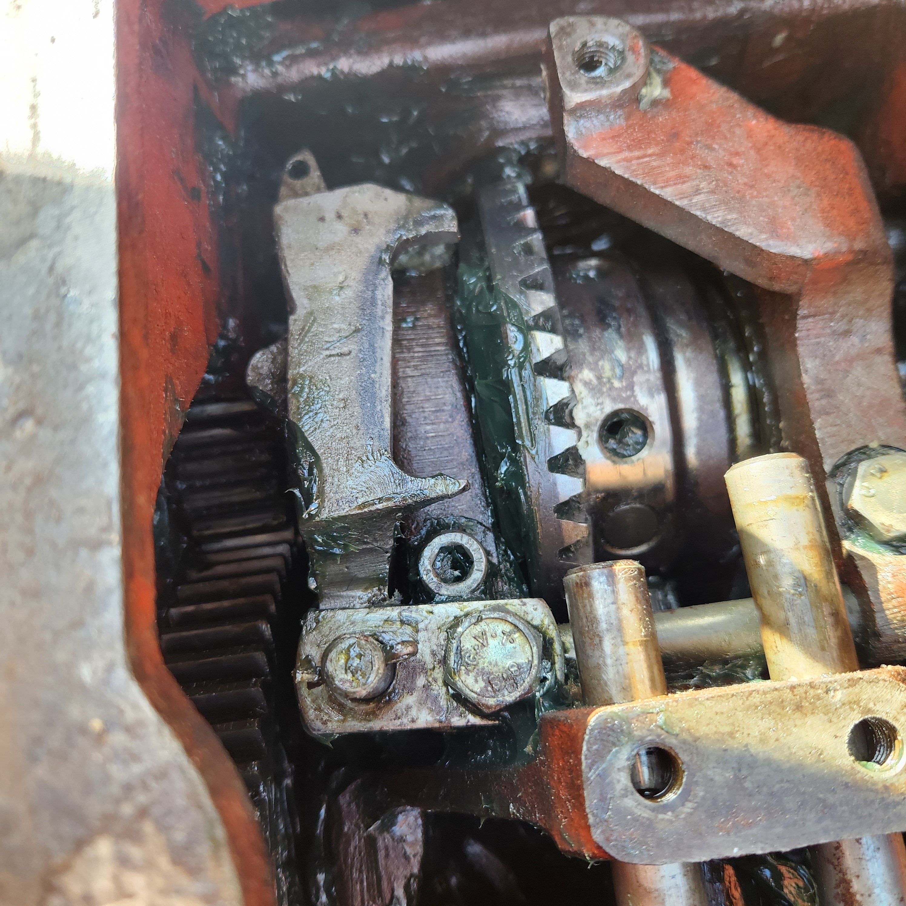

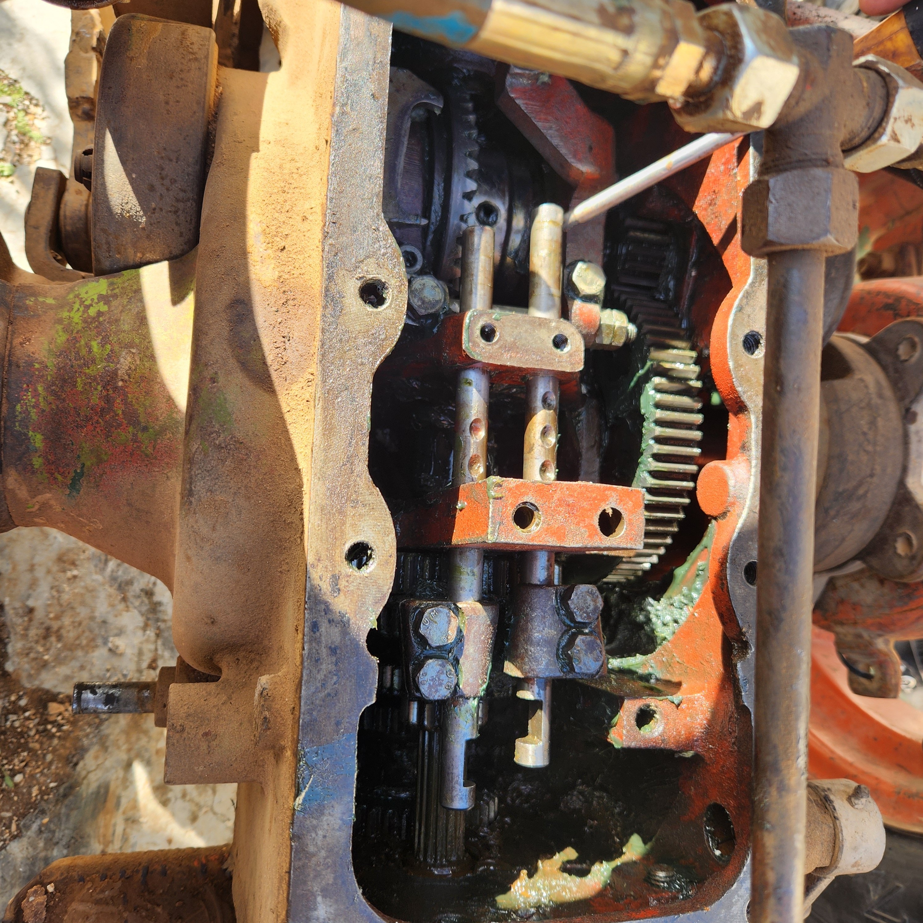

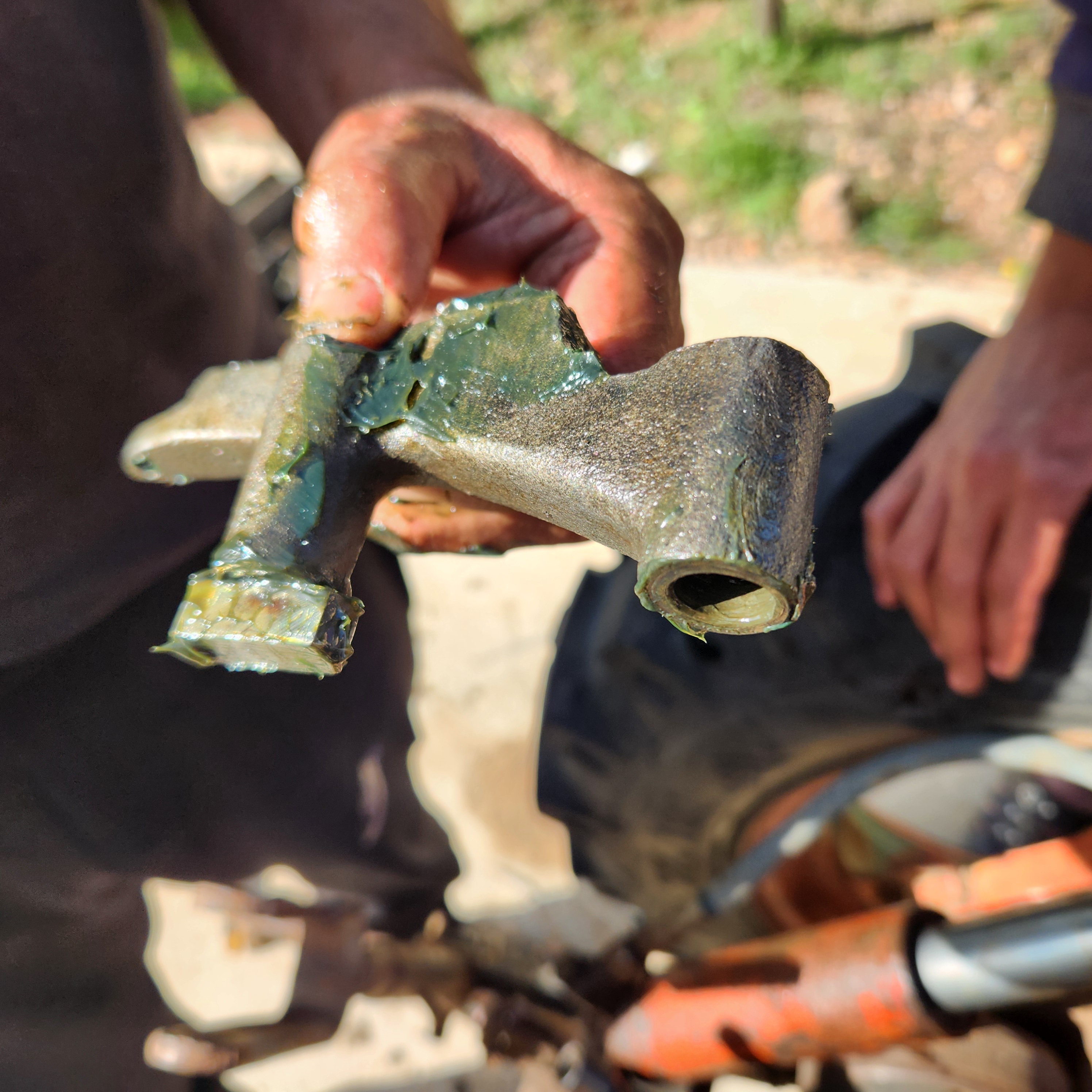

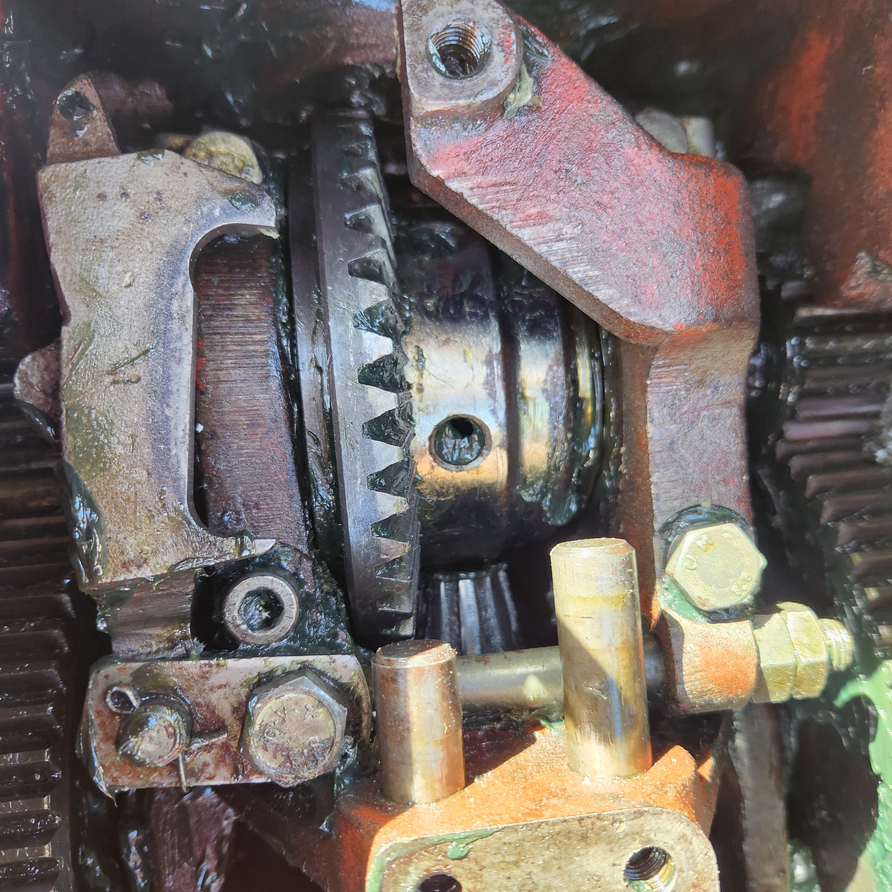

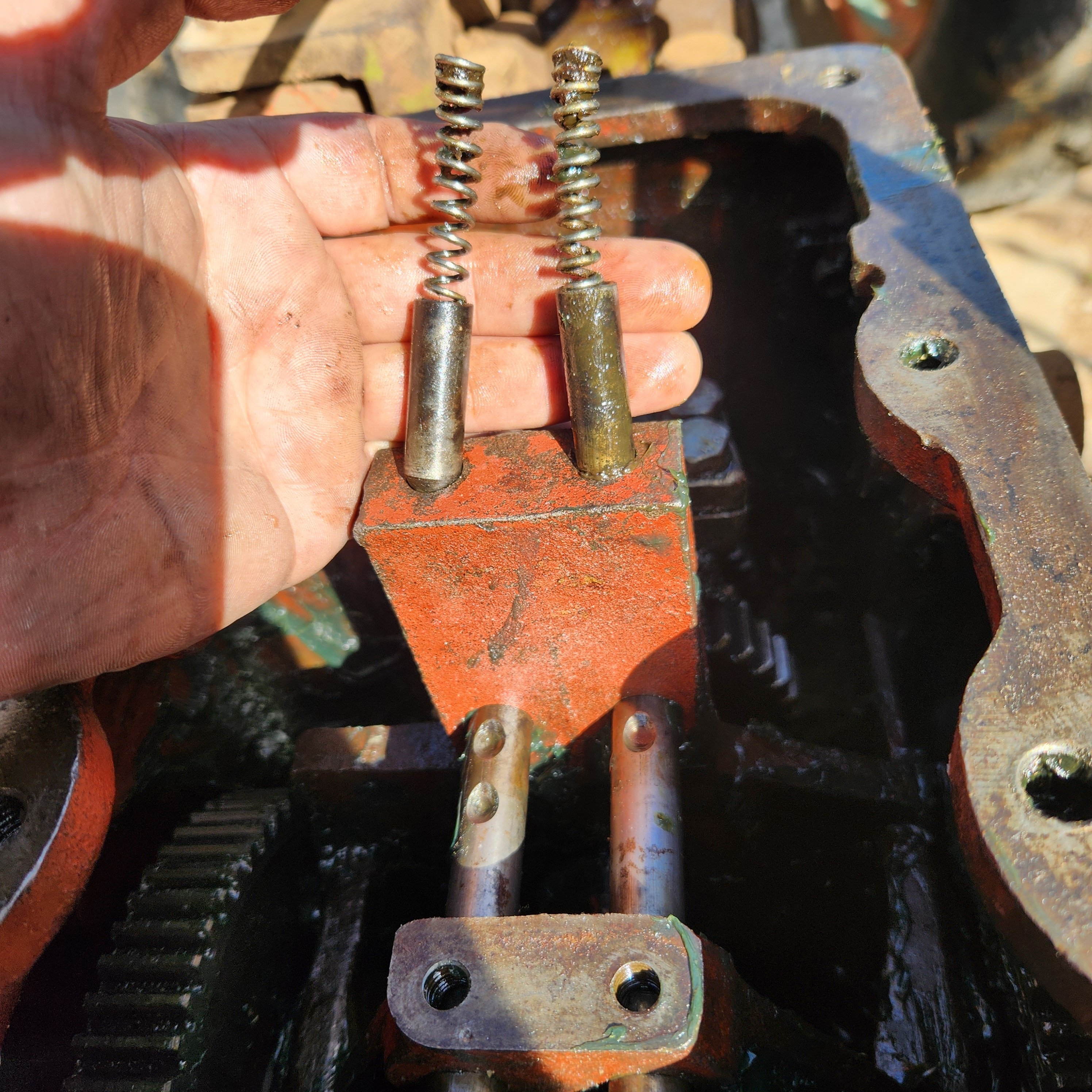

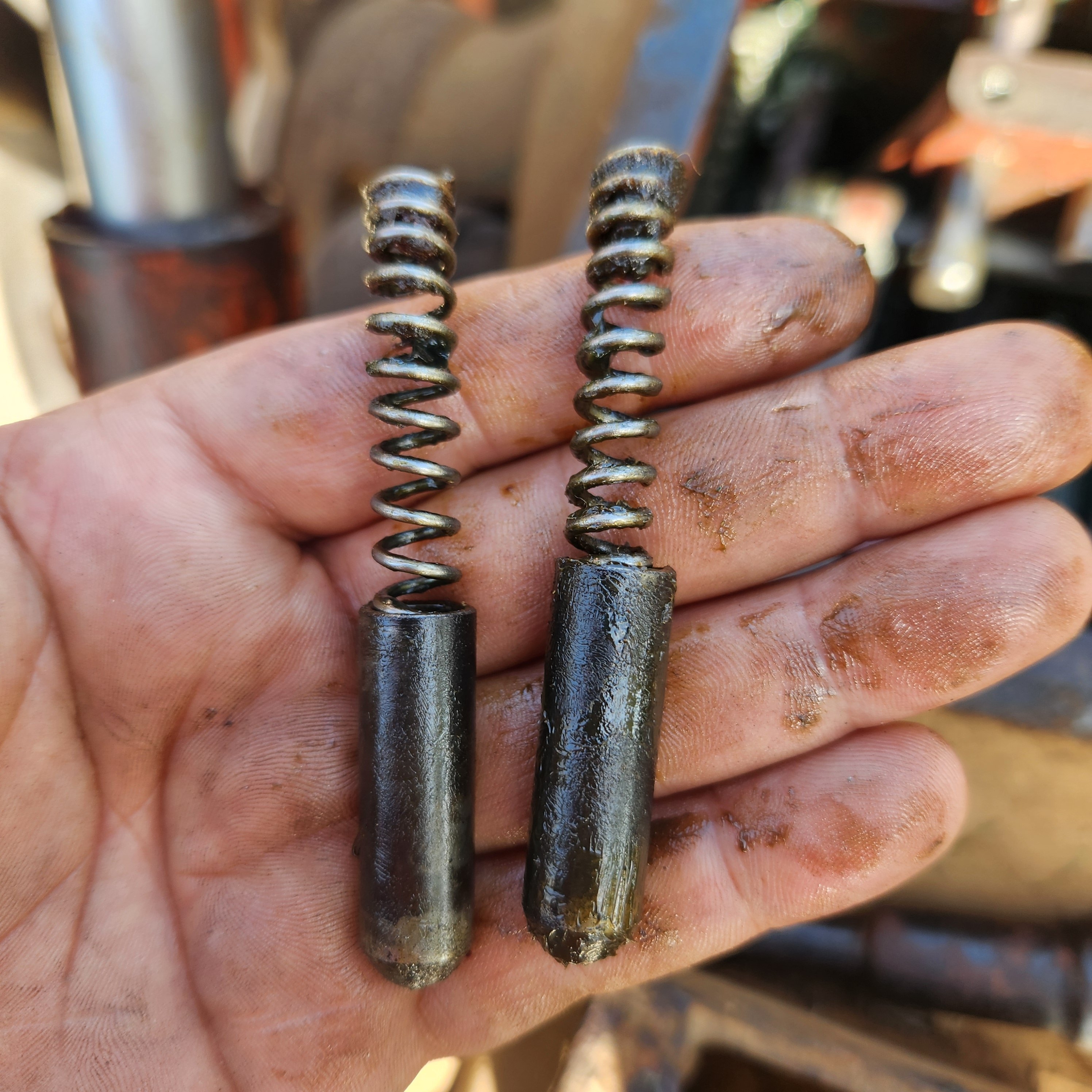

Hi Mr.ptsg
Im near to the tractor .it eill be appreciated if you give me your face book address or messenger its easy to share phots and video .
by the way we opended the top cover we found no oil there but it filled with greas and i think since long time it happen .
All gears teeths from where we can see inside seems ok.no broken teeths
But in your photo you shared there 2 wholes with minuse head to fix to spring with head in top to catch the 2 rods when we change the gear postion fron 1 to 2,3 etc
In our tractor when you remove the top cover these 2 springs comes out and there is no covers for it
And i want to ask when we fix the rods what the correct postions for these rods wholes to be sure it in nutrsl not in the first or seconed or fourth speed .
thanks in advance
I will share some of photos if it will help

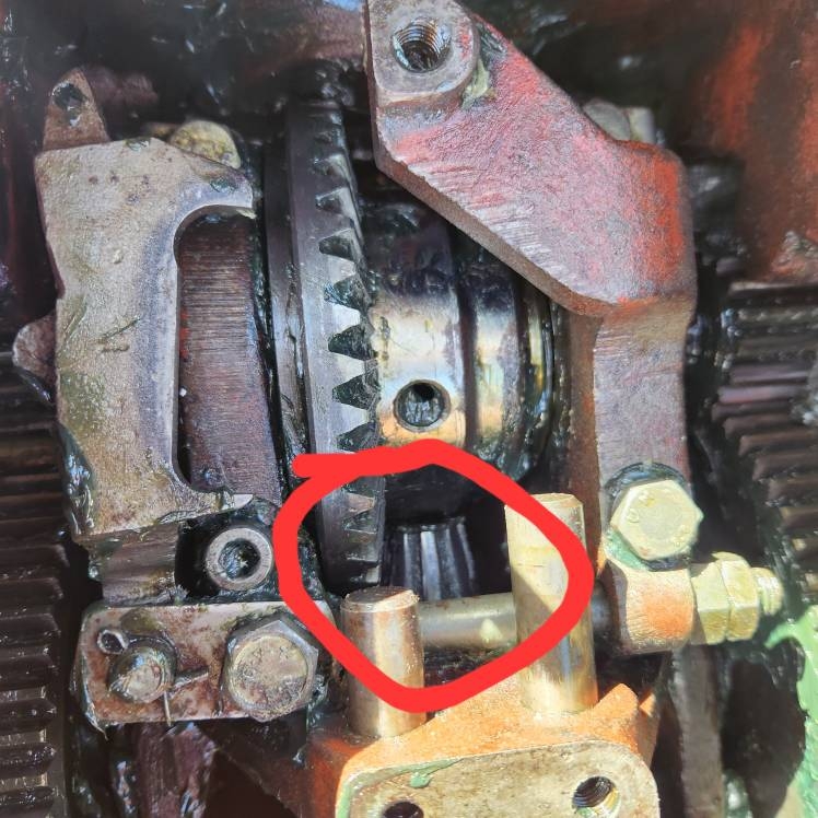

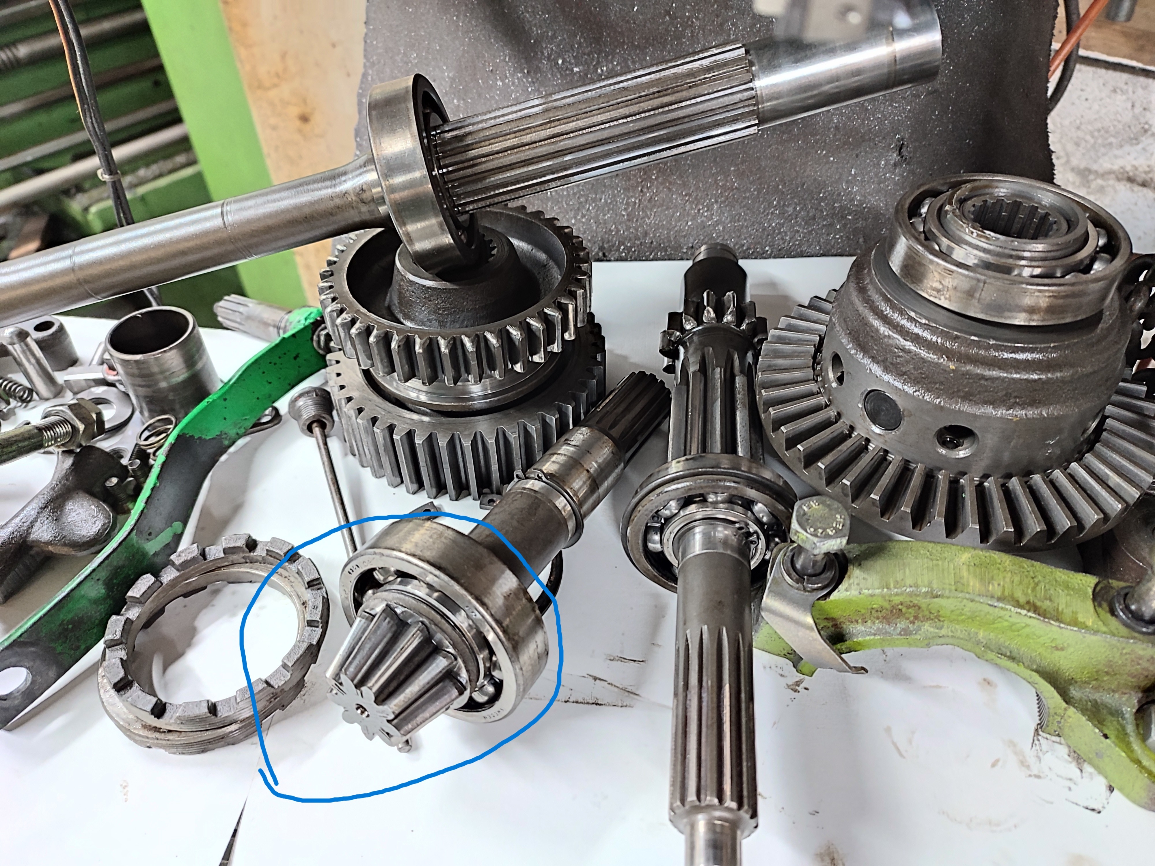

It is hard to tell from the picture, but is the pinion gear completely worn out? See circled gear.
   / Lombardini small 4wd tractor spinning wheel #15

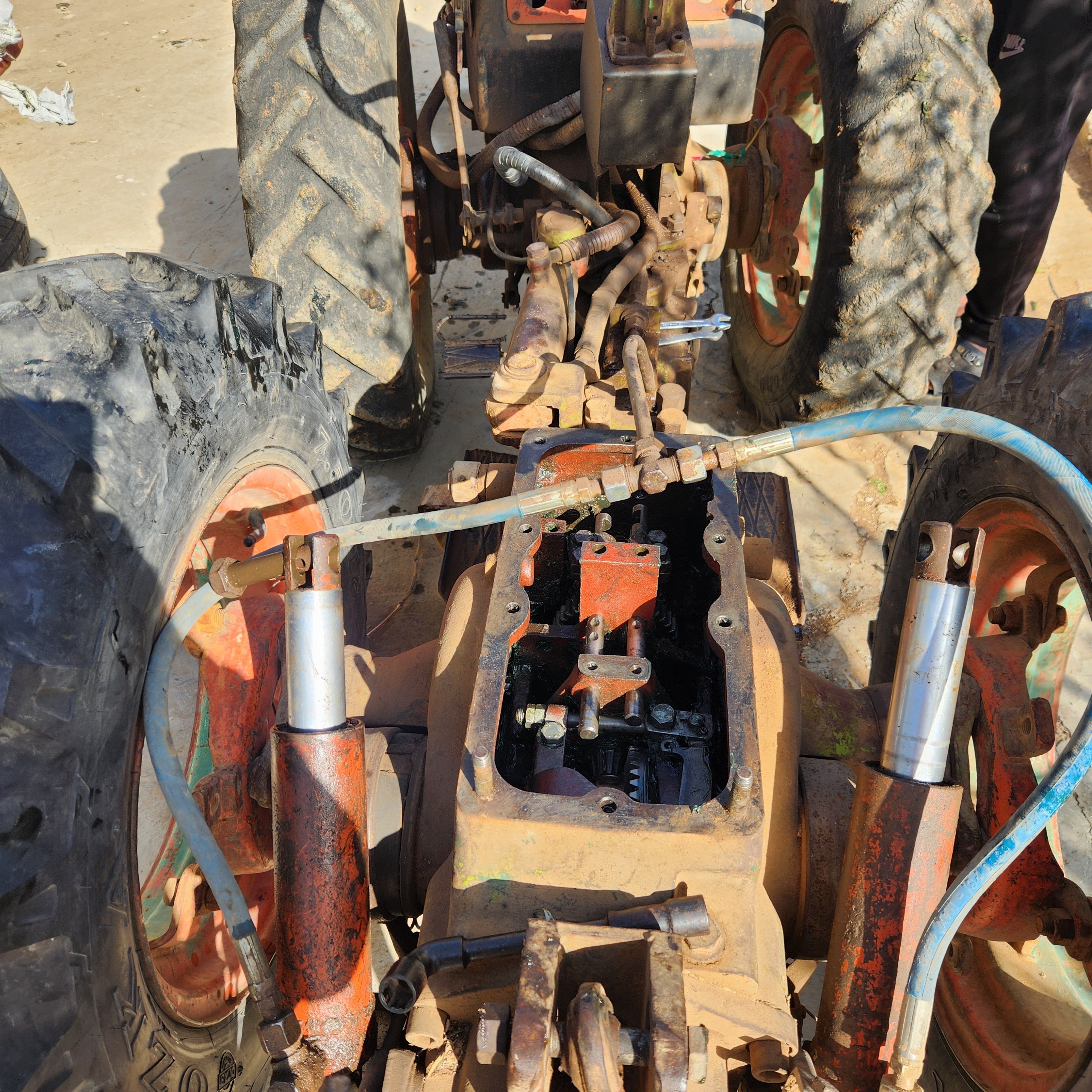

If you disengage/take it out of 4Wd does the tractor move at all? Does it try to pull the plow?
By the video it looks like only the front wheels are turning. When you plow the front end is lighter/and or may be the only wheels pulling.

Hello alaaahmad,
Thank you for the pictures. As far as those springs, don't worry, the top cover is what holds them in place.
The pinion shaft is completely stripped as TGMT pointed out. Not teeth left. Most likely due to lack of the proper oil. Should have 80W90 oil.
I suggest that you find a mechanic because right now, everything inside that gearbox needs to come out as the pinion shaft is the last one to be removed.
This is a picture from the gears from the front gearbox but it has the same ring and pinion setup. Inside the blue circle is the pinion gear and how it should look with the teeth in good condition.
