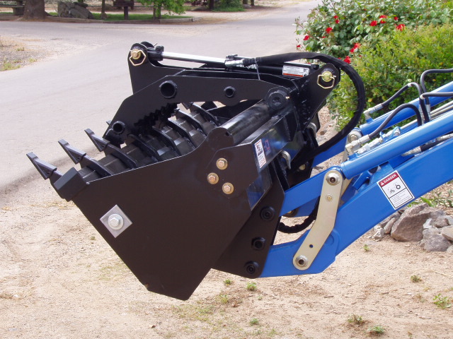

Use 3/8 hose until you get to where you plug in the grapple. Then use 1/4 in hose to the grapple.

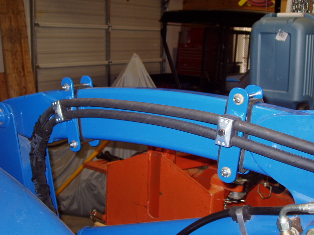

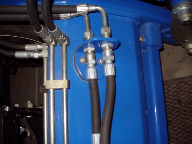

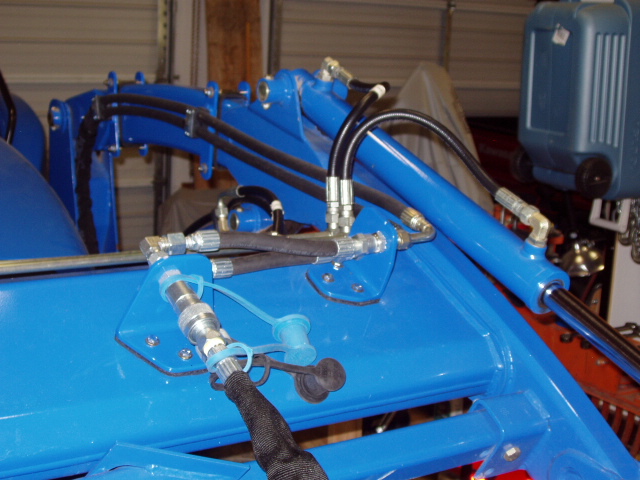

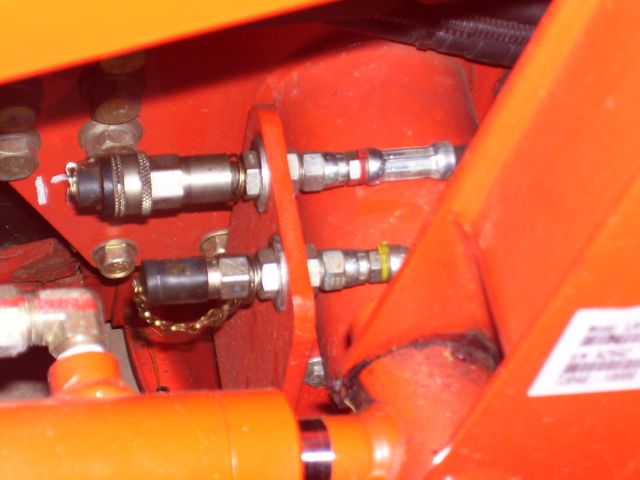

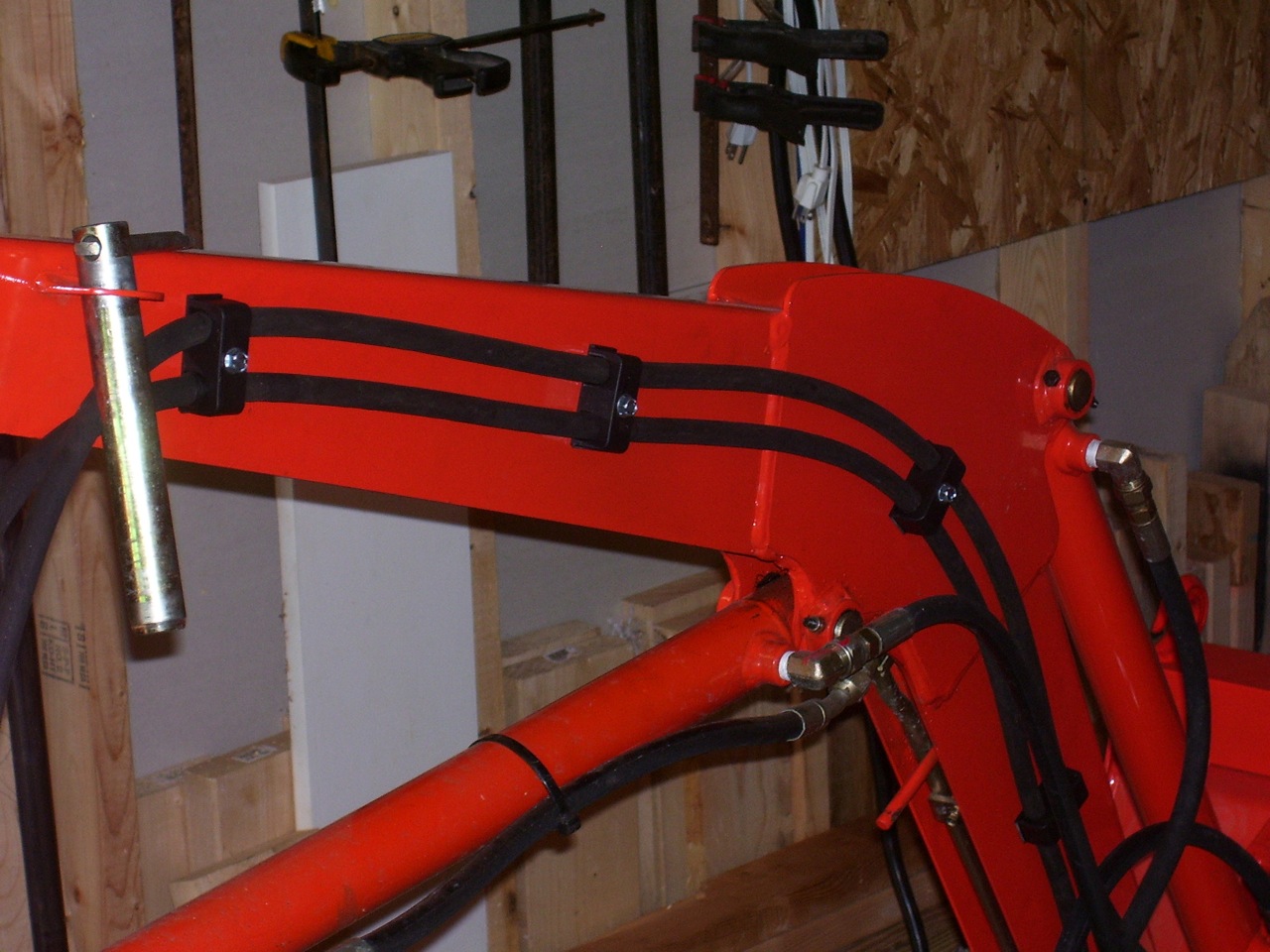

Artisan, here are a couple of photos showing how I ran the lines from the REAR remotes to the front for angling my snowplow. Of course yours will be from the valve body. The first two photos are the disconnects that are used when I take the loader off. Followed by the 3rd photo showing the lines running down the loader arm, and the 4th terminating at the bulkhead connections (I think that is what these are called) at the front of the loader arms. Hope this helps. Keep up the good work. Stanley

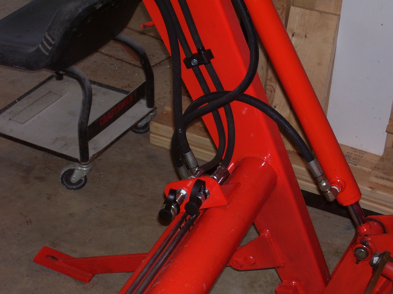

Here are a few shots that I've posted before. Just some examples of my home made "L" brackets cut from 3"x4"x1/4" angle stock used to make 90 degree turns for the 1/2" bulkhead fittings, 3/8" hose spacers down the loader arm and hose slack for the bucket curl. Assuming your FEL detaches, you'll need a QC upstream from that attachment point with an "S" hose curve similar to your FEL hose curve and at least one more close to and before the grapple itself in case you just want to take the detachable grapple off of the bucket for digging purposes or whatever.
Your work looks very clean so spending a few more bucks on hydraulic QC fittings (check out your local TSC) isn't going to be life altering and should last if properly cared for, the life of the tractor.

Nice Job Nickleplate, the nylon sleeve adds a nice touch too..:thumbsup:
   / Long Hydraulic Hose Routing Question... #15
Thanks for the pix Nickel Plate I have to secure my lines as well :thumbsup: those brackets are nicely finished .

Hacksaw, grinder, file and a NH rattle can. Thanks for your comment, a lot of shop hours in three of those brackets and backing plates. The one at the loader dock (pictured) has some complex angles for fitment purposes.

And man, are they expensive but designed to take the shock and pressure of a blown hose. I have them for the hoses that run from the RRs and under the tractor to the FEL dock, the "S" flex at the loader arm and the flex area from the torque tube to the grapple cylinder. Thank you for the comment.
