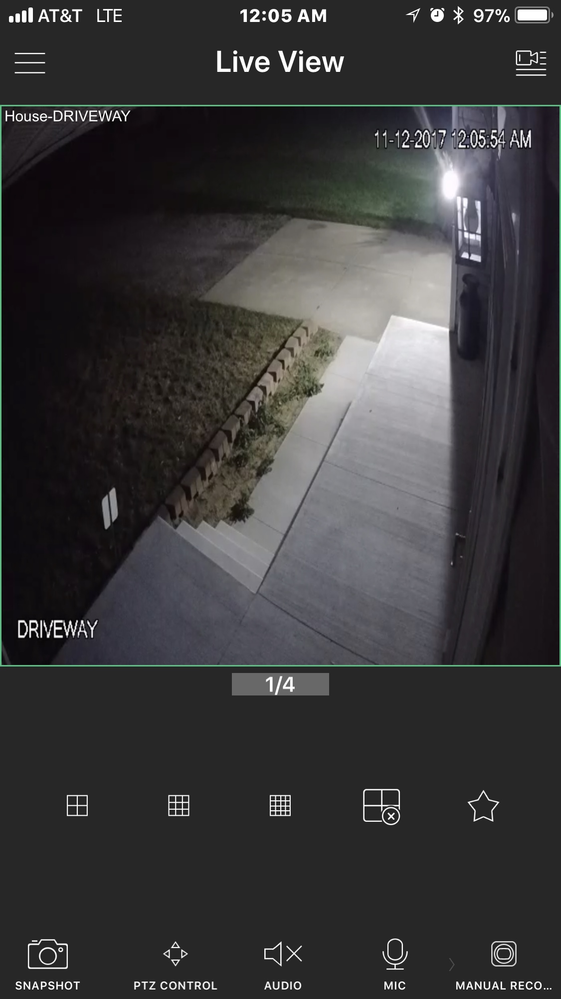

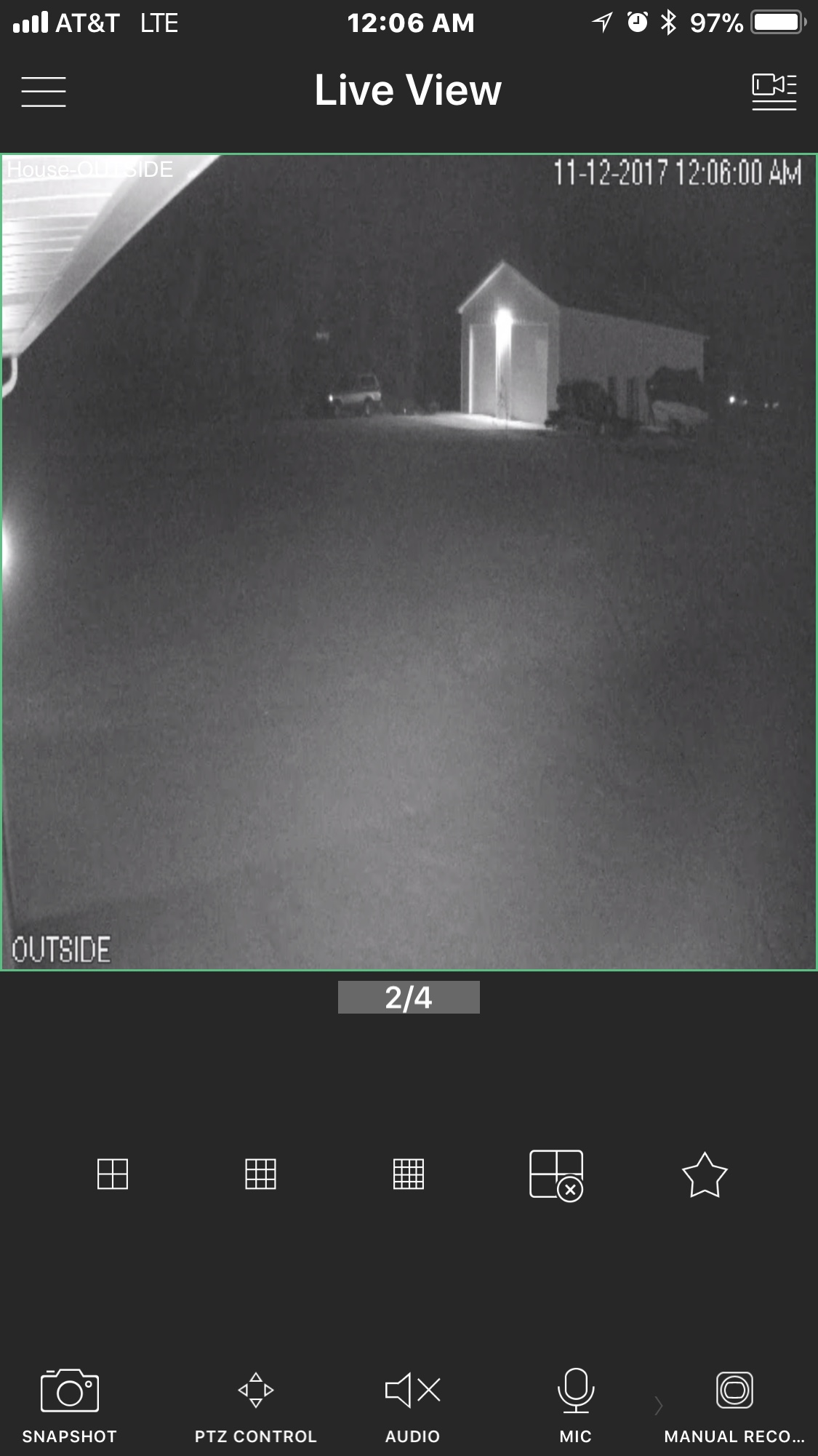

I have a wired system am also installing 2 more cameras at the barn tomorrow. I might do wireless the next go around. Technology is improving so much.

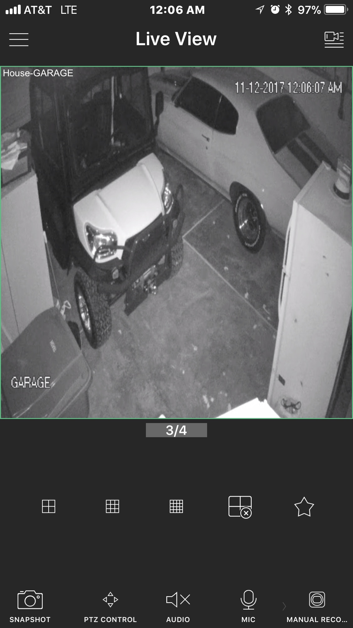

A buddy of mine turned me onto Reolink cameras. He's had his for a couple years now. I just bought a RLC-410, 4MP/1440p, POE, Mic, IP66 housing and motion detection . Decent picture and pretty good pricing $55. They have a couple wifi battery operated ones, one for indoors and another for outdoors, but i have no personal experience.
