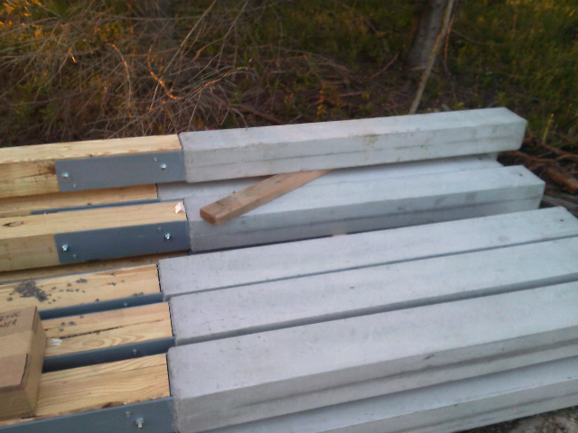

I did get a couple pleasant surprises yesterday. The trusses were delivered, as were the Perma-Column posts.

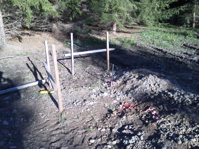

Corners squared and batter boards up.

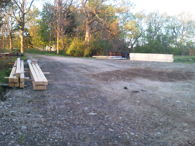

Staging of materials
Close up of Perma-Column.

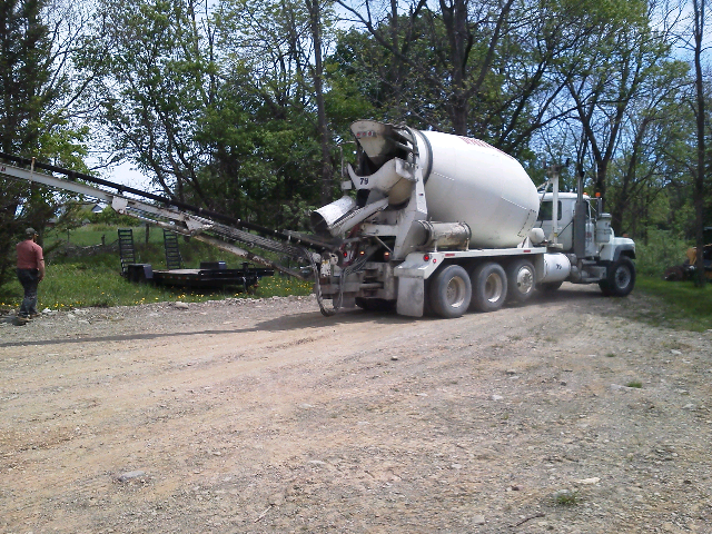

Got inspection of holes out of the way early this morning. Guy was happy and very good to work with. Signed off on the holes.
This afternoon my cousin and I poured the footers. I was originally going to use 80lb bags with my mixer. Found for same money I could get ready-mix in a conveyor truck.
I chose the latter. We were done in 30 minutes. Tomorrow we are setting the Perma-Columns.

Wow, that's great progress. I was surprised to see the perma-columns were shipped pre-assembled. Hadn't thought of that way. But that makes sense for pole positioning and labor saving.
