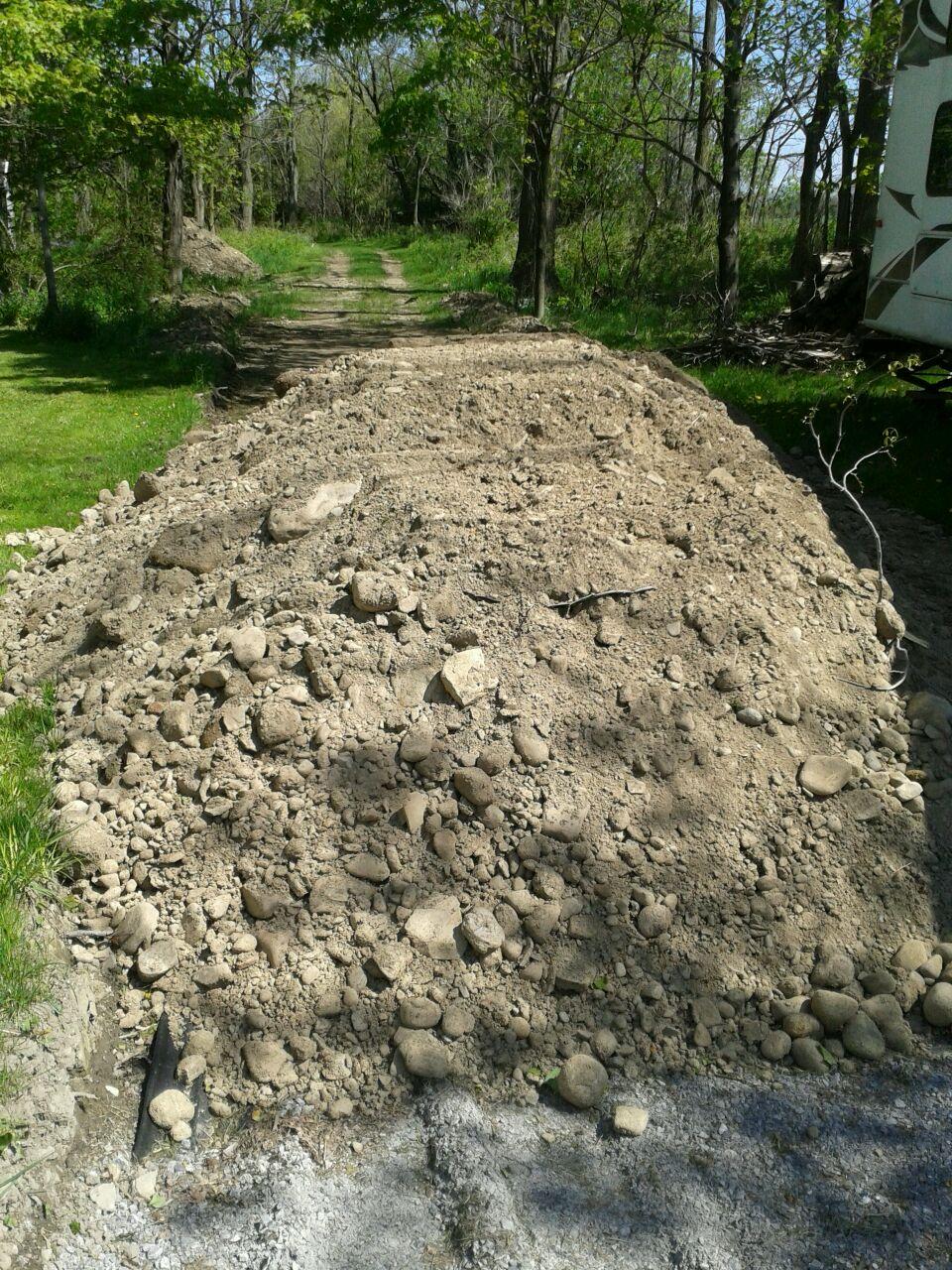

Was out at the property this past week for a couple days. I had two loads of bank run gravel delivered before I got there, so I got some seat time on the 5530 spreading it out. Here are some pictures. I decided to go with the bank run strictly because of cost. Doing 500' of driveway in crushed limestone is just not in the budget. The gentlemen I get my bank run from provide us with a very good product, it really packs immediately and very stable. There are some over size stones to deal with but at 40% of the cost of crusher run I can deal with them. When it is all done I will top it with 3-4" of the crusher run top dress it up.
I also picked up a 7' landscape rake from Tractor Supply to help grade the bank run. It did well, although I decided to fabricate a hydraulic angle for it. I quickly got tired of climbing off and on the tractor every time it wanted to change it. As soon as I get some pictures of the rake I will post them.

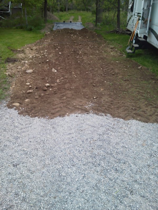

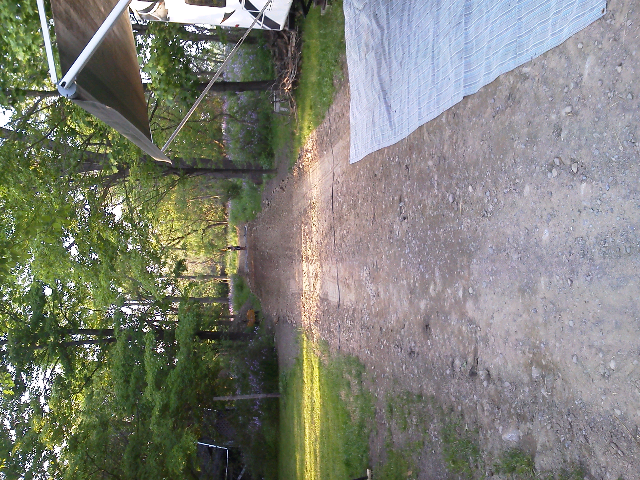

Two more loads of gravel graded, spoils from driveway dig out spread around pond birm to widen it and lessen the slope. Driveway is now 175' off the road. Also managed to bend my landscape rake yesterday, so I spent an hour trying to disassemble and figure out a fix.
