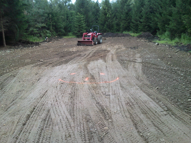

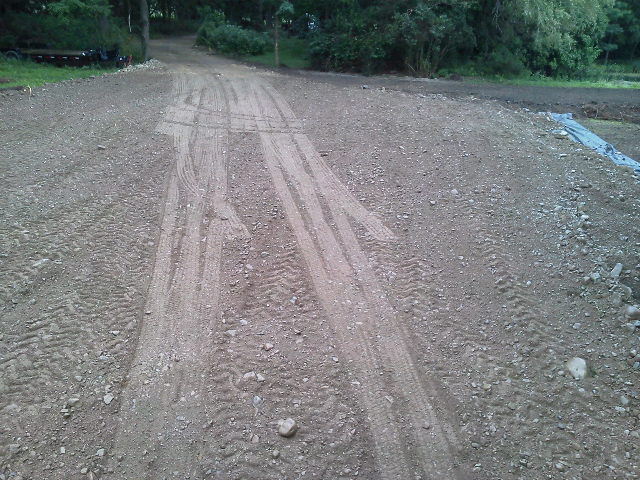

Ok, got 13 of the 20 loads of gravel that I ordered. Apparently when the guys got to the pit this morning the main loader wouldn't start. So they used the other loader while the mechanics worked on the main one. It wasn't until 2:00 that they got it fixed and boy could I tell the difference. The main loader takes 1 1/2 buckets to fill triaxle, the other one takes 5 buckets. They cut the turn around time from 35 minutes down to 20, big difference. We probably could have finished today had the main loader been up all day. That's ok though just means more seat time in the a.m. Here's a picture of today's work all done by the Mahindra 5530.
   / Long road to home.
#43

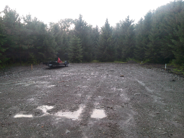

Seven loads finished off the driveway base exactly. Glad to have that behind me. Wife wants me to move camper back there now. Only thing is we will lose our electric hook up doing that. I have a generator, just don't know that I want to listen to it run. Next weekend I am hoping to remember the laser so I can shoot some elevations for the pole barn pad.

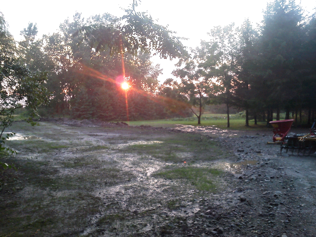

A couple updates, food plots are in. Then I spent the afternoon cleaning up the last of the topsoil around the driveway that I left last week. We had a torrential rainfall this evening and the gravel did well, minimal run off.
I shot some elevations for the pole barn pad with the laser transit. I am going to need another 10 loads to raise it up a foot and then level the site. I am thinking about using screened gravel for the pad, it will make it easier to get a good grade with the smaller stones.
Thanks again for following our progress.
Here is another picture I took tonight, I just happened to be in the right place at the right time for once!

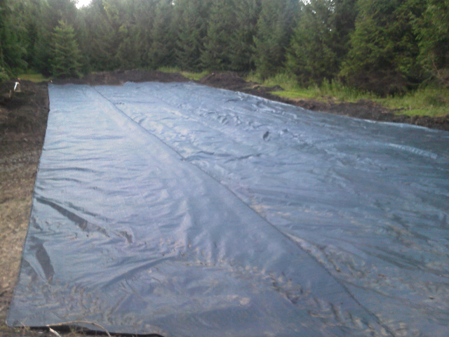

   / Long road to home. #47
Great thread. Just read it all for first time. I know about what a bummer it is to close up shop for the winter. I try to get up several times in the winter, but it is rather inconvenient when you have the trailer all winterized, then try to use it. I have also hauled so many truckloads of limestone that I lost count. My drive is about 900 ft and it was a lot of work removing all that topsoil. I was well into it before I had heard of fabric, so I never used any. It has been holding up well though.

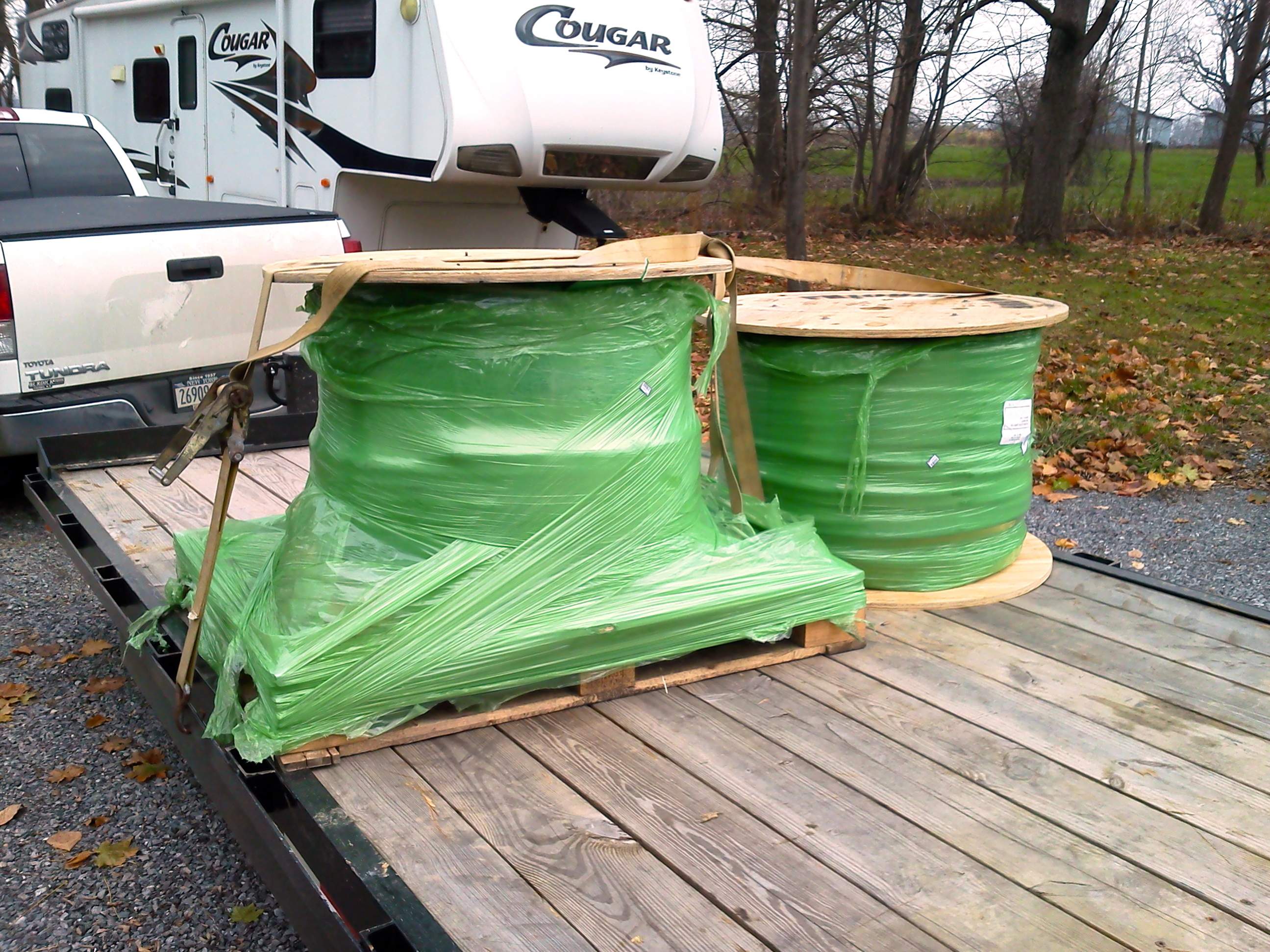

Got the call from the supply house primary wire is in, that was quick. My neighbor and I got up and on the road at 6am this morning to go to the property. We had to unload the implements off the trailer and get to the supply house and return to the farm by 12:30 to meet the electrician at 1. We were taking the trailer because the supply house said the spools wouldn't fit in my Tundra's bed. Well, once we got there and got turned around in the small parking lot they brought out the spools on a forklift. Guess what....they would have fit in the bed of the truck, easily. We put them on the trailer anyway since it was there.
Got back to the farm in time to unload the spools, reload the tractor implements onto the trailer, and back it into the garage for the winter, again. After a great lunch at a local diner we met the electrician. He was down to earth and straight forward with his ideas. Best part is he is willing to oversee the work and let me do most of the labor, best thing I've heard all week. Still waiting for the power company to give me a firm quote on their portion. I will have to drive a piece of 4" conduit under the 24" culvert since there is not enough fill above it to be 30" below grade, at least I get to play with an excavator!
Has anyone ever tried to drive a conduit through the ground?
