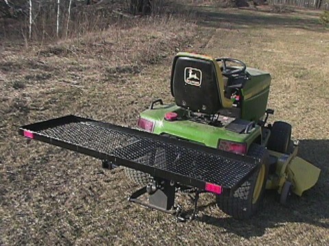

I ended up getting a low hour used JD 455 diesel 60" lawn tractor Also has a 3 point hitch (cat 0) which allows multitasking - moving trailers, fixing roadway, cleaning up - smoothing lawns with various attachments, etc. Even used as a mobile workbench to carry tools around my acreage. /forums/images/graemlins/grin.gif
