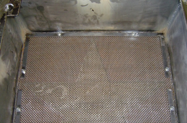

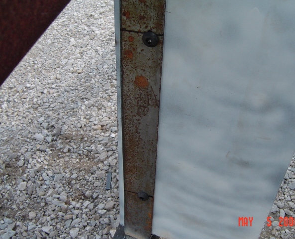

Here is a picture or the screen installed. I cut the head off of the bolts, drilled holes in the plate and welded in place. It was to hard to weld from inside and welding on the outside works better in allowing the screen to lay flat.

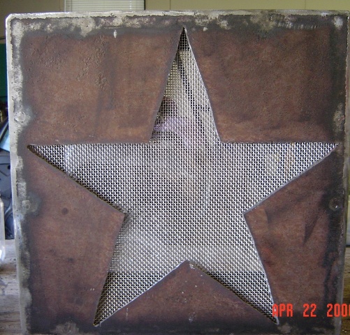

After grinding and polishing the bolts down the box is now complete. Time for a test drive picture is a little blurry. Sorry I can't find my pictures of the light installed. Its just a 150watt halogen light. It tryed several others but the halogen gave me the more light for the size. The inside of the box Rustolum gloss white so it reflects the light well.

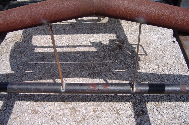

And final picture for today is pictures of the mounting to the arch top section. I used a hex drive pan head bolt to keep it from being so noticable from the ground.

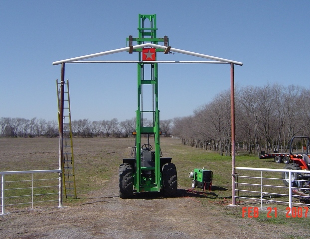

#44

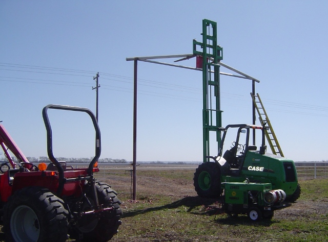

Time for the final batch of pictures. This batch is of hanging the arch top. My Massy wasn't up for the challange. I had to rent an all terrain fork lift and a larger welder for the job. Arch is 15ft 8inches to the bottom cross pipe.
James

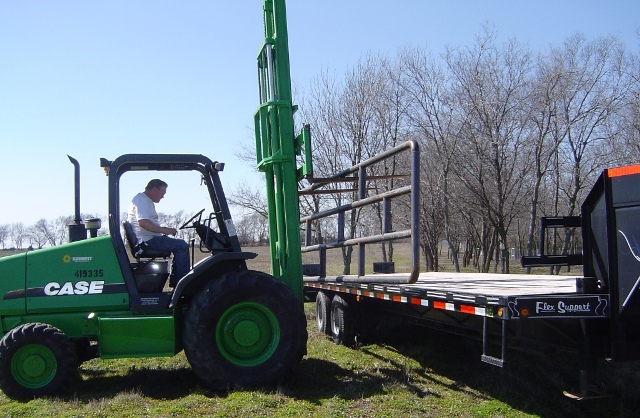

#46

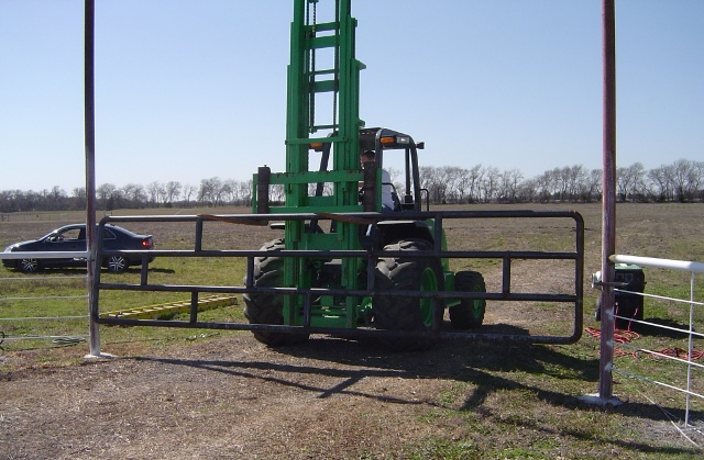

Time to hang the gate. Its 18ft wide and built with sched 10 2 7/8in od pipe. The gates weight is probably around 200lbs but with the 18ft length its got a lot of leverage on it. The hinges are rates at 2000lbs. Should hold nicely.
James

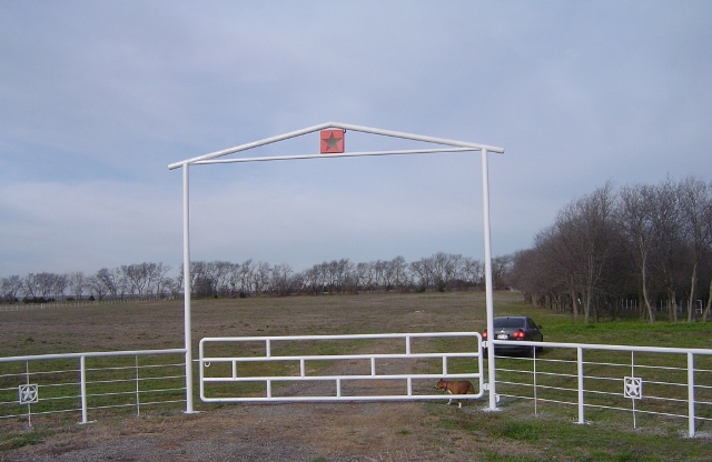

#47

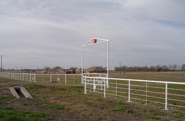

Project done! All painted and ready for power. The latch side was about 2 inchs short. Not sure how that happened but it still worked out. I used the famous Harvey horse shoe latching system.
James

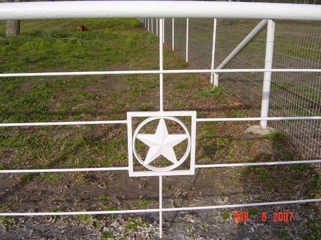

#50
Here is the mockup picture of what I wanted the gate to look like. The picture is kind of tilted. Standing on the trailer and taking it didn't work out so well. It would have had the Texas cut out of plate and the circle would have been the same 2 7/8inch od pipe.
James
