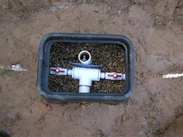

3rrl, good idea and they are part of the assembly under the box. (see attachment) The brass/stainless steel is the better shutoff and I might replace them later. there is also another cut-off at the house 10 feet away and at the barn so the PVC usually aways stay open.
The bad news: I now have another leak.
The good news: it is small, and I know where it is.
You were right Eddie those unions are cr$%p.
I went to the local Ace Hardware store and got a different type of union that all the people around here use because they work so good and are easy to install. It is PVC but there are no threads to tighten to hold the connection like the one on there now. It can expand and contract so the glued connections do not break.
I will find out tomorrow if it works.
Jim I did not see your post earlier. Lesson learned. When I connected the backhoe I told Karen that I am either going to find the leak or make one. Since I would have had to go to the store either way I took the chance. The big lesson I learned is if I don't have repair materials on hand do not work past 4 P.M. I could have saved about 40 miles of driving and would not have had to work in the dark.

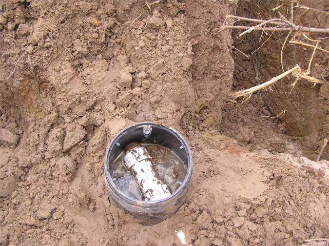

Here is a picture 2 days after installing a compression screw type 2" union on a long line. There was absolutely no leak the first day.

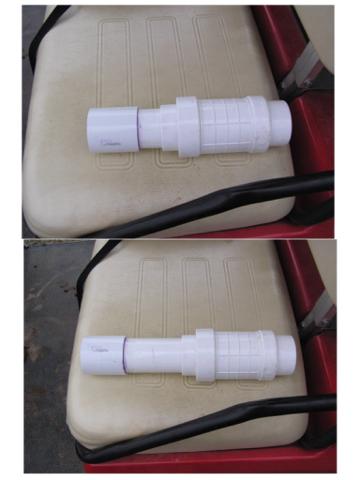

The local Ace Hardware Man recommended this type of union. As you can tell by the picture it expands. I put a double female on the male end to prepare for the patch.

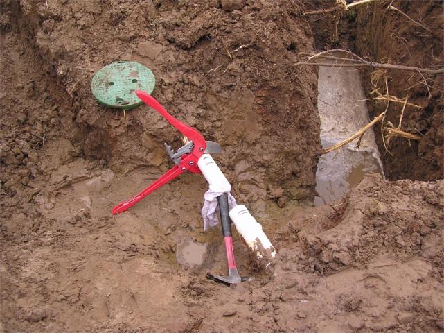

Two things here made the job easier. A hole I dug on the right side of the repair to drain the water when I re-cut the pipe and a 2" PVC pipe cutter.
