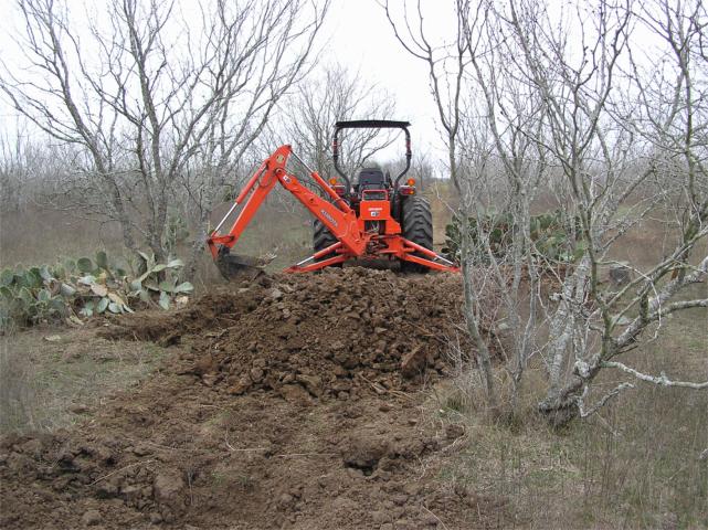

The new union installed easily. I used the PVC glue that can be used in water. The new union and line has not leaked a bit. The water meter wheel has been still for seven hours. I think I can finally give this job a thumbs up.
What started out being a question about a long waterline ended up being a long thread about a leak with a bit of tractor thrown in for excitement! /forums/images/graemlins/grin.gif
Thanks for the support!
