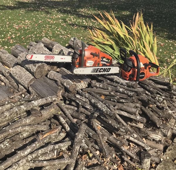

Without getting into the usual pizzing match conerning gas powered saws, I run Echo's as well as older Stihl's. One nice thing about Echo's is thay all have adjustable oilers, easily accessed on the bottom side of the powerhead and are usually less than a comparable Stihl and have a better, longer warranty as well (not that I've ever had any warranty issues with any of mine). I don't ever buy chain loops, I buy bulk chain and make up my own as needed and I don't care at all for the new Stihl lightweight bars, I prefer the Oregon bars or the Japanese bars. I machine grind all my chains as well as my arborist customers chains. Never hand file anything, ever and I always use canned gas, not pump gas and I like the Echo Red Armor 50-1 myself and always Stihl premium bar oil, never motor oil and especially not used motor oil. Have all my saws standardized at 0.050 width (drivers) chain, skip tooth of full comp don't matter and my rule of thumb is, when the heel of a tooth starts building pitch, it's time to install a new sharp loop as dull teeth only eat power and make sawdust.
Don't care for fuel injected saws at all, only carb saws because injected saws are way too complex, sort of like emissions compliant tractors and I like simple.
Finally, I use a battery powered Echo for pruning and limbing. No starting issues, instant on, instant off and they run just fine without the noise of a gas saw.
You may agree or not, but that isn't revelant to me. How I approach chainsaws and what I do and what works for me. It may not for you however, why there is more than one brand of saw and chain and bars as well as fuel and bar lubricant as well as sharpening methods.

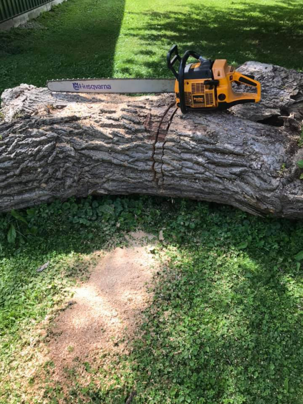

I mean even poulan sells their little plastic saws 46cc with a 20" 325.
Good lord I hope a stihl 261 50cc pro saw could pull it that cost $700. :ROFLMAO:
Heck I ran 36" on a 65cc poulan and 32" on 59cc stihl. Anything can be run. 🍻
