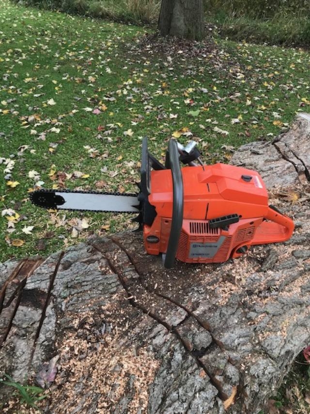

Speaking of pull cords, your photo was a little small to see for sure, but were some of those 084's without compression relief valves?!? oof!
My 036 has one, but that saw is small enough that I rarely even bother to use it. My 064 must have pretty high compression, or a comparatively small-diameter spool on the recoiler, because that is the toughest saw I've ever pulled over. Thankfully, my 084 had de-comp, I'd think you'd almost need a kick starter on those things without!
   / Longer bar for Stihl M261 - relative novice. #44
All 84's have them. Decomps.
