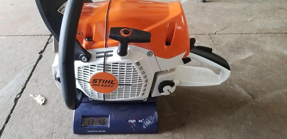

I ran a 462 and 500 back to back.
I would take the 462 for the 25" aka 24" under bars all day.
It's power to weight is actually great.
STIHL MS 462 72.2 4.4 5.9 6.0 13.2 0.73 at #2 on stihl new saws.
