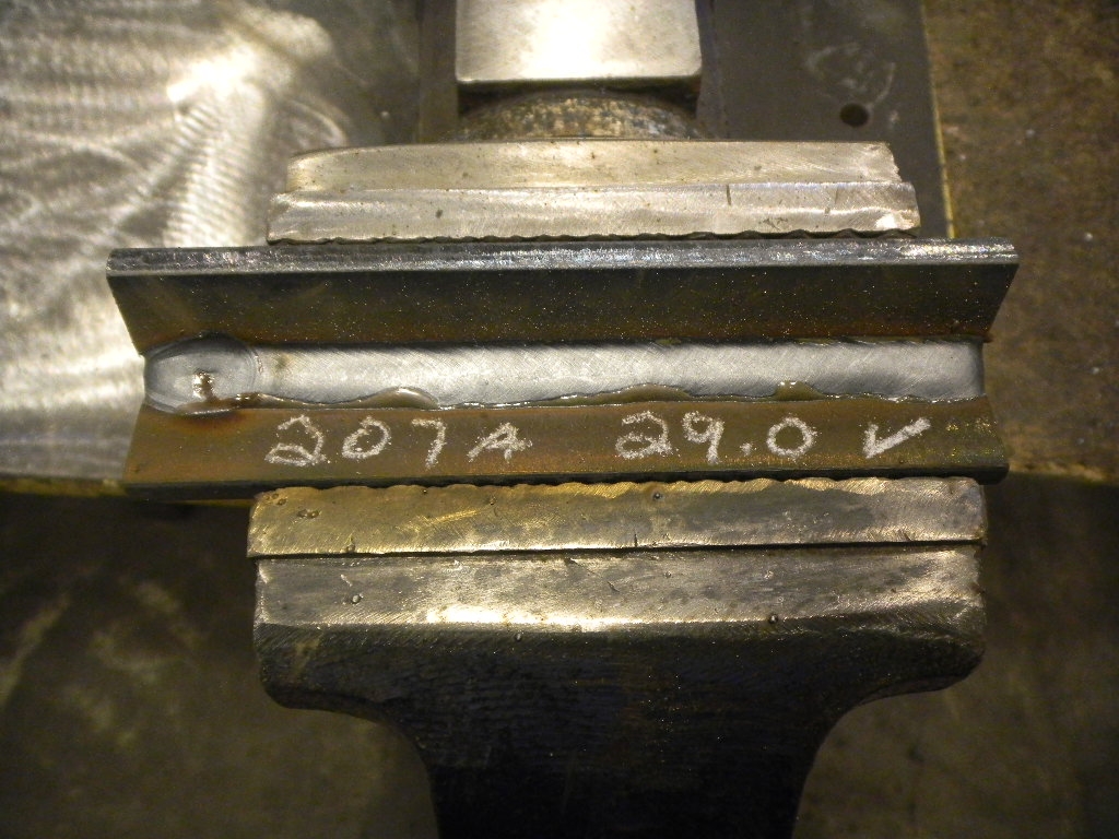

Spray is very fast! Here is one I did with .035 L-56 wire, and C10 gas.
Just looked up the definition of spray arc transfer. Wow that is so cool and weld looks so smooth. Had to do a double take to ensure I knew what I was looking at! But is there much penetration with spray arc transfer?

Yes, it is a very high energy process. Instead of little globules of welding filler entering the weld there is literally a spray that gives you the sort of finish seen in Shield Arc's photo. I'd love to do it but it requires Big Boy welding equipment. If I recall correctly you can do it with something like a Miller 252 and up but not the smaller machines.
   / Longevity Arcmate 205P Mig/Stick welder #16
Boy I would sure think so! That weld was done at 207-amps and 29-volts on 1/4-inch flatbar. If I remember correctly the plates were glowing red when the weld was completed!
It takes a machine capable of a lot of volts.
I don't think spray is worth it for the average guy. The metal has to be almost spotlessly clean, and you have to run 3/4 to 1-inch stick out or you fry the contact tip.
In a high production shop yes!

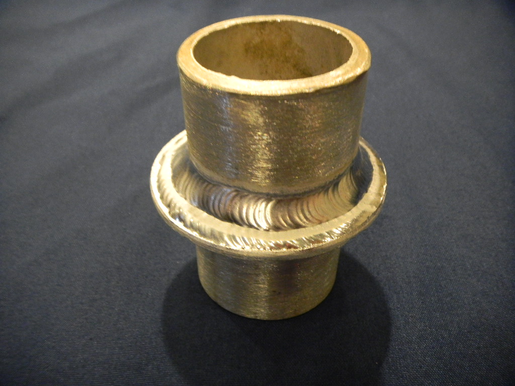

   / Longevity Arcmate 205P Mig/Stick welder #19
Anybody can pull a trigger. I like the stack of dimes look, takes more skill to stack them little things in a row. :laughing:
It surely does take skill and practice it just doesn't mean squat to the weld quality!:p
Nice looking weld from that process. Do they use that process in applying hard surfacing? I bought some tiller tines some years back and the edges were welded with an abrasion resistant weld and it looked like it had been applied like that. From appearances like that.
