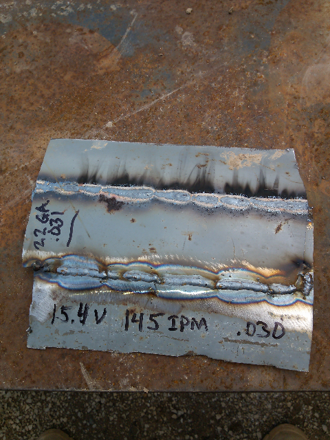

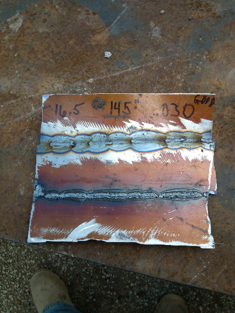

I have neglected to update this thread for a while so I attempting to catch it up to speed. I ran into a problem when first attempting to mig weld from difficulty starting an arc and just happened to notice that the wire feeding the mig it power was loose near where the welding wire feeds into the liner. It took just a few minutes to snug it up.
I am in the process of patching up a 1995 Jeep YJ Wrangler and getting it ready to do some mild off roaring. I have to weld in a new floor pan on the drivers side and a new gas tank support frame cross member.
So I have practicing on some 22 gauge metal from a barrel that I cut up. The floor pan will be 18 gauge if I am not mistaken. I practiced stitch welding and here are some of the pics. I am new to mig though I have stick welded though off and on for about 30 or so years.
