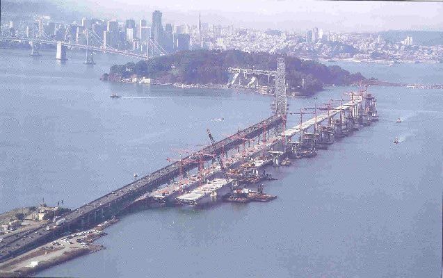

I lived in California for about 20 years, Union City, Hayward, Alameda, Livermore, Tracy, Ripon, Bethel Island. Worked all over the Bay Area, and in LA.
Recognize this?
