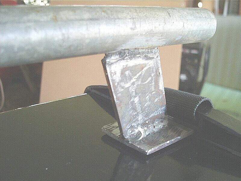

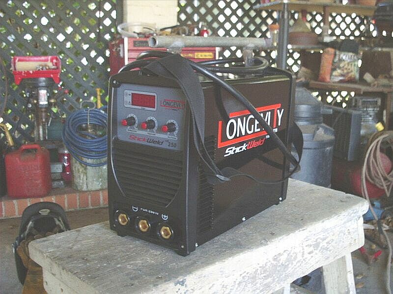

StickWeld 250 Review
Pro's:
At the Power Output of 250 Amps DC, it is a light weight and compact unit.
Awesome Duty Cycle ratings
Dinse connectors make changing polarity and adding a lead for more reach easy.
Copper contacts on the ground clamp
Con's:
Manual could be improved
Purchased to replace my stolen stick machine. The discount made it a great opportunity to get back my stick welding capabilities. Biggest problem, as with anything, I now want more stuff for it. As in 25' and 50' work leads, 160 amp whip, 50' of 8 gauge power cord, large selection of electrodes and a modified hand truck to tote it all around.
I wanted a handle for mine so I made me one. It slides into existing slots on the front and rear covers which required no modification to the machine. Material used was 1/8"x1-1/2" flat, 1/2" pipe and 3ea 1/8" 6011 rods. The flat bar needed to be ground thinner so it would easily slide into the cover slots.
I am a Happy Camper... much more welder than I needed!
