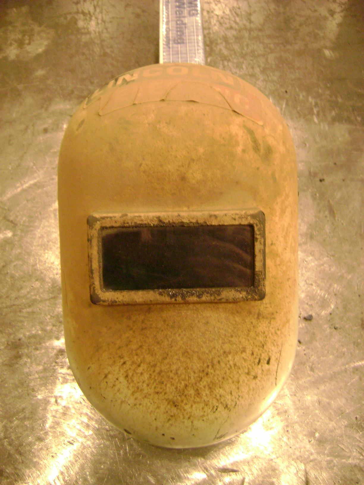

Anyone with suggestions on the reflections coming in from the back would really be helpful. I stopped early because I did not want to have an eye problem.
I think your helmet / hood is too big. I read your post earlier this morning, latter I went out to the shop and did a little welding. I have 48 lights in the ceiling of my shop, and I could not see one light in the back ground with this welding helmet / hood.
   / Longevity Welding - MIG TIG Stick Multi Process Welders and Plasma Cutters #215
It was not the reflections of the other lights it was the reflections of the arc itself that I am concerned about. Are there different sizes of hoods/helmets? My head is a 7 3/8 hat size which not large is certainly not small either.
   / Longevity Welding - MIG TIG Stick Multi Process Welders and Plasma Cutters #216
The arc must be reflecting off of something. I know if you see anything in your lens except the arc it can be very annoying!
I wear a 7 1/4 to 7 3/8 depending on the hat. This morning I really paid attention to any light, or anything inside my Pipelinner hood that could / should bother me, nothing! It fits real tight to the side of face, my head blocks all light from reflecting on the lenses.
   / Longevity Welding - MIG TIG Stick Multi Process Welders and Plasma Cutters #217
Annoying I can live with I am concerned about the safety to my eyes aspect.
   / Longevity Welding - MIG TIG Stick Multi Process Welders and Plasma Cutters #218
Not a pro welder, but I have some of the same reflection issues. Usually when I am too lazy to put on my leathers and weld in a white t-shirt. Also seen it when I weld near a white drywall wall. Just have to find what it is reflecting on and reposition or cover up the surface.
