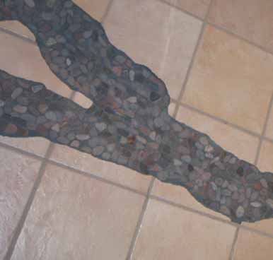

The "stone river" is a section that looks like a meandering stream that is cut out of the tile. I inlayed cut river rocks and then set them into blue grout. The shower floor is also made of the blue grouted river rocks, they "spill out" of the shower and make a "stream" across the floor. No actual water flows with the "stream."
What should have been a 2 or 3 day tile job lasted 8 days. Cutting the curves was much harder than anticipated.
When the grout went down tan field grout was laid down first. After it dried, the the cut river stones were glued into place and then all the tan tile and tan grout was masked off because the blue grout had a staining effect on everything it touched, including skin!

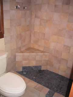

Here is a picture of the shower. I still have to get a shower door!

Here is a closer shot of the stream showing the individual rocks. Each rock had to be cut smooth on 2 sides to lay flat and they are the same thickness of the surrounding tile.
