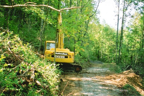

Speaking of dogs. Here's another rental unit with a bite.

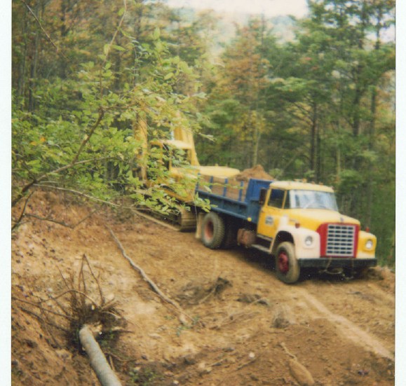

Widening the bench on the hill for a cistern.

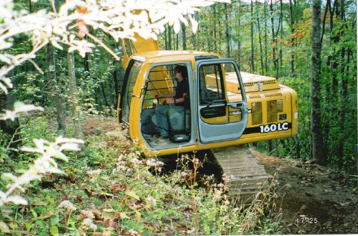

Here's a picture of the business end.

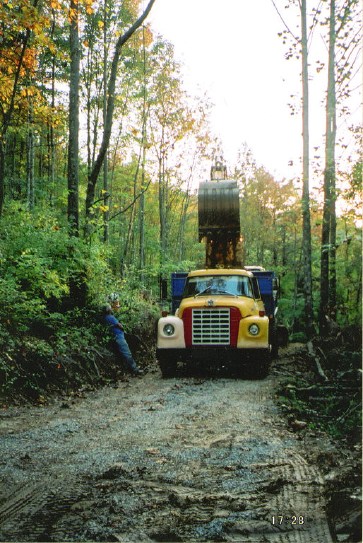

I've attached a picture of the bench before I started the pit.
