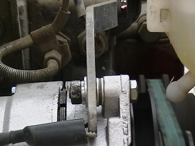

The OEM alternators are only ~14 amp. Won't even keep up with your headlights. Ask me how I know this.. The Delco 10 Si or 12 Si are direct shoe-in replacements - even use the same pulley. The only real mod you will have to do is get a different length fan belt and insert a couple of spacer washers for the adjusting arm. I went with the segmented belt from Harbor Freight - I will never have to replace it again.
I went with the 12Si 72 amp alternator because I use electric winches, powerful lights, and a 110v inverter.

Yes, exactly what everyone has said, Congratulations on a super buy. And I've installed the 10SI three wire alternater on my JM354 and it had to have the wider pulley and also I had to get the special nut for the wide pulley. The 10SI cost me $16 at the wrecking yard and has been the best invest so far, I also installed a group 31 battery $120 from O'riellys Auto supply (Used to be Shucks). bjr

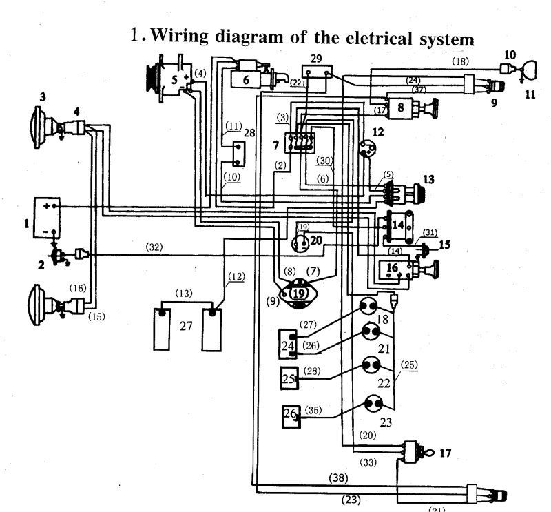

Check your wiring diagram Ron, not all battery charge circuits include the voltage regulator (VR). Some are on a separate circuit that is independent of the VR. At least it did on the 4 Chinese tractors that I owned. That said, they were all 3-wire alternators (external VR). What follows is not necessarily applicable to 1-wire alternators or conversions.
Take this Jinma 200 Series diagram for example; the + post on 3-wire Alternator (5) sends unregulated voltage on wire #4 to the ammeter (12). At this point it's also paralleled to the keyswitch (13) on wire #5. When the keyswitch is placed in the RUN position, the ammeter then sends said voltage via wire #3 to/through the system fuse - then onward to the starter solenoid (6) on wire #2. From there it rides the battery cable back to the + post on the battery. This is charging voltage, no VR in the circuit. Any "regulation" done is a feedback function of the battery charge state; low charge/high voltage, normal charge/maintenance voltage.
FWIW, unregulated voltage also travels wire #8 between the alternator and the VR. From there wire #7 feeds regulated voltage to the rest of the circuits in the fuse panel.
Assuming your 284 conforms to the above diagram, your symptoms describe both regulated and unregulated voltage. But since accurate voltage readings are dependent upon a good ground, you might want to clean both ends of the battery ground cable. You've been around long enough to know to clean the paint/rust under the ground lug on the frame. And if there's any white stuff showing between the cable strands and the insulation, it might be time to replace the cable as well. If none of that returns your voltage reading to normal, it might be time to start thinking new alternator.
//greg//

Wire 7 is a sense line, the regulator senses this point to control current in the field windings of the alternator. More current = stronger field = higher voltage. Less current = weaker field = lower voltage. The output of the alternator is wire 4.
If the voltage on the + terminal of the ammeter is higher than the battery voltage, the ammeter will show charging. If the voltage is lower, the ammeter will show discharge.
The point is that the regulator sees to it that it maintains the alternator output at a regulated level. The regulator regulates current in the alternator windings, it does not output a regulated voltage to anything.
   / Look what I got for $1700 #18
I see. Perhaps I misinterpreted the wiring diagram. I was keying off the fact that wires #2 and #3 do not physically feed the fuse panel bridge. Rather, they simply connect the ammeter and the battery via the 30A system fuse. So going by your asserting, then it's wire #6 that actually feeds the bridge. Wire #7 is then paralleled off for purposes of VR feedback (sensing) to the alternator. Is that more in line with how you see it?
//greg//
   / Look what I got for $1700 #19
//greg//
Yes. Wire 5 gets connected to wire 6 via the ignition switch to power up the rest of the system.
   / Look what I got for $1700 #20
Thank you for the edification. I've apparently been misinterpreting that diagram for quite a while now.
//greg//
