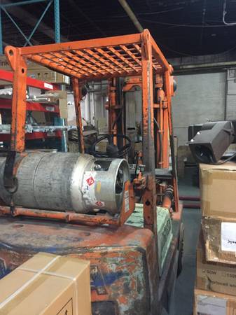

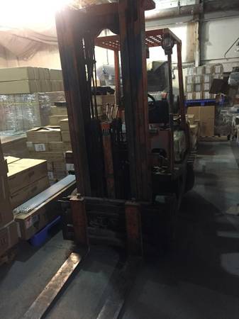

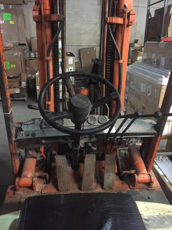

This is the one I知 looking at
629647d1574382519-looking-forklift-b131338b-766e-4e6f-87c8-55c952f9b807
Buy it. That is a very good forklift. I operated one just like for several years in a department that had about 20 of them. Nice ride, smooth controls and seldom any of them broke down.

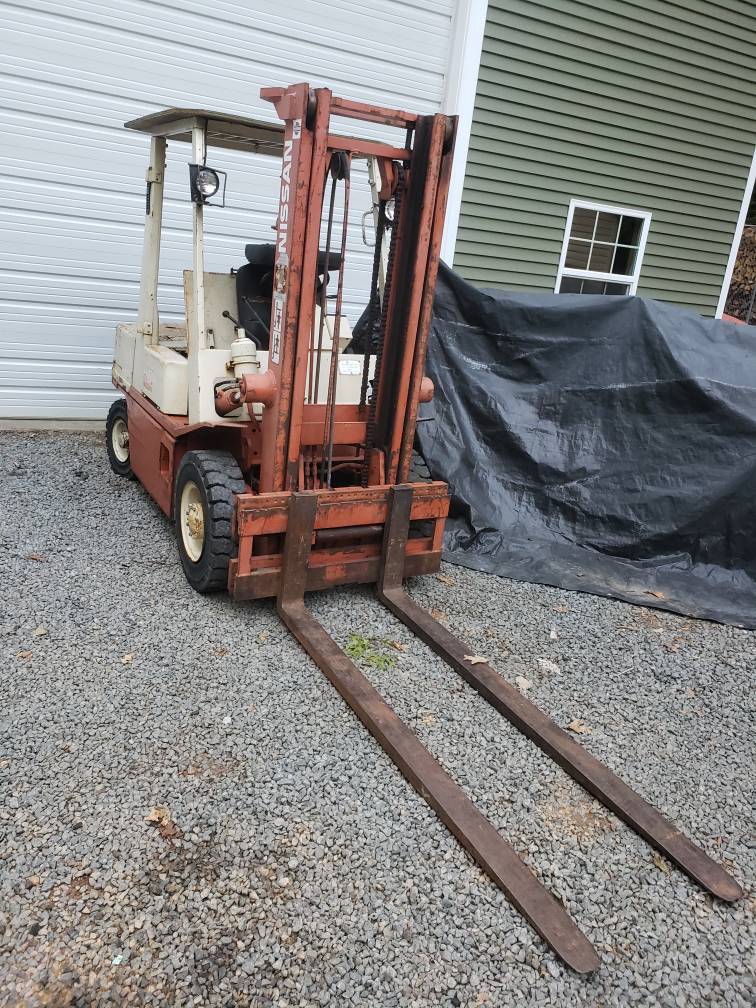

I was looking a forklifts earlier this year, lucked out and found an older diesel 5k Nissan with larger solid tires. Was able to get it cheap because the hyd. pump was leaking into the crankcase. Resealed the pump and it's good to go, only thing I wish it had was a 3stage mast instead of a 2, lift height is only little over 11ft but works for most of what I need. Works well in the gravel outside of the shop.
Came with 6ft forks which are awesome.
It took awhile to find, but was able to get it for $1500 because of the hyd. leak.
