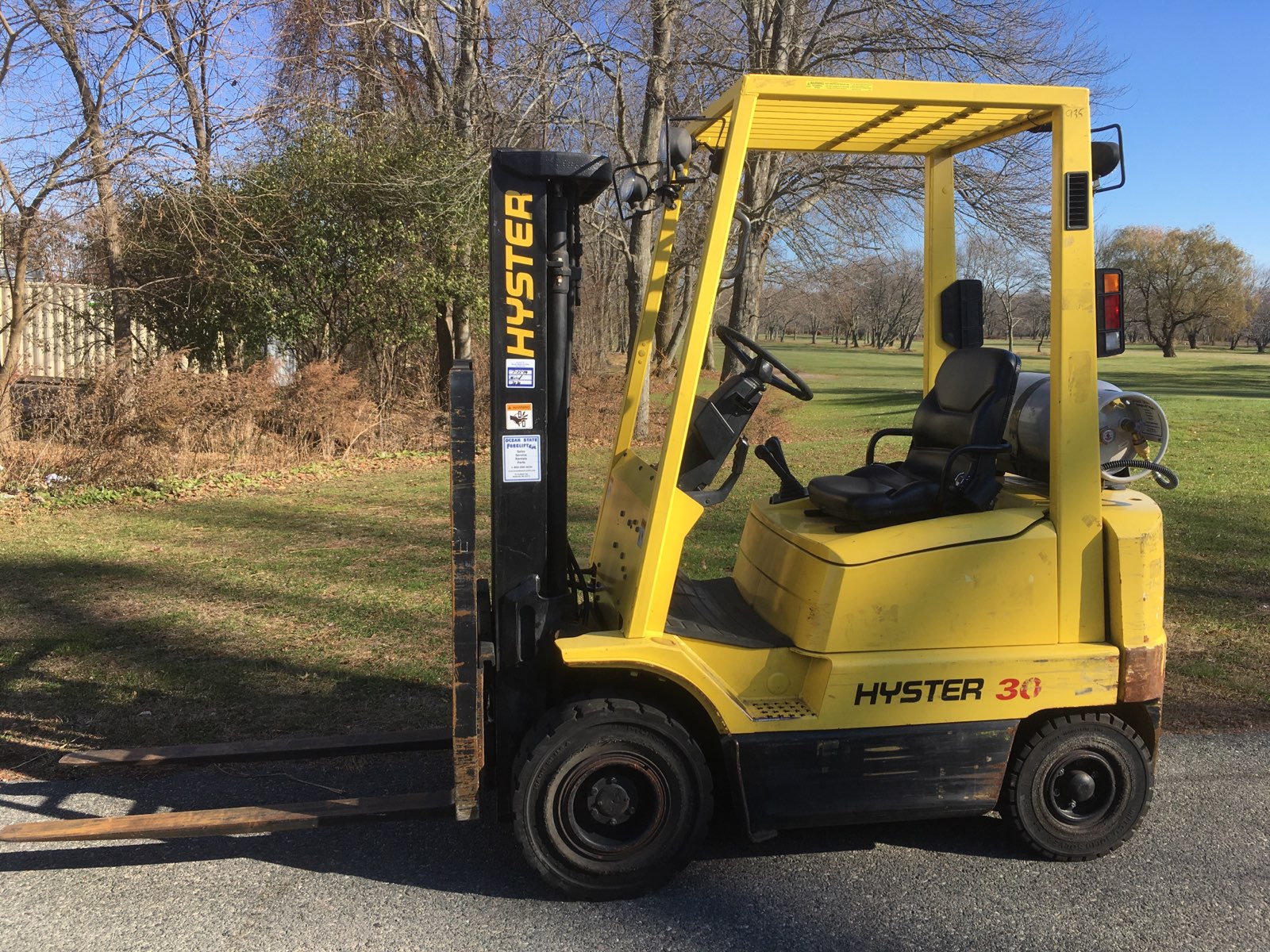

This is the one I知 looking at
629647d1574382519-looking-forklift-b131338b-766e-4e6f-87c8-55c952f9b807
Buy it. That is a very good forklift. I operated one just like for several years in a department that had about 20 of them. Nice ride, smooth controls and seldom any of them broke down.

I don稚 know what you壇 need to move that a 3500 pound lift wouldn稚 lift. Keep in mind it痴 rated to do that to full height every day. It値l probably lift double that much.
Nobody would ever need more than a 3500 pound lift?

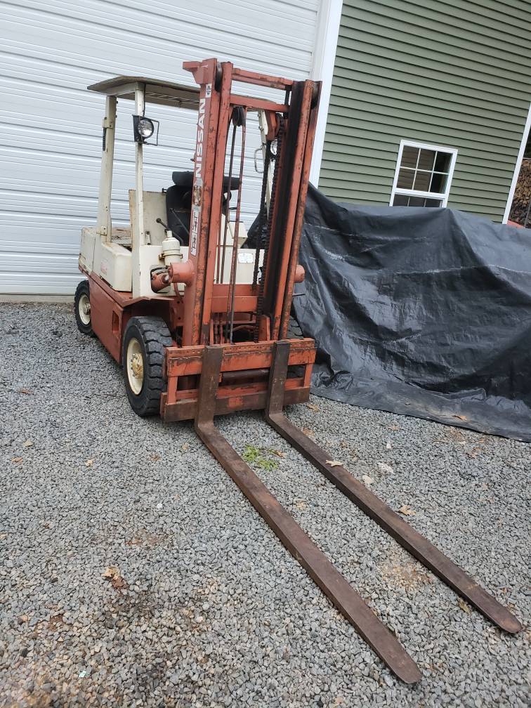

I was looking a forklifts earlier this year, lucked out and found an older diesel 5k Nissan with larger solid tires. Was able to get it cheap because the hyd. pump was leaking into the crankcase. Resealed the pump and it's good to go, only thing I wish it had was a 3stage mast instead of a 2, lift height is only little over 11ft but works for most of what I need. Works well in the gravel outside of the shop.
Came with 6ft forks which are awesome.
It took awhile to find, but was able to get it for $1500 because of the hyd. leak.
Well they make a forklift to move shipping containers but the op said he only wanted to lift 2800 pounds. A 3500 pound lift that will probably lift 5000 or more will lift the vast majority of anything most people need to move.

"3500 is harder to sell" ?????
3500 is the hours on that machine.
3000 lbs. is the rated lift weight.
A 3000 lb lift is much more difficult to sell than a 5000 lb. machine.
$10,500 sure seems like a lot for that little Hyster.

That is a good price for a 3000# machine with only 3500 hours.
We have one at work that sold for $9000+ with at least double if not triple those hours, but that was a little heavier machine (4000# IIRC).

Thanks for all the replies, we pulled the trigger and bought it today. Probably be delivered at the end of the week or next week sometime. With the relatively low hours and overall good condition of the lift. I figured that even if it was at the upper end of its value scale, It would hopefully give me few if any problems for a while. I think that we may only put 50 hours a year or so on it at the most, so this should be the last one I buy.

So I'm in the market for a used forklift. I know very little about them but from what I have learned, I think I'm leaning towards one with pneumatic tires so it can be used on asphalt as well as concrete. My needs I'll be minimal..probably less than 40 hrs a year of use. And the heaviest lift will be 2800 lbs. I found a 3500 hr propane Hyster 3k unit that appears to be in good condition and well maintained. It's in the 10,500 range. A little more than I want to spend but the cleanest used one I have come across in my area. Anyone have any input or personal experience ....what to look for and what to avoid ?
