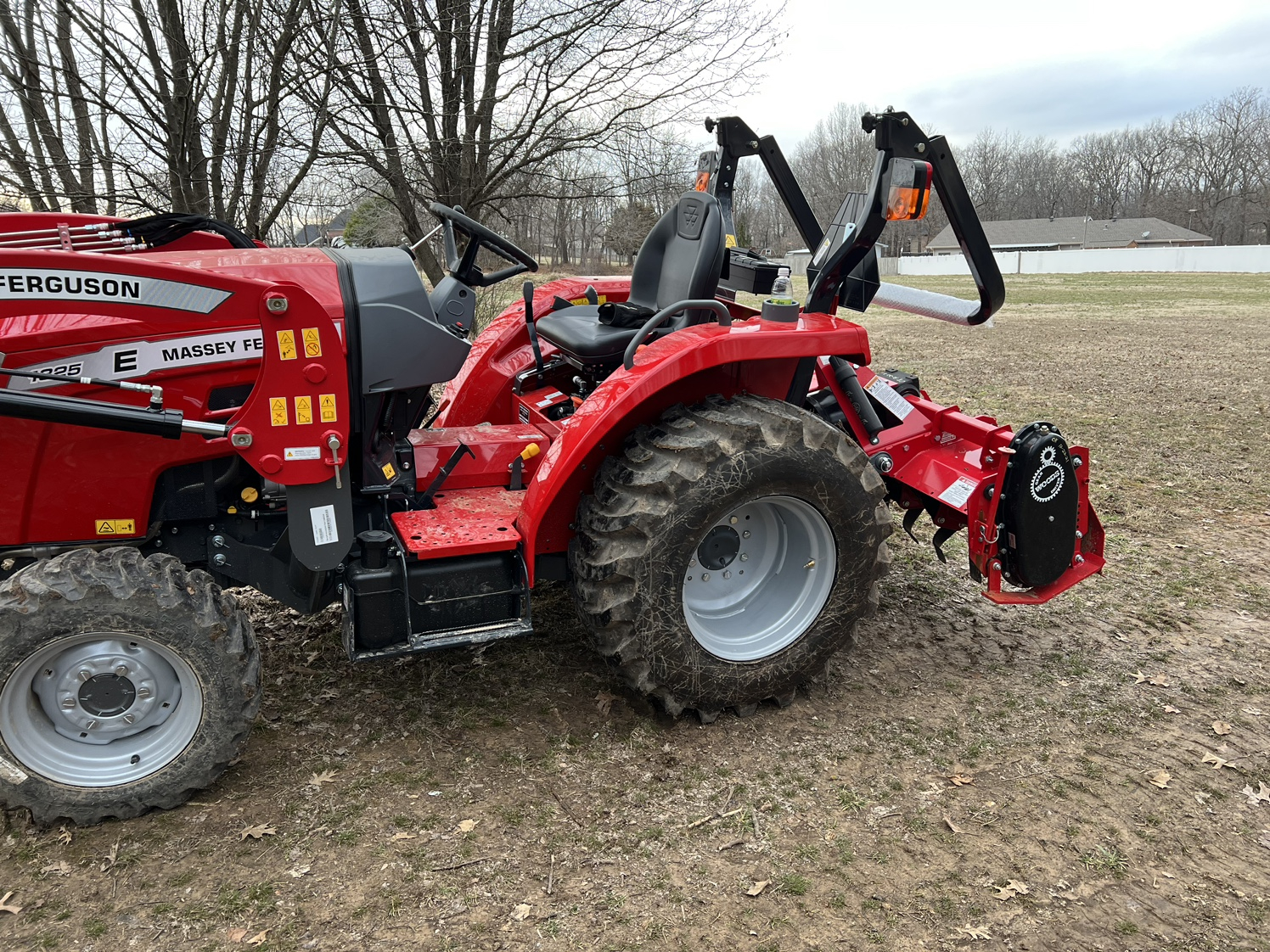

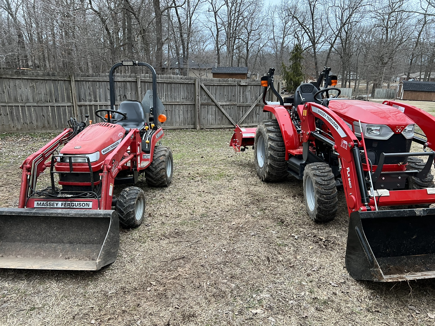

Here’s my new tractor!
The 1825E is a nice, well laid out tractor; doesn't it look huge next to your GC!

So there is a saying that basically guarantees your implement and tractor will work well together, and that's "5 pto horsepower for every foot of width."
That said, it's not a rule, and it varies by situation. With something like a tiller, depending on your land, you should be fine just to slow down while running the RPMs up.
Add some speed or a hill and you may be unhappy.
