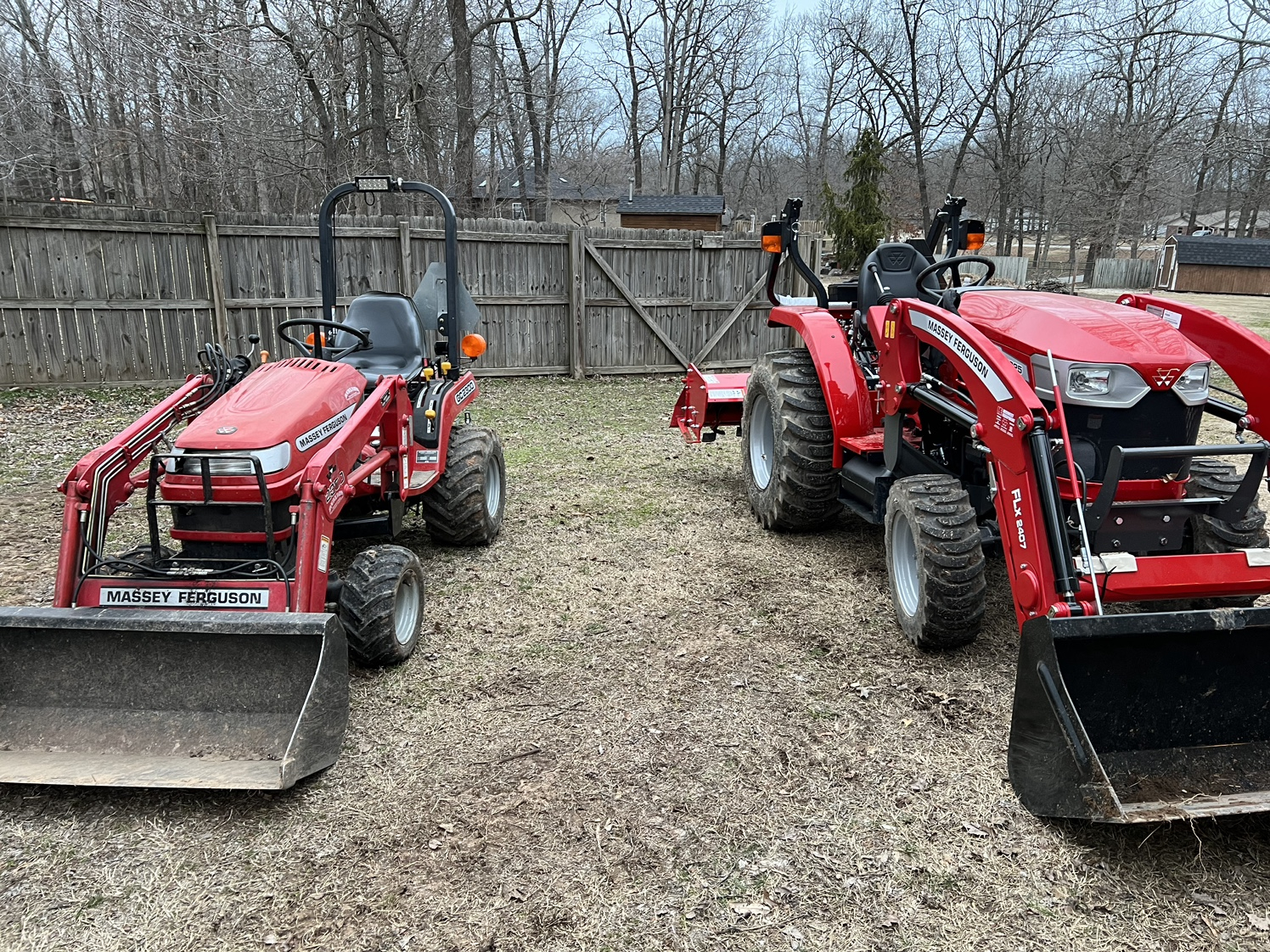

Here’s my new tractor!
The 1825E is a nice, well laid out tractor; doesn't it look huge next to your GC!
