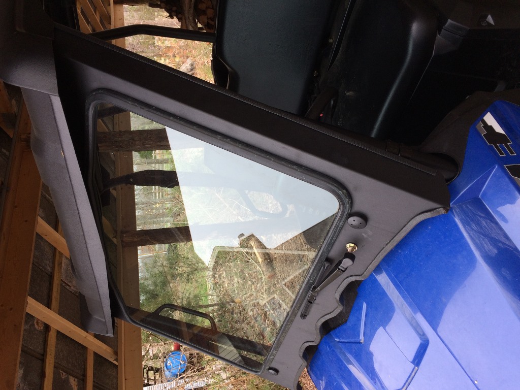

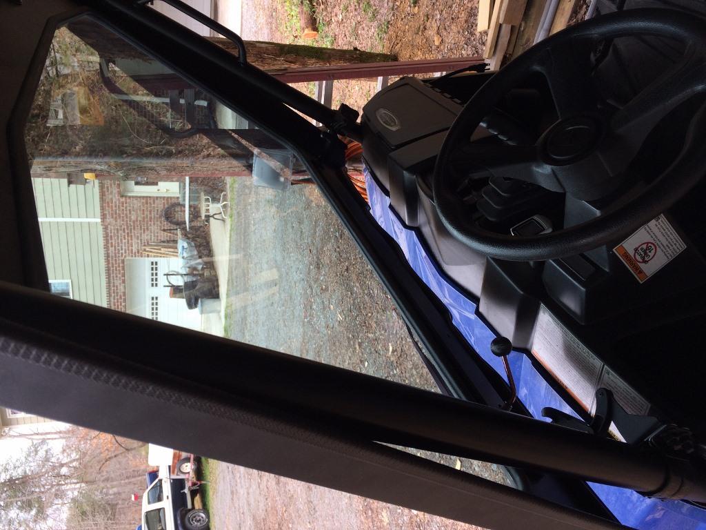

Who is the manufacturer? Where can I look at one? (website would be great)
Mine is Polaris OEM. No idea or clue who actually made it. Evidently I got the very last one existence to fit my 2010 model.
It is very simple; stamped, powder coated steel frame, regular "tube" clamps to mount it to the frame uprights, and the lower mounts have a swing-out mechanism.
Looks good, but if it's OEM Polaris, it won't fit the Kubota.
