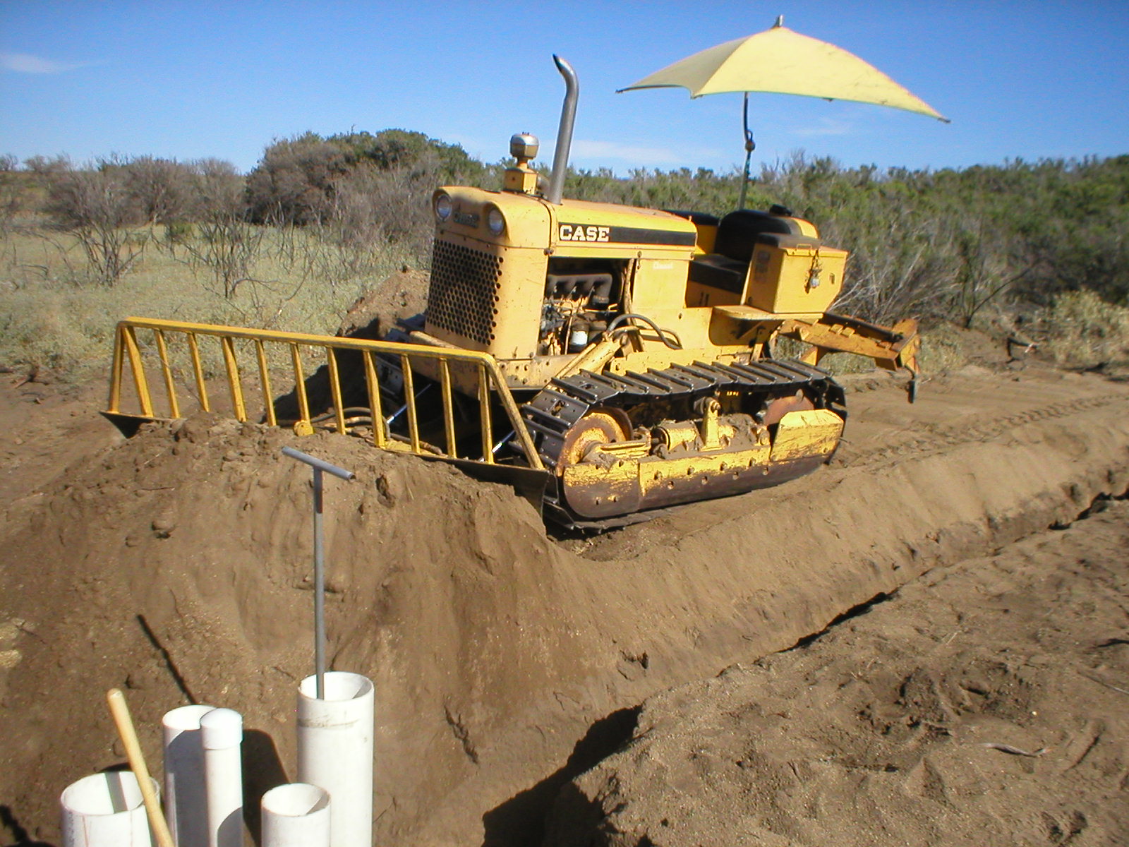

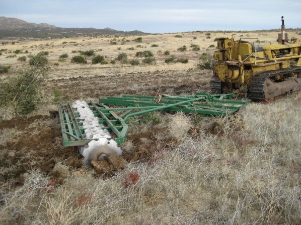

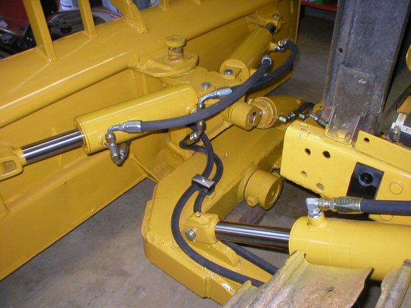

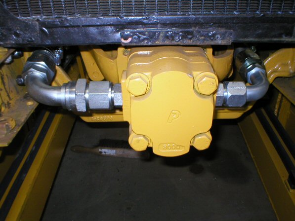

I believe that as long as you half way know what you are looking at, you CAN get a cheap dozer and not be sorry. We have twice, still have both of them and both have paid for them selves countless times over.
First one was an old 1962 Case 310. Paid $3200 for it, ran it for about 200 hours and broke a final. Cost $1200 for a rebuilt final. then put another 600+ hours on it and decided to do a partial restore on it. All new hydraulics, pump, hoses. Radiator, valve job etc. I now have a total of $8600 in it. I have put over 1000 hours on it when I wanted to and needed to, not at someone else's time frame. Well worth it to me, but if you are the type of person that pays someone to do the work, then it is not the type of machine for you and I am sure that the total amount invested would be a lot more.

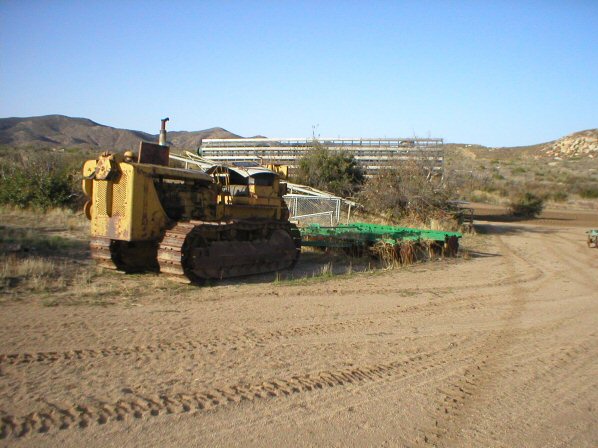

Second one was an old 1943 Cat D6. Paid $1600 for it. Invested $52 in a new piece of brass for the bottom radiator fitting and changed all the fluids. This tractor has paid for itself 10 times over easily, I'm sure more. Is it warn out, you bet it is, but it just keeps on going. When it seriously breaks, it's done, it's that simple.
None of these cheap tractors are any good for commercial use. But for a weekender that is only using it when they need it and for a few hundred hours a year they are the way to go IMO. But and it is a big BUT, you have to be able to work on these things yourself. If not, then you need to be looking in the $25K+ range as was mentioned in an earlier post.
Me, I just don't have the money to pay anyone to work on my stuff, I have to work on everything myself.

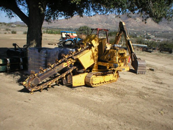

I noticed the "Parson's Trencher" in your equipment list. I ran a Parson's Trenchliner one summer which was a diesel over gas (or vice versa?) bucketed trencher. The thing was a beast but under the right soil and conditions could seriously dig some trench.
Our trencher is about on it's last leg, but still going. :thumbsup: It has the old 4 cylinder Industrial Ford gas engine in it. Purrs like a kitten. The trencher has all carbide teeth, the round ones that are suppose to spin while digging. Digs a 9" wide trench and have adaptors to get it out to 12".

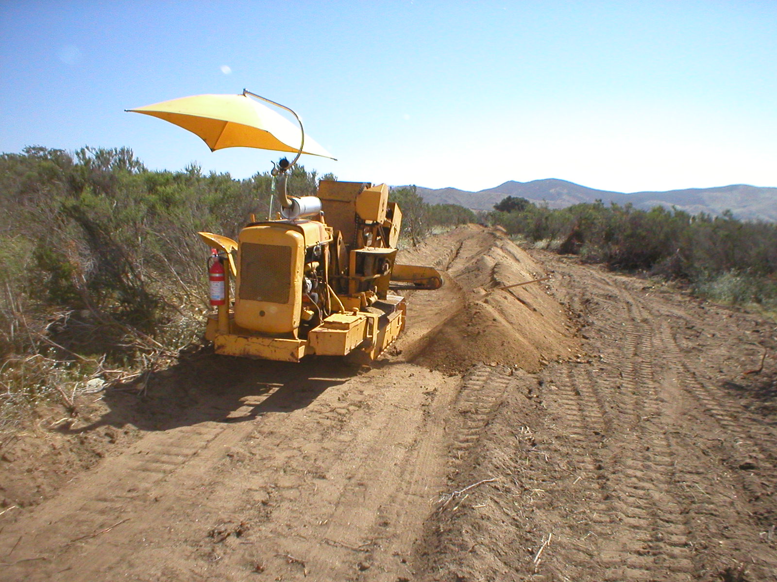

Digs 60" deep, crummer is gone, so leaves about a 54" deep trench with 6" of powder in the bottom. :cool: We put in about a mile of 3" water line with it along with a few off chutes of 2". Dug through solid granite several times, barely slowed it down, but sure did ware on those carbide teeth. :eek:

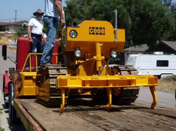

I was hoping that MtView Ranch would reply to this, just so I could see some more pics of his dozers. I have a similar Case 310 and have had for several years. I paid $5300 for mine and have had to put in a few dollars, but nothing more than what's routine for a 40 - 45 year old machine. Mine is a gear drive, which might be preferable for an older machine (maybe - I don't know). I love operating a powershift dozer, but I also love using my small, paid for, gear drive dozer.
