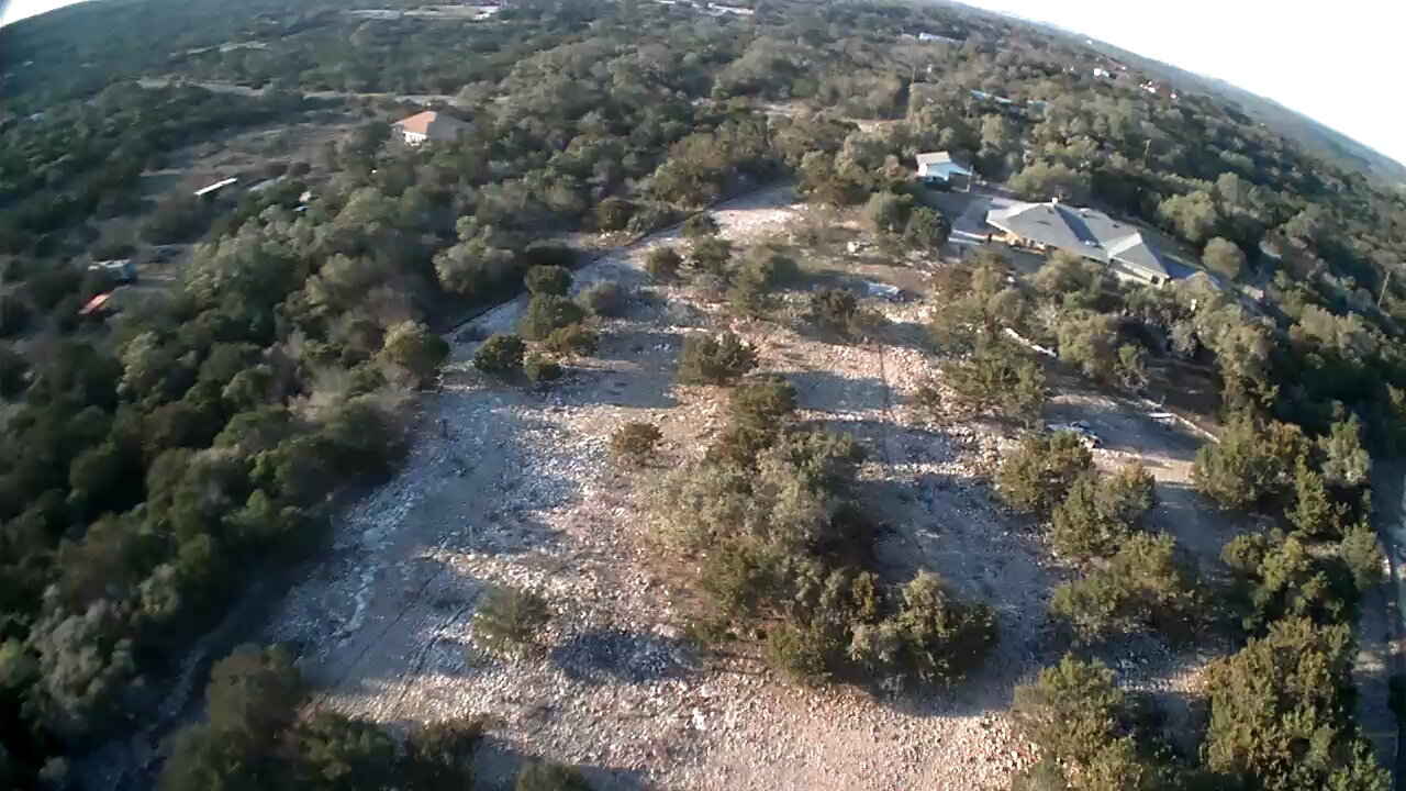

For your work, I would go for a 40 HP LS tractor. Within reason, larger tractor will be your friend. I actually bought too large a tractor strictly because it was within my budget. I made use of my 70 HP for a few months to do the heavy lifting jobs, but then I needed a smaller tractor, hence the B26 addition. I use the B26 now for about 95% of my work. I use the LS for hauling dirt when I need lots of it (one LS FEL load = about 3 of the B26), bush hogging and tiller work. Everything else is done with the B26 TLB. I really could not part with my backhoe even though it no longer gets full time work like when I first got it, it gets enough. I bought both tractors in 2010 and the LS has less than 200 hours while the Kubota B26 has over 600.
NOTE: A compact tractor with backhoe still wont do much for digging out bedrock so I am not recommending it for that. I have used mine a bunch digging out and loading loose rocks into my RTV to haul out of my garden spots. From your photo, it looks like a FEL rock bucket might be worth the cost to pick up those loose rocks although its use will be short lived. When finished with rock pickup, what will you need it for? A box blade might work for you just as well and can be used to move and spread dirt that you mentioned might be needed to be hauled in.

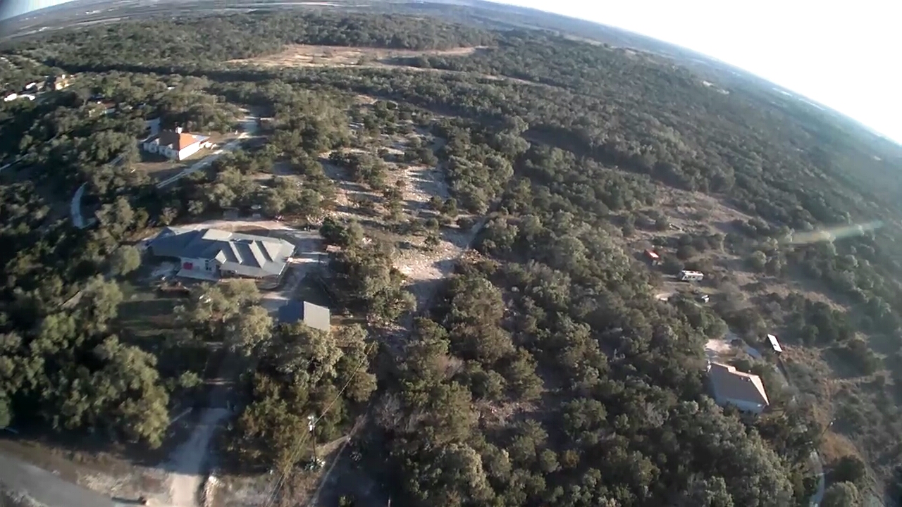

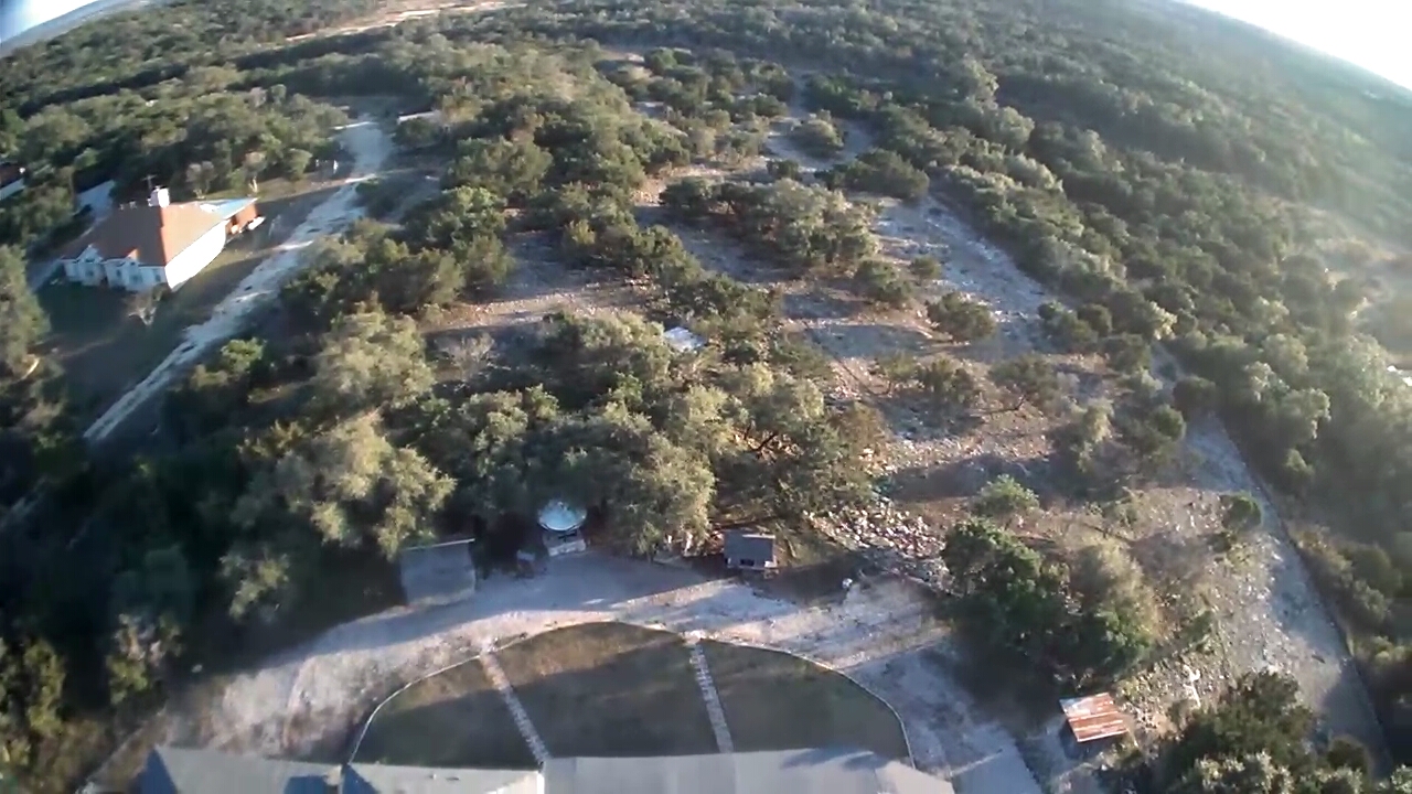

With a bit of dirt down maybe I can get some grass to keep up with the temps and lack of water, as I said even the nasty weeds I have out in the cleared area have died. But I'm sure that is due to the lack of real dirt. If I didn't live here I bet this whole area would be sliding down into that ravine you can see just off photo, lots of my dirt has already tried the cattle fencing is a foot or more taller on my side then the ranch next door (Fine I suppose else I'd have goats AND cattle!).
Yeah I'm seriously considering the 40 horse, I'm not sure if I'll use the extra power but I might, and I am almost positive I need the clearance. It'd be harder to make that choice if the 3032 was 2 to 4 inches taller. I imagine with a heavy bucket load and the box blade that I will surely buy it will compress those 8 inches at least some and they're already close to not enough. In fact my night pen for the goats has rocks that stick no less than 12-14 inches out of the ground. If I ever had to get in there (say this winter with hay) I'd be totally out of luck. I may need to flip those out anyways, the goats love them but as soon as I get out of school and get a real job that's gonna be a pool.

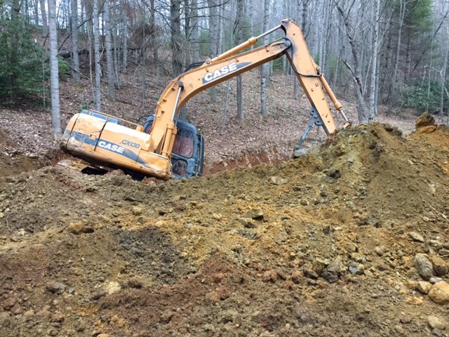

Sounds like you're turning most of the 5 acres into grass lawn. A big tractor will be hard on turf grass. Of course if your soil is sandy, compaction might not be a problem but then you might tend to sink in further as well.
Not sure what kind of tractor will navigate over rocks sticking out of the ground 14".
It took a huge commercial excavator and a dozer driven by a professional to get my property to the point where my tractor could navigate all of it.
