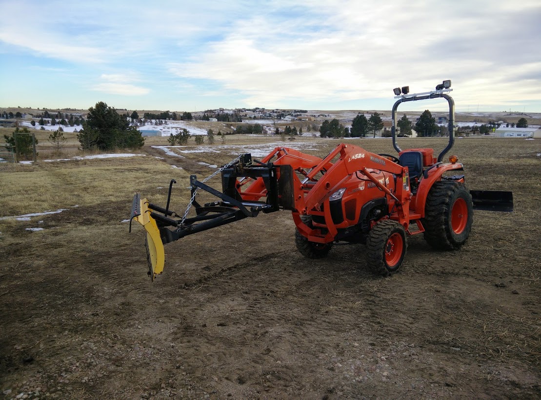

I run with both down sometimes. It does load the tractor a bit more, but doesn't provide too much benefit unless the front isn't cutting that well. My rear 72" blade has skid shoes set 1" below the blade & has hydraulic angle on it. The plow is a manual adjust, so I have to get off to angle it. In theory the the skid shoes help prevent the plow from eating gravel, but in reality both plows eat equal amounts of gravel on my 2 neighbors drives, but not that much on my drive or the main road. It's handy to have 2 depending on which way I'm pointing & weather or not I want to get off to angle the front. The rear blade is a bit heavier I think or at least seems to cut a bit better if needed. Here in Colorado (nearish Denver) out temperature fluctuates so much we have issues with soft gravel. It will be in the mid 60's the day before it snows, so the gravel isn't frozen up solid when I'm plowing often. Plowing yesterday netted a lot of gravel, today with a high of 20, not as much as things finally froze up. I'm thinking about putting a metal pipe on the bottom of one to avoid cutting gravel on the neighbors drive.
I built the front for just over $200, $100 for a lighter truck (probably Jeep) plow at an estate sale & $100 for 2 SSQA plates & a 3pt Quick Hitch. Got some skid shoes for the front, but the plow has 3/4" holes & the standard shoes have a 1" shank, need to do some mods to get them on. I think the plow is a 7', but don't remember.
I was concerned with the front so far out there it would have a lot of leverage to push me around, but in practice it's not that much of an issue. The front does push me around a bit, but maybe 20% more than the rear tops & its a bigger blade. It's easier to do a tight corner with the rear plow though, The front plow does decrease my ability to steer a fair bit at times.

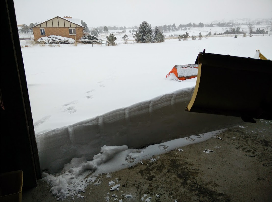

You can see the 2' of snow that was drifted up against my shop door & my driveway is just behind the trees.
