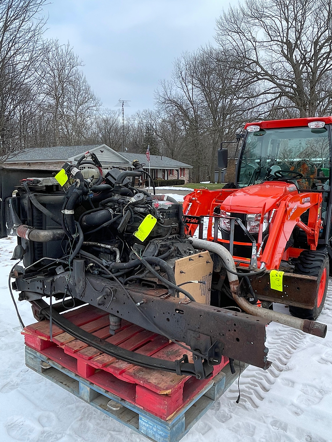

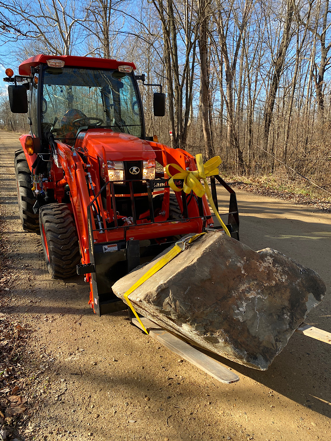

I have a GL4060hstc and loader lift capacity has been the limiting factor for me. I come from the skid steer world and have had to adjust to lighter loads.
Couldn’t lift this 4BT Cummins with transmission and frame rails off the trailer, had to remove transmission. The engine alone weighs about 750 lbs. and it was loaded heavy on one side.
That being said, I’ve hauled some pretty big granite boulders.

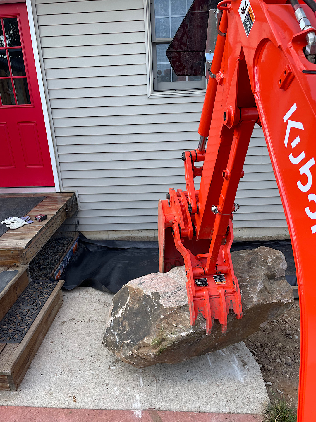

IMO the BH92 backhoe w/thumb is well worth the money.
I really like this machine and the HST+ is phenomenal for loader and fork work. Sometimes I think the GL6060hstc would have been nice but I bought what I could find in June 2020.
