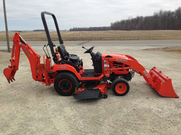

Fountainhead Farms - I'm pretty sure this ad is a scam, so do not take this post too seriously.
A Kubota BX24 that meets your budget! 4WD*~*KUBOTA BX24 tractor w/LA240 Front Loader, w/BT601 backhoe,Diesel
$4,000 - great price (if real. Do NOT send them money!)
Why do people even post suggestions for tractors < $40K that are on the other side of the continent?
The OP is in Marietta, GEORGIA.

Besides, my post was for amusement value only. I told him it was a scam.
