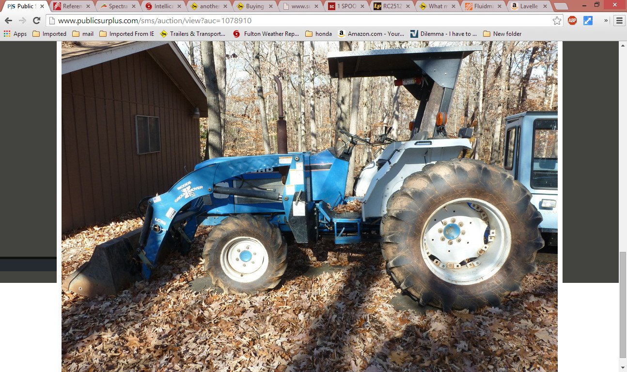

This tractor:
Year: 1990
Manufacturer: Ford
Model: 2120 FWA
Hours: 1958
Public Surplus: Auction #1078910
TractorData.com Ford 2120 tractor information
Went for $8,400 back in mid March, just outside Washington, DC. I wanted to buy it but SWMBO said I didn't need a THIRD tractor.
So the deals are out there for the patient.
   / Looking at used tractors under 8K #33
newbury, that would be hard to pass up, sweet size, not many hours, clean, not too old! SWMBO must be very persuasive to get you to not bring that one home.

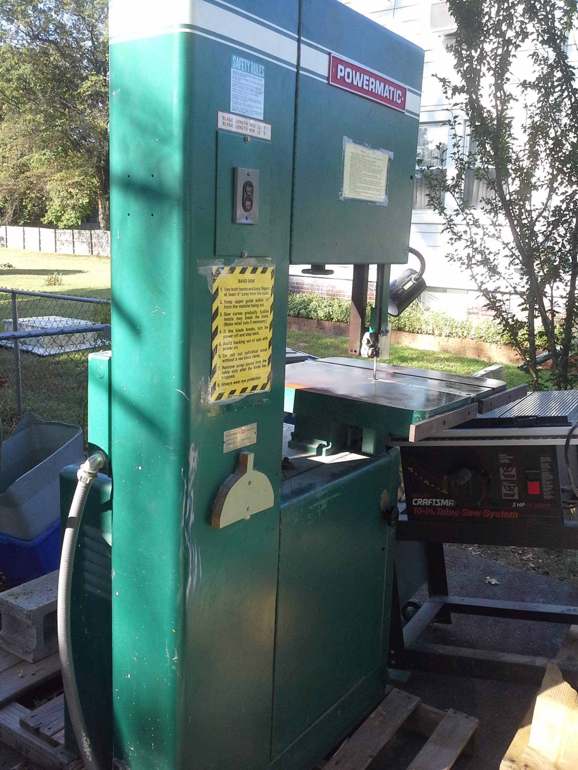

The real deals come about when some overworked clerk lists something wrong to the buyers benefit. I bought almost all the equipment I needed for a woodshop for about $1,000.
The listing description was "tools" with no picture.
And then when I went to pick the stuff up they gave me the bandsaw for free.

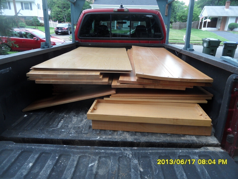

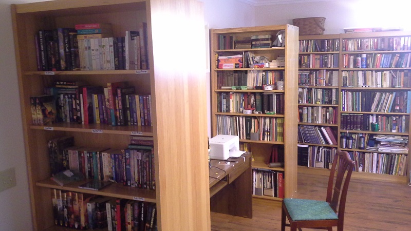

SWMBO set aside one room of our retirement house as a "library". She wanted shelving to match what we already had, solid oak which we bought new about 30 years ago.
I picked up
for $350. Which completed her library with two units left over.
8x520140117_093602.jpg This is the east side of the library.
