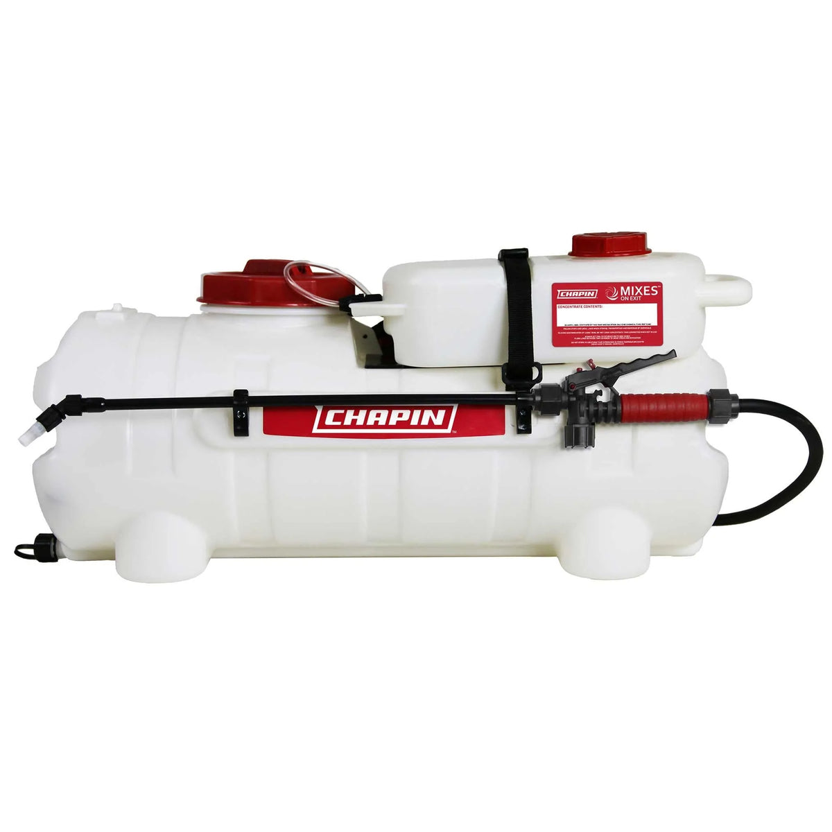

I don't know if this is big enough but it's working action is what you're looking for I think. One tank for water, one tank for chemical and then they mix in the line.
That's exactly what I'm trying to accomplish. Sometime between last night and this morning that item disappeared. I did find another one that isn't the tow-behind: https://www.tractorsupply.com/tsc/p...-25-gal-atv-mixes-on-exit-97562?cm_vc=-10011#
I went to the Chapin website to do some more digging. After further investigation, it appears that the unit mixes the chemical right before the pump. The way it mixes isn't venturi, but with the low pressure (vacuum) on the inlet side it will draw water and concentrate in. I will need to mix after the pump and pressure relief valve, because the pressure relief valve will flow the mixture back into the tank if I mix before the pump.
