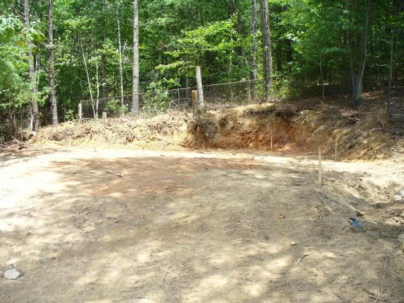

Attached is a pic of an excavation I did with my B3200 Kubota for a 24x24 barn. (30hp, 4wd, about 3,000lbs with loader and box blade). This is about the limit of what a tractor this size can do and it took me a couple days.
The little B3200 excels in tight quarters and is very quick and capable. It's great for finish work, landscaping and other light grading. Where it is not good is on big jobs where a lot of cubic yards of dirt need to be moved. When you get to bigger jobs a compact of any size isn't my choice (which would include the MX5100 and 4720). You need a large utility tractor with the right attachment (big heavy commercial grade box blade or a pull-type scraper), or even better a dozer, track loader, excavator, whatever. For the time being I rent the big stuff, but would like to get a 1yd carry-all type scarper to pull with my JD 5203 for intermediate sized jobs. It's hard to have one size of equipment when your jobs vary so much (at least for me.)

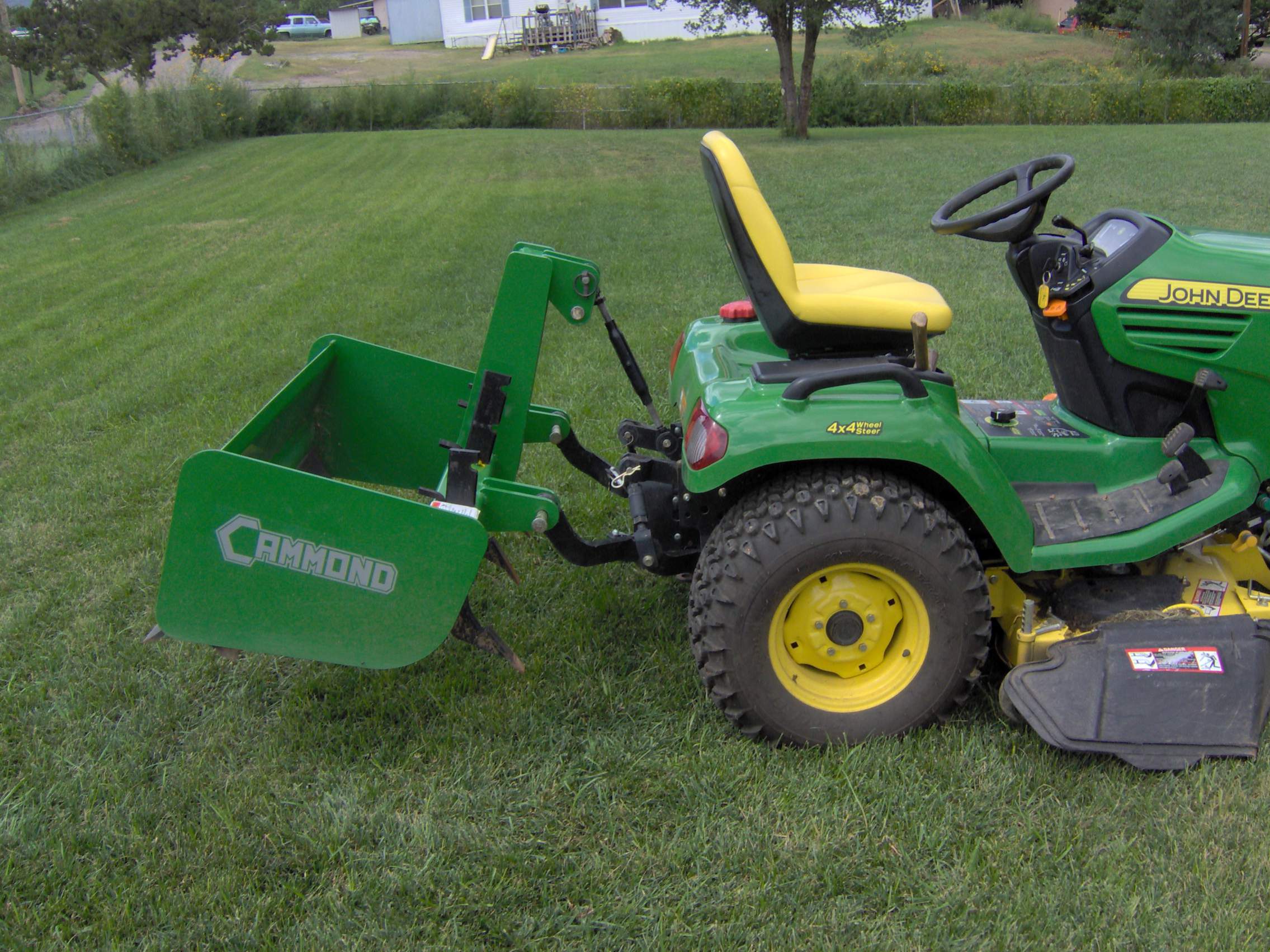

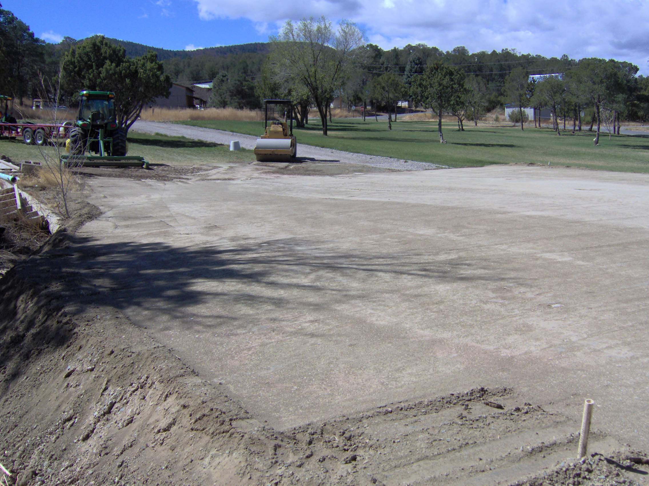

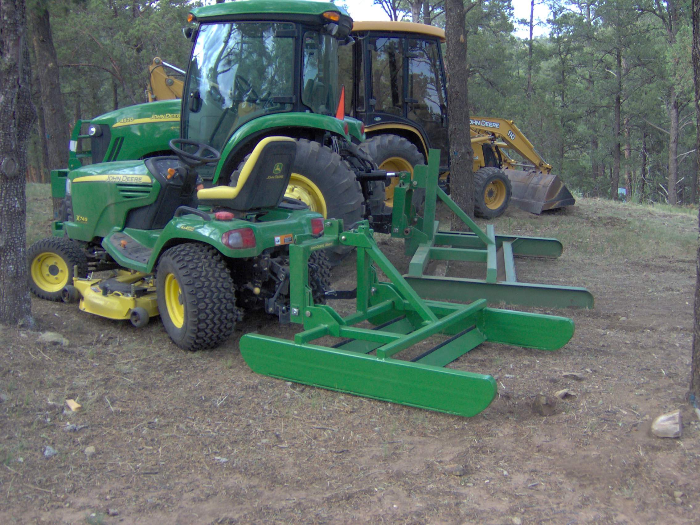

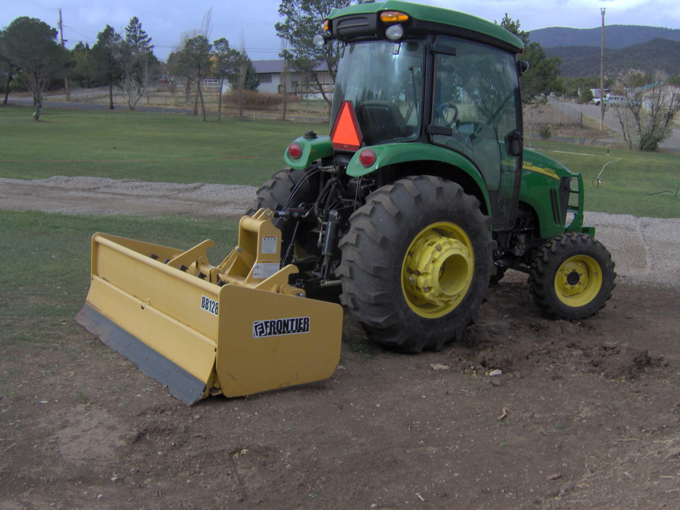

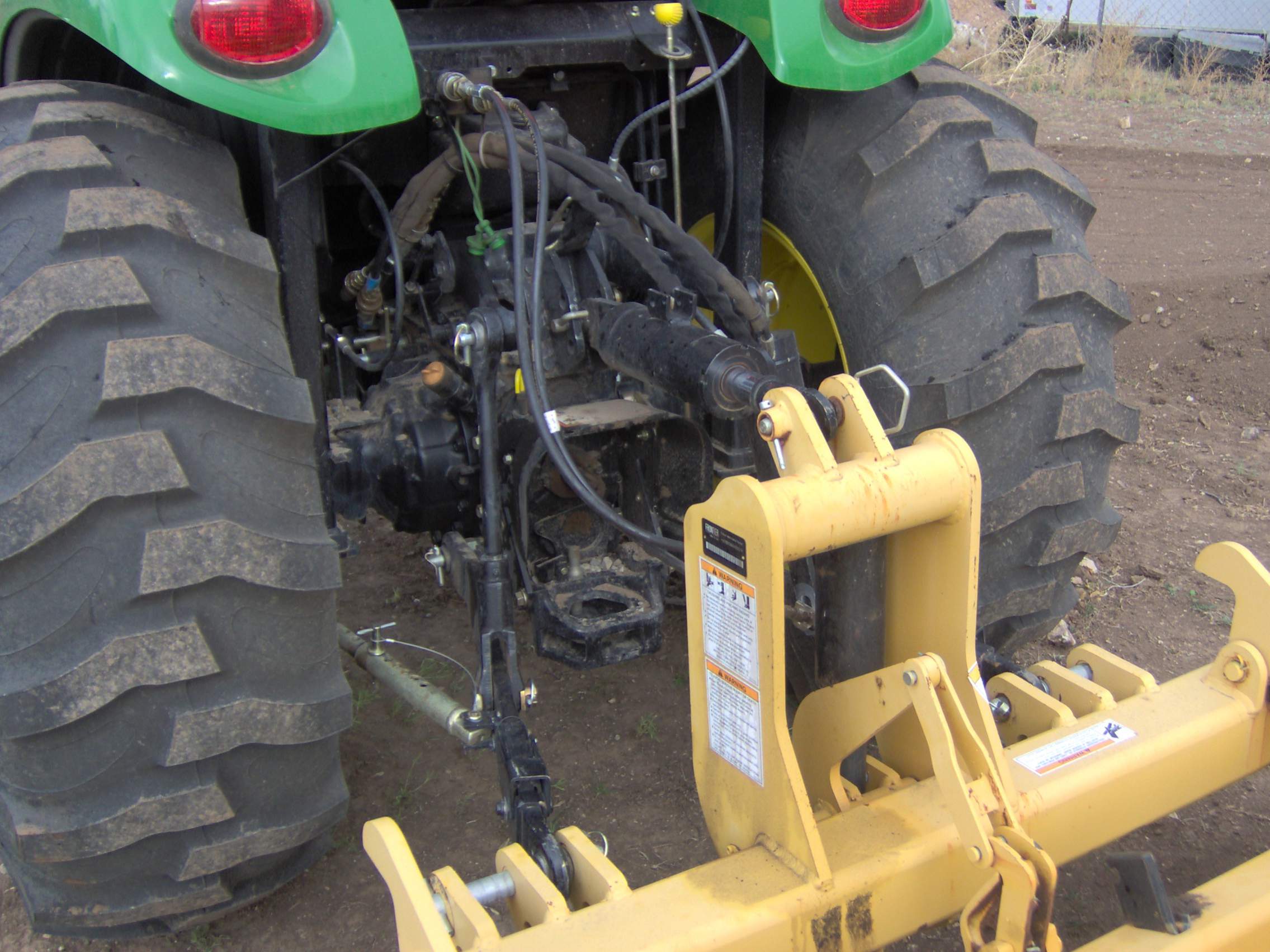

I do alot of close quarters work in my business and use a 110tlb, 4520 without fel and the small x749. For compacting I use a Bomag plate compactor and a Case vibratory roller. I wouldn't think any of the tractors or dozers will provide enough compaction to build a slab on.
For initial grading I use the 4520 with boxblade and landplane where I have enough space and use the small x749 to help with the tight spots. This small unit really helps reduce labor costs imo. The 110tlb has a topntilt hitch too so I can use it for the boxblade and landplane too but prefer to keep the backhoe on it most of the time. I do landscape grading most of the time but here are pictures of the shop pad I built up last year and my set up for this type work. I should add that I built this pad up in four inch lifts compacting between layers.

Looks like your 4520 has way too much air in the rear tires. From the photos it looks like only about middle half of your tire tread is hitting the ground. Reduce the pressure till you have full tred contact and you can do lots more work especially with all that amount of wheel weight.
